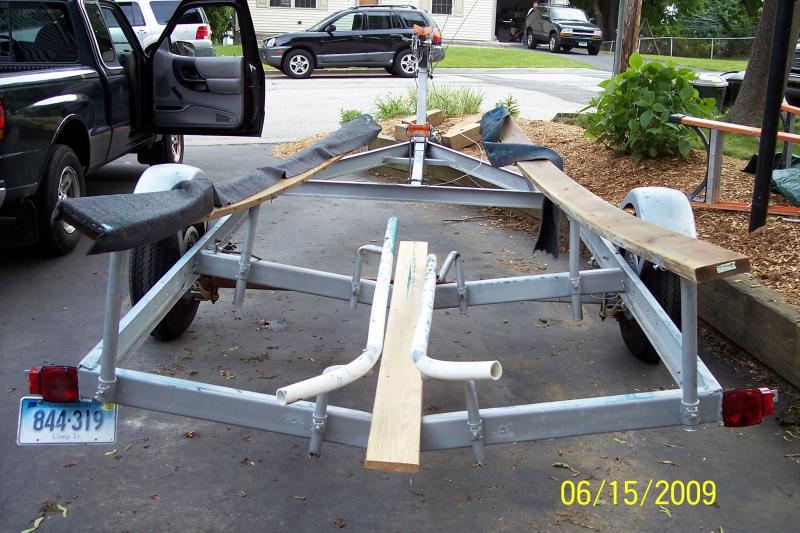

Charlie, I bought the bullet! I installed it yesterday... that was really, really hard... if I didn't do it at work, I'm not sure I would have been able too, I had to get a fork lift to pick up the back of the boat to be able to get the new board in there... took me and another guy about 3 hours of work to get it in....

Congratulations ! It must be great to have access to special equipment ! One less thing to be worrying/thinking about, huh ? I changed mine out on the trailer...by myself. The kids and grandkids were not available to help at the time and the admiral was unable to help...getting on in age (like me..).

How? we took both support beams out and still could not get the centerboard into the slot... the axel was in the way? do you have a dual axel or single axel trailer? and yes as far as the bite the bullet, I was just being funny, but that makes sense, never knew where that phase came from... as painful as spending that money was, it was much better than building my own. we actually took it out this weekend and now it is at the marina waiting on us to come back, the next weekend we have an opportunity... first day good wind and the admiral, wants to ride on my sisters power boat... yesterday No wind!... sad day for me!

Take a look at the attached pix and read the following posts at:
Need Rudder and swing keel dimensions (
1 2 3 ... Last Page)
SeaTR on 01.24.09
...in this forum, post numbers 22 & 23...there MAY be more in the thread, but those were the quickest to find. I need ~32" between the bottom of the hull and ground to drop /pivot/ remove my swing keel. My trailer, as you can see, is a single axle (original Magic Tilt with 'extendo-tongue')
Hope this helps !
