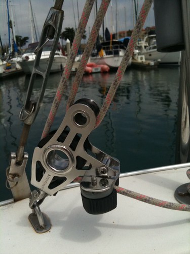

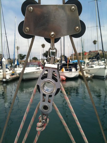

To be honest, I haven't given it much thought because I'm fairly new to "big" boats. All my sailing has been in smaller boats until recently so an adjustable backstay is a new thing to me. I have ordered some Garhauer blocks that are much beefier and hopefully I will be playing around with the backstay more now as it will be fresh in my mind. I've messed with it a bit tightening when close hauled but really haven't made it a part of my sailing routine but I think I will now. The new hardware will be the nicest and shiniest part of my boat. Hopefully I won't be looking backwards the whole time while sailing. Thanks for the input. Maybe I'll put a photo up of the new hardware by next week.

I just wanted to show a pic of the new hardware in case anyone could learn from it and this post. I could have used the sheave on the adjuster but I didn't really get that until putting it together. None the less, I used the system today and it does work great.
