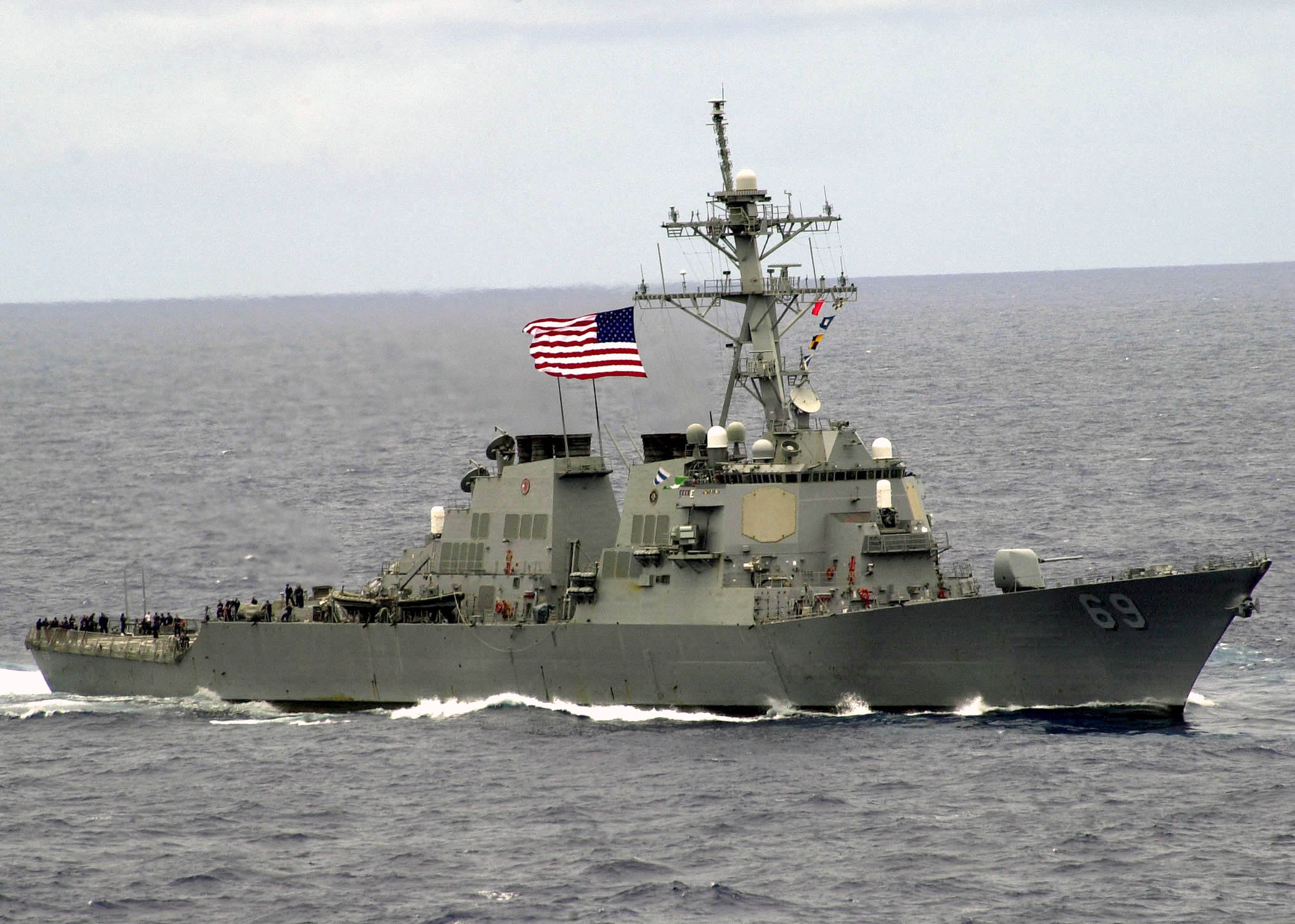

Thanks for the tip about the solid state radar actually having moving parts... When I read about the technology a few years ago I basically assumed it would function the way I was familiar with phased array panels on my old ship. For those that aren't familiar the pic below is my old Ship DDG 69, the large panel just below the bridge windows is one of the 4 fixed array panels. They pulse in sequence, computer controlled, based on desired range, power, and atmospheric conditions. Maybe someday small vessel arrays will be arranged like this inside of small domes and actually have no moving parts, or even actually start using small fixed panels facing 4 directions. In terms of power, I imagine that at the moment is actually less power consumption to have a rotating array rather pulse on/off in sequence. Who knows, maybe this is the next eventual step after the current solid state form factor.

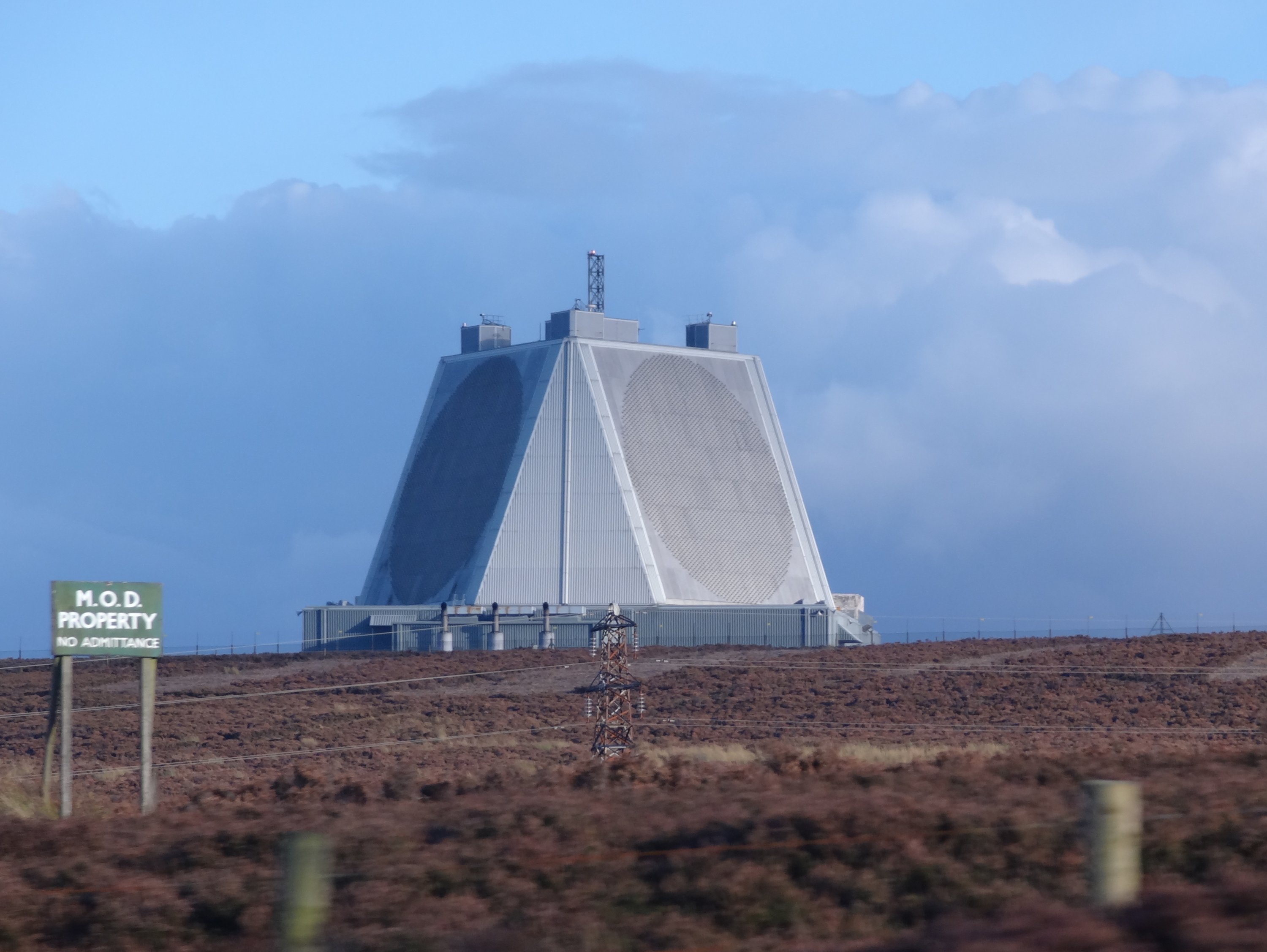

Cloud Driver, your SPY1 is a small version of this RAF AN/FPS126. If you could ever get inside a phased array radar, (i have) you will find hundreds of radar horns (the bit the energy comes out from) .Theses horns are electronically steered with no moving parts, a very complicated system requiring a very large surface area that is certainly not available on a sail boat.
