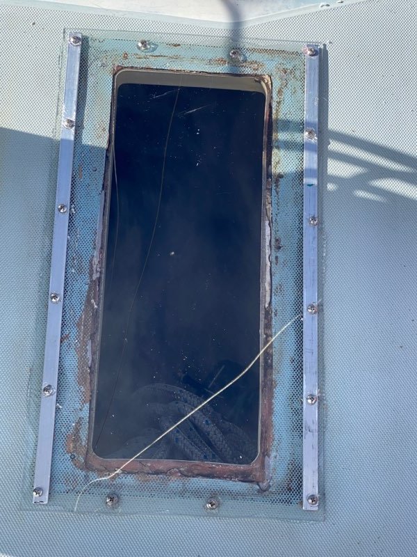

Sometimes we do temporary fixes till we can do a permanent repair.
I’m in the middle of one today. The dorade box was identified as the last possible source of a water leak into the head. Nice day yesterday. I removed it and it is most likely the source of the problem. Little or no caulking. Rusting stainless screws. Cracked acrylic. Previous owner had fixed it. Not.
So I’m installing a quick patch in the last bit of warm non rainy weather that ends tonight. I’ll take the dorade home and clean it up. Then come back to the issue in spring.
Likes: SV Gutsy Lady
24,740
As an example, here is the fix I fashioned today to address the big hole left when I removed the leaking dorade. It was clear I was not going to get the dorade serviced and back on the boat in a single day. So I will take the unit home and work on it. When finished, I can remove the patch and start again. It is the nature of old boat's. On the positive side, if the patch does not leak during the incoming storm, I will not be in a rush to fix the dorade and have the time to get it done the correct way. Secondly, should I get a chance to take the boat out for a sail, the patch should be fine.

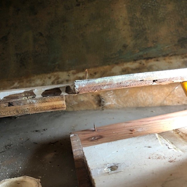

It's maybe hard to see in this photo. I have the plywood pried up and I'm peeking in. You can see the hull (looks gross because I ripped the nasty carpet off and will clean up and paint), the plywood, the strip of fiberglass in the back, and the top of the water tank. It's hard to pry the board up any more because it is glassed to the tank.
Posting the photo, but I'll most likely leave it as I said before.
