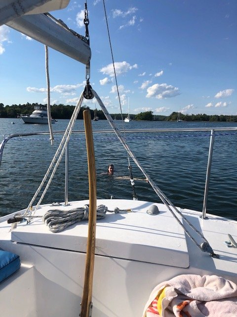

My B24 is setup with the main sheet tackle and cleat on the starboard side and goes up to the boom and back down on to tackle on the port side, see attached photo. The cleat and block are on a swivel on the starboard side and there is a block on the port side. It creates a triangle that makes it hard to open and access the outboard motor hatch, especially when it is under tension. It also makes it so the main sheet is always controlled from the starboard side, even if I am on the port side on a port tack. The cleat and tackle don't work as well when I am on the port side on a port tack.
I am thinking, a traveler would centralize the main sheet control and allow the outboard well hatch to open and close with ease as well as offer more boom and sail control options.

First you will need to decide where to locate the traveler. It seems the hatch is in the way. You have an advantage that the mainsheet is end of boom. The forces to control the boom are less and the boom can easily handle the connection of the mainsheet. Your present set up gives you a 3-1 power. I suspect that is adequate.
Moving the system "to where" is the key. What do you have in mind?

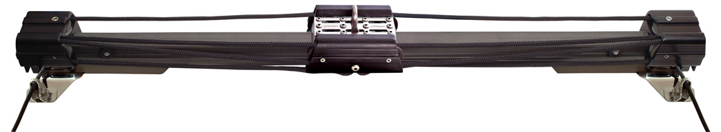

I am guessing you might be able to put a bridge traveler on the seats in front of the stern hatch. Not sure if that would conflict with the tiller. You would have to experiment. Garhauer Marine makes some travelers that are designed to bridge a gap - like from seat to seat. The seats give you a solid location to locate the bases and the backing plates to handle the stresses. I would contact them and describe your needs.
Harken would be my other suggestion.
You might find a resource right here at the SBO Shop.
