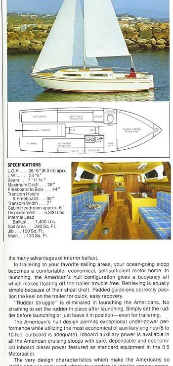

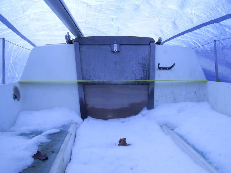

Kenn, Don't have an answer to that question yet. So far I have not been able to get in to the interior of the boat, because of the ice and the cold weather. It is just this weekend that we are having serious warming and melting. I will go over tomorrow and try and seriously get into the boat. I know that there are quarter berths that go back under the seats of the cockpit.
Hi Tom,
(Nice layout! Also, red hulls are hawt.:))
Yeah, like ours, I expect you could cut a small access hole from one of the rear quarter-berths to peek under the cockpit floor. On ours I cut a rectangular hole about 3.5" high x 10" wide, and it was enough to pick out most of the wet foam blocks, using a stick and a coathanger.
On Sandpipers, a few of us have tackled the cockpit repair in a number of different ways:
I had some rotten bulkheads to replace, so I ripped those out and worked from inside the lazarette. There was enough access to allow me to put another layer of glass cloth+epoxy under the cockpit floor, then I wrapped a plywood stiffener in cloth and epoxy and glassed that on as support. I put in all new flotation foam (styrofoam SM blue), and glassed on a new epoxy+glass-wrapped plywood bulkhead. I defy it to leak now!:evil:
One guy decided to just redo a new cockpit floor from the top.

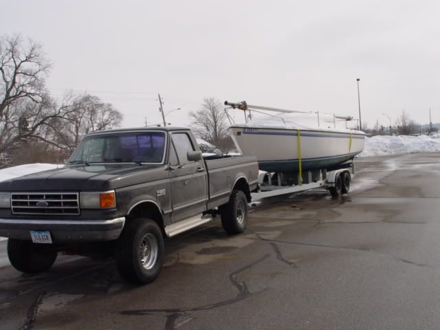

Rub marks from straps
Did you get some rub marks from the tie down straps? I am still trying to find a way to avoid them when towing my O'Day 25. I have tried the large swim noddles on the strap but it does not work very well. I did run 4X4 across the cockpit that held the straps off the boat but it puts me over the legal limit for the width of a vehicle.
I just use strips of carpet and have no problems
