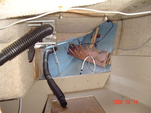

Years ago I built this peg board to hang my lines inside my lazarette. I did a real Mickey Mouse job of attaching this board in there and I'd be ashamed to show it to anyone. I should have built some sort of a base for this board and epoxied it right in there. This is where that Six-10 would come in. If you open the lazarette hatch, you can't really see it but I know it's hacky and that really bothers me. I think I'll correct that this spring.
