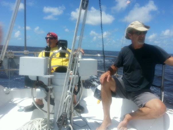

Dave, I'll call tomorrow. As can be seen from the photo that was taken just yesterday actually, (That's me on the right, and me mate "Shag" at the helm), the rail on the pedestal is functionally useless. It won't slide but about 18" athwartships, and a small child in the floor to operate it. Not the least of which it's not blocked, and would take a gorilla to pull it to wind.
Evidently the PO wasn't into performance much.
