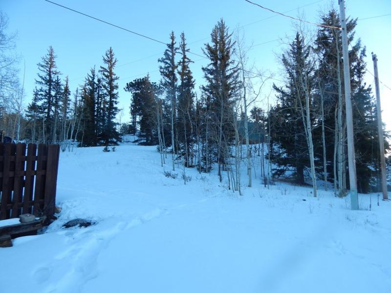

tough problem to have.. that looks like a great area.
I used to trailer my 26S for about 1/2 mile to the launch ramp with the mast bolted on at the bottom but laying in the crutch and had to go under the telephone wire shown in the picture. I did a rough measurement on the wire yesterday.. about 14.5 foot. I think I may have had a foot or so clearance.
Since my boat was on a trailer for my "data point" above, it would be lower if on the water and you can always lower the crutch.
I think you might be right on the edge for a 13 foot clearance..
