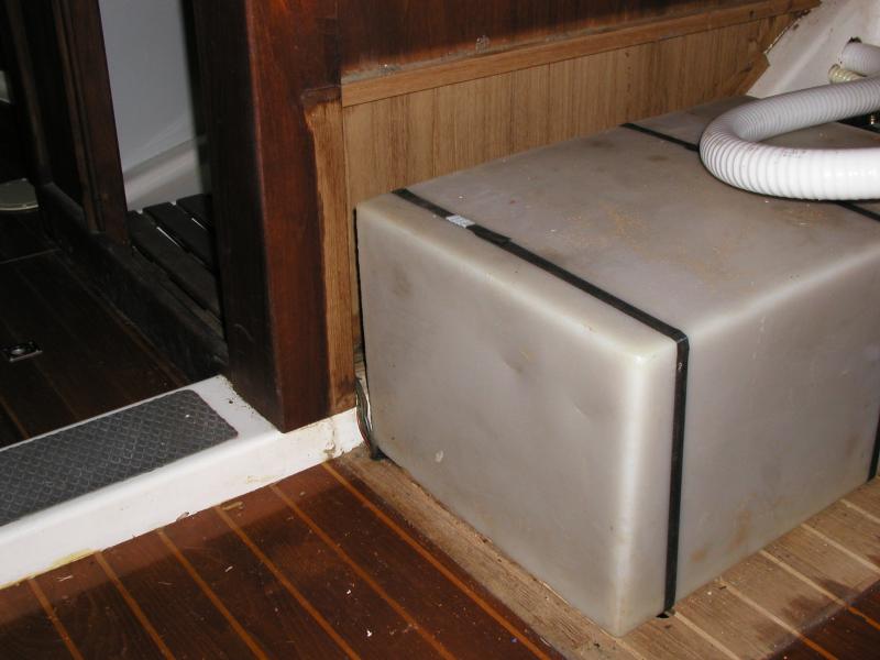

Sole.. very light sanding to avoid going through the vineer .. The PO had already done mine and finished in polyurethane varnish.. that was about 25 years ago. It is now needing a scuffing and more poly varnish today. downside of the varnish is that it is slick when wet. In picture, you can see the original floor by the holding tank and the varnished one where the floor is normally exposed. This was taken with the setee removed ..

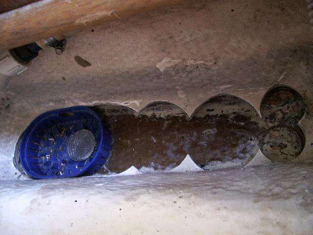

Also, check the sump (bilge) area and see if the pan liner is still on the bottom. That is not the bottom of the boat and water will remain under there to fester and stink later. Many owners have cut that skin out exposing the inside surface of the hull and can subsequently be kept completely dry. Also consider a dripless shaft coupling.

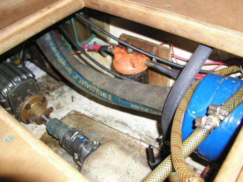

Ed, here is what the engine water intake on mine looks like after the PO converted.. The thru-hull is a Marlon one and as you can see, there is no more ell in the line. That is the Marlon valve under the braid reinforced hose .. There is another just like it on the other side (port side) of the shaft log that feeds the seawater foot pump for the sink and the inlet water for the air conditioner pump. I can't read the number on the black hose to see if it is 3/4 or 5/8.. Dunno..

Hi Claude,
Wow, that one is even farther back than mine. Mine is on the port side in front of the shaft log so I can just reach it with a long stretch over the engine.

Interesting, Dan.. Looks like my PO installed another thru hull opposite the original engine water intake. Then used the new one for the engine water and used the original for the sink foot pump..
