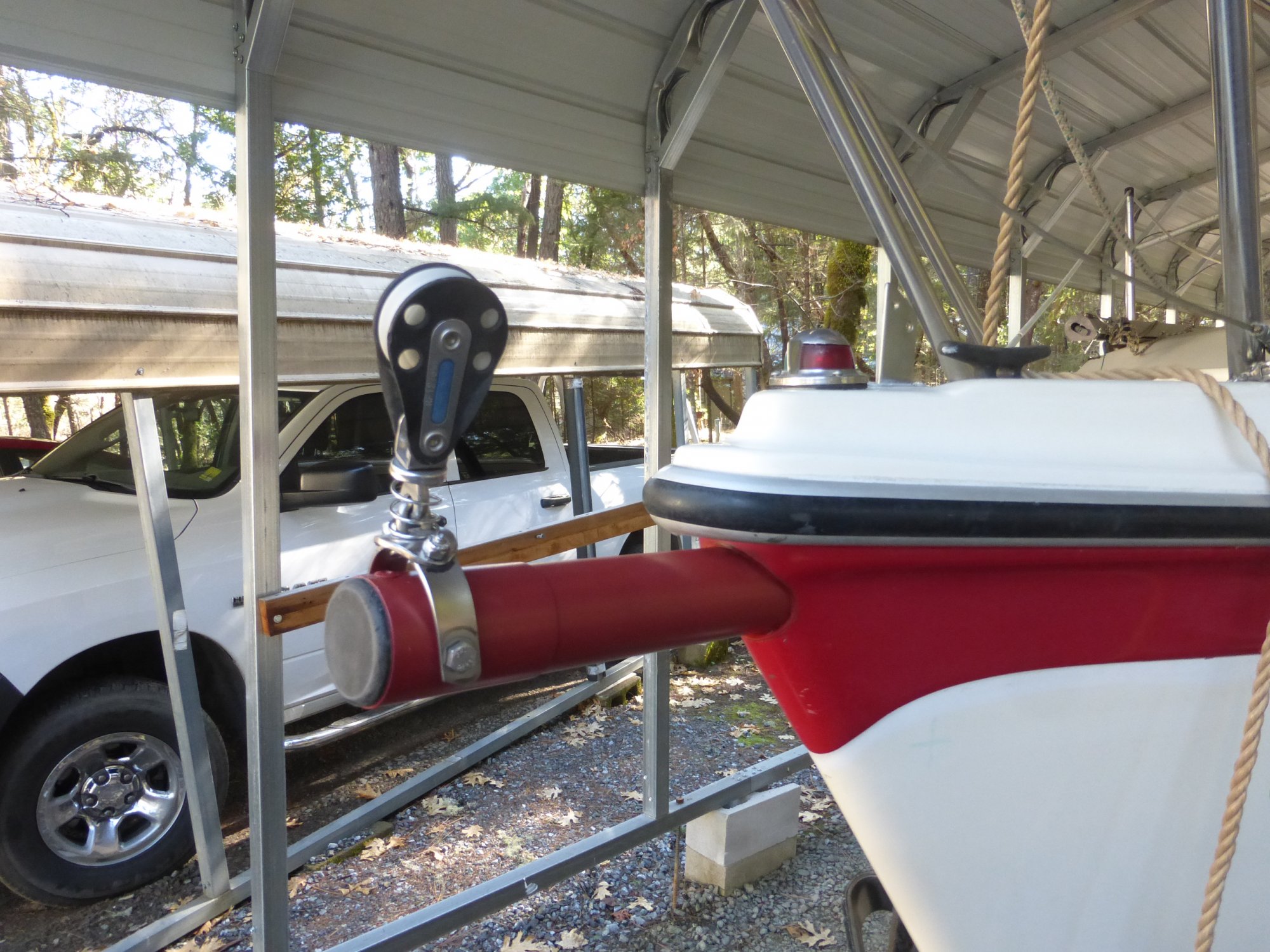

I fabricated my setup in 2018 (Mac 25') and it's worked out great for me. I didn't need much length to get out far enough to clear the bow rails so mine is fixed but set up very similar to your design idea. asymmetrical and deploys out of a bag on the deck single handed very easily. it's not rocket science as long as you have basic skills. don't overthink it. just grab a hole saw and go for it :cool:
