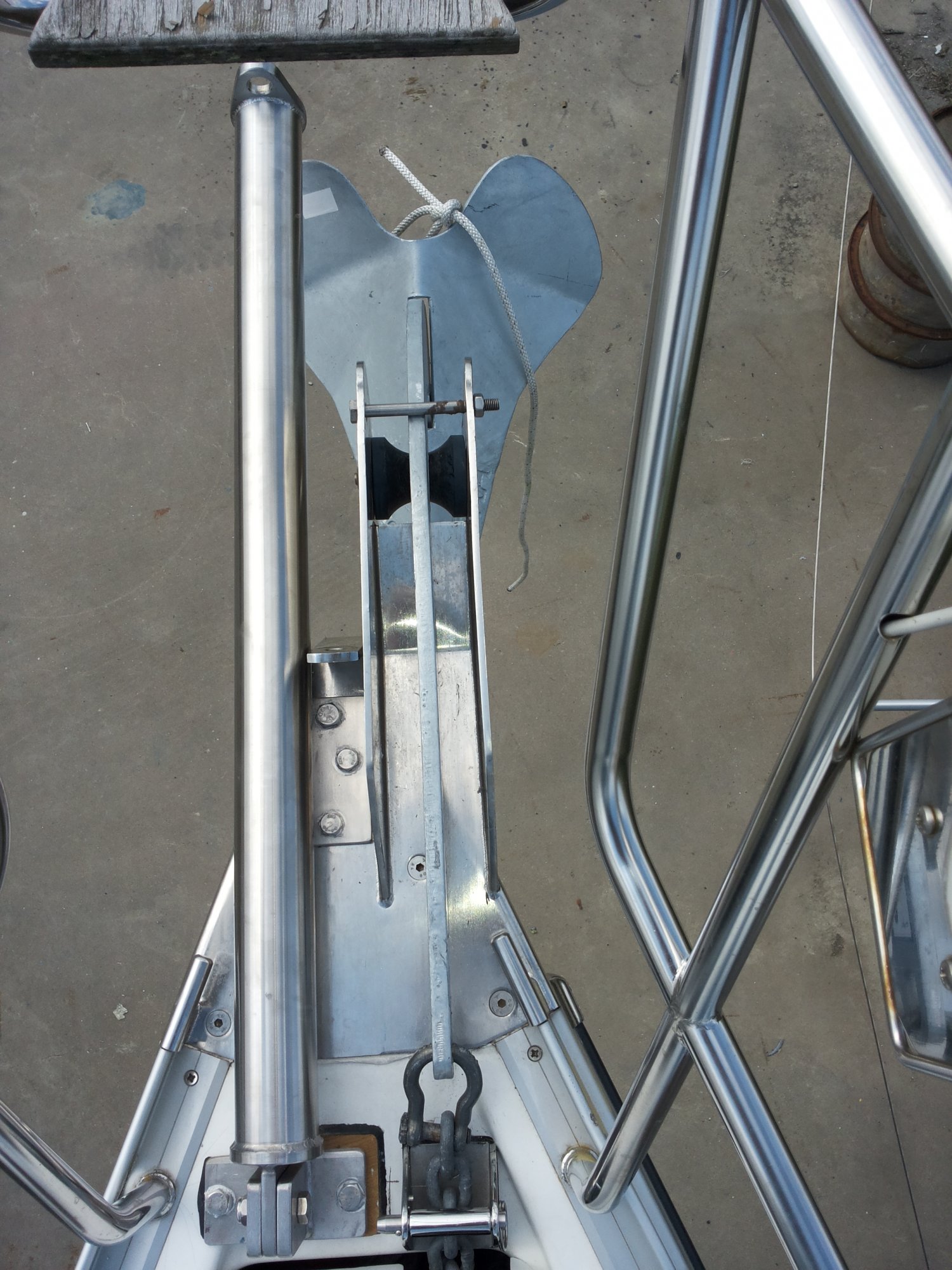

Dear sailor,
I made the measurements and drawings for a bowsprit on my OC361 myself. The bowsprit itself is made up of a stainless steel tube, assembled by a stainless steel parts manifacturer and then I mounted the bowsprit myself on my ship. If you are interested, I can send you the drawings - these are accurate to scale.
Guus, Netherlands.
