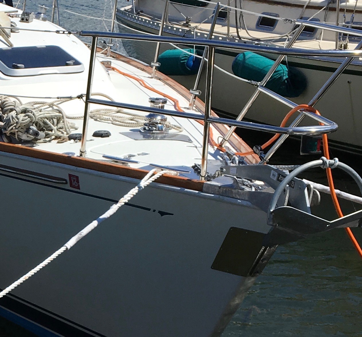

Photo of your bow setup would be helpful. I can’t cross my bowlines because the anchor windlass is in the middle.

Depends on the location of the chocks and the cleats. On most Sabre models the chocks are very close, inches, from the bow. This can lead to a sharp turn at the chock and puts undue pressure on the bow chock. It also stresses the line as it makes the sharp turn. Crossing allows for a fairer lead out of the chock which over all is a better idea.
After blowing through a bunch of irreplaceable chocks, I no longer use them and lead the lines at a fair angle over the toe rail which is protected by a SS chafing stip.
And, we could all give a better answer if we had photos. :biggrin:
