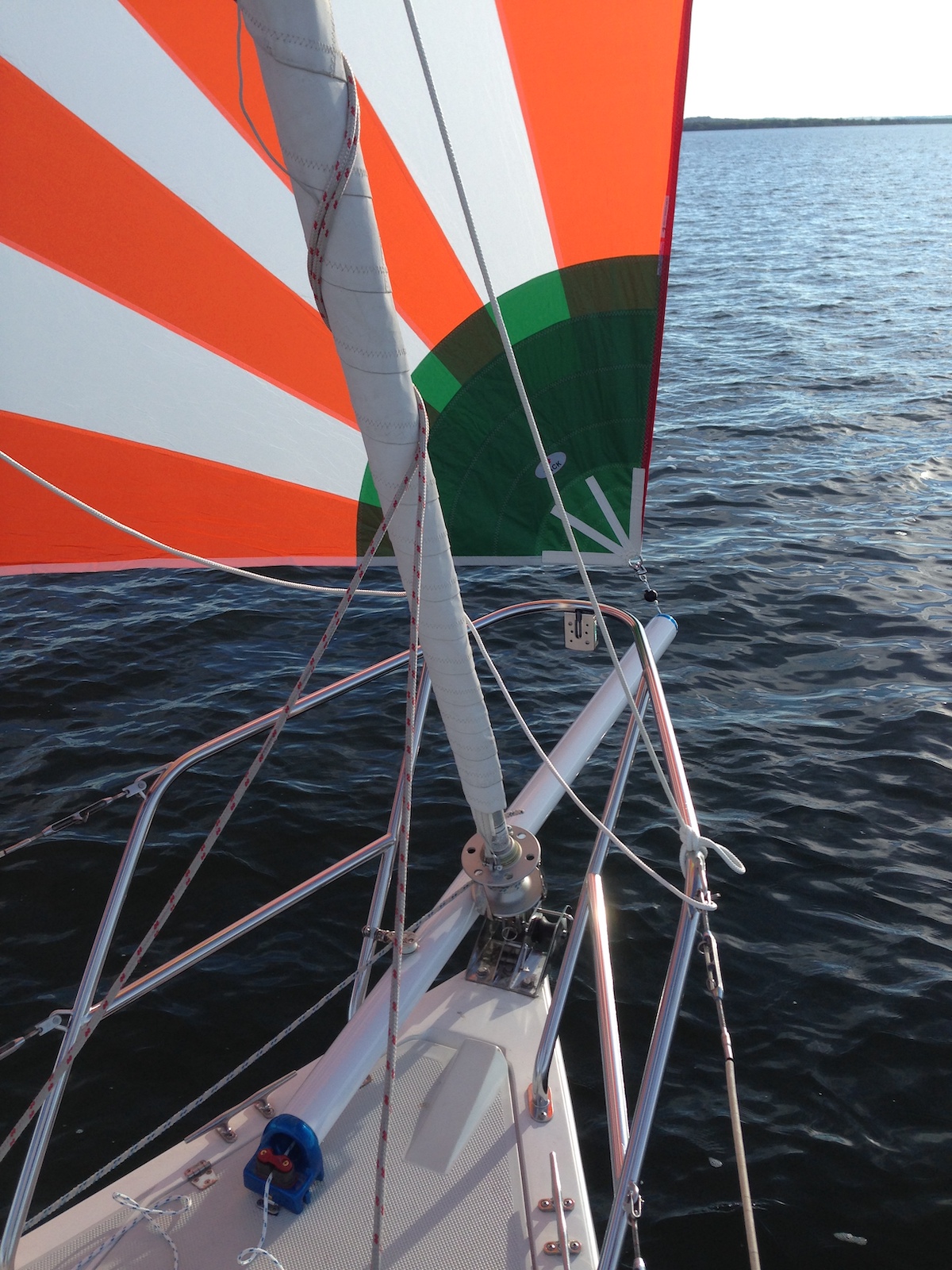

I’ve had a bowsprit on my 340 for several years. It gets a lot of hard use when we’re racing, never installed a bob stay. It’s right at three feet past the anchor roller.
"No Drill" Bowsprit
Lots of video on the boat’s YouTube channel of the bowsprit in use.

The Selden offering does not require a stay, and in fact, that may just get in the way. I heard a lot of doom and gloom about using the anchor hatch as a rear attachment point - how the pole work rip the hatch off and a great gaping hole would open up the lake and we'd all wind up in Australia. There's very little interaction at the rear of the pole, beyond general housekeeping. The vast majority of the loads and forces are, as Selden suggests, at the ring.

The force on the aft end of the pole is down, not up. If the anchor hatch is weak the pole might crack it and cause it to collapse, but it won't lift the hatch unless maybe you go shrimping with the chute. Now if the pole is used to secure the anchor and move the rode away from the boat, the anchor hatch might just launch itself, but not all the way to Australia.

Correct. The kite pulls the pole up and the ring acts as a fulcrum. Oddly enough, there isnt that much force on the aft end.
I have two rubber feet on the aft end, and the pole tends to sit to one or the other, when on the Wichard cleat. If you lean on the aft end, both feet will be on the deck. Ive never seen the sail push it down that hard.
Your experience might differ, but since i made this from scratch, i tend to watch it very, very closely.

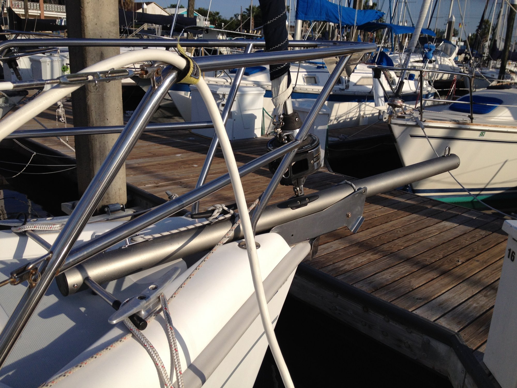

Thanks Bill I was looking thru your pics great! At the aft end of sprit that must be a custom mount, If so would love to get the material and installation instruction. What length is the sprit.

The whole thing is custom I guess. I originally made it from 2" aluminum conduit and that bent, pretty easily. I got a piece of 3" aircraft aluminum from speedymetals.com. the longest piece you could get without paying extra shipping, 5 feet. So that's how I picked that length. The cross piece is 1/2" stainless steel pipe I got out of the junk bin at work, pipe not tubing. It centers it and keeps it from getting pulled out of the boat from the front. The plastic ends I found laying in a parking lot. I double stacked two rubber bumpers under the pipe where it presses on the anchor locker lid. A line comes out of the bottom at the anchor roller and comes back to the turning block and to the cleat to hold it down. Probably way under a couple hundred bucks into it.
Only thing I don't like about, you have to remove it to use the anchor. You can see the 2013 registration sticker in the photo, so it's held up real well.
