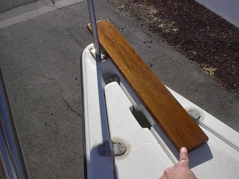

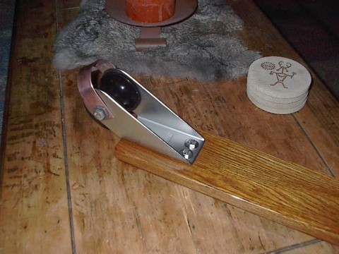

im making a plank w/ roller for my h23
probably could live a long time without a roller on this small a boat/anchor but hey.....its going to be nice. i bought an ar2 small anchor roller from west and a 1"x3-1/2"x24" oak plank from lowes. finished the plank with cetol (teak color) and 3 coats of cetol tgl clear over that. will mount the roller on the plank and plank to the right anchor locker door when the roller gets here. (hopefully mon or tue) plank will extend past the bow about 4"-6" and the roller a couple beyoud that. dimensions aren't cut in stone yet. i'll just have to look at it all when the roller gets here. i will loose the use of the right anchor locker door but the left opens up plenty wide to get the anchor and rode in and out of. i can post a pic if anyone is interested.

william
roller installed on plank
the project continues. if there isn't too much frost on the deck tomorrow i'll get the plank mounted. 2 things i have yet to address are: 1) i need a way to belay the chain after the anchor has been brought in....just till i can stow things. anyone know what that handy little anchor chain cleat thing is called? that "fork" that you drop the chain into and it holds it. 2) the angle to the anchor locker cleat might not be optimum. (no "might" not actually. it is NOT optimum, but probably acceptable for a boat that will never be anchored in a hurricane).
