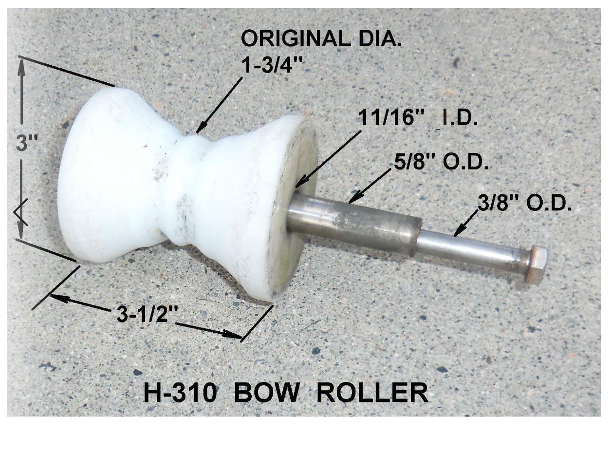

Not an easy task. The original roller had no identification on it so :
On to the net and every marine store going until I came to one that was close to the original dimensions. I'd suggest starting with the Sailboat Owners Store here.
