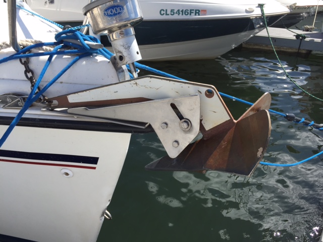

Hunter 26 Lake Pueblo Colorado
Attached are some Pics of what we built for our h26. We anchor out just ablut every weekend during summer. Enjoy Chris

Jun 9, 2014
22
hunter 27 Palm beach
No Diana, it's very strong 3/4 inch thick starboard with a dolphin striker bolted to it. it puts the anchor a couple feet out front so not much chance of the anchor banging against the hull.
Jun 27, 2017
5
Hunter H26 Olympia
What did you use to attached the roller to the lip? It looks like a separate piece of steel.

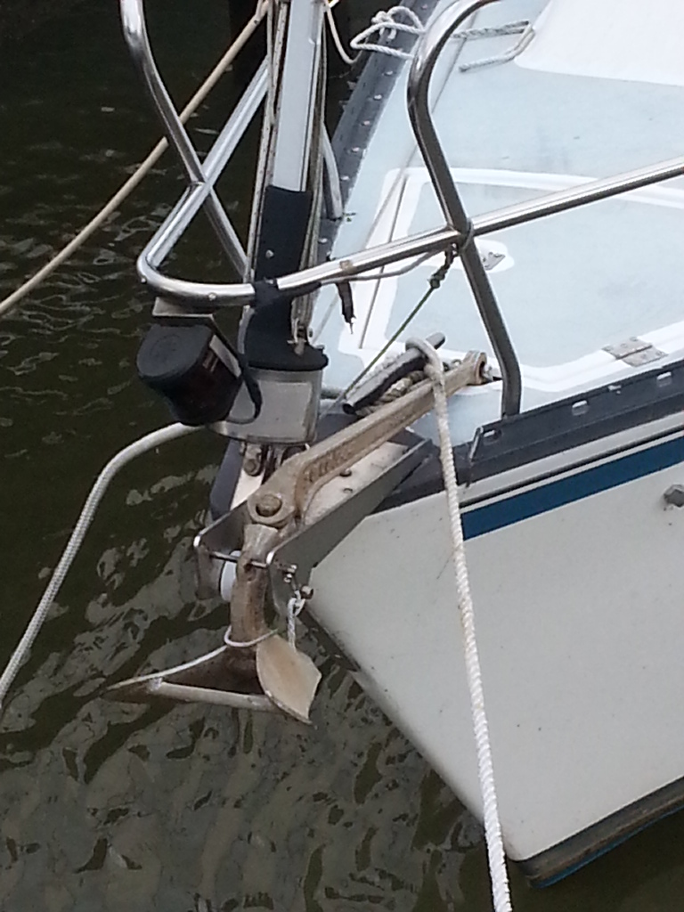

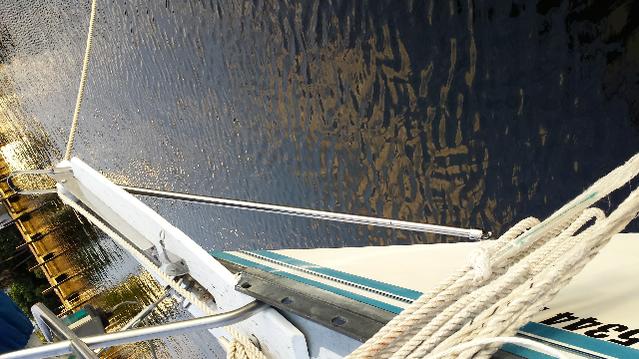

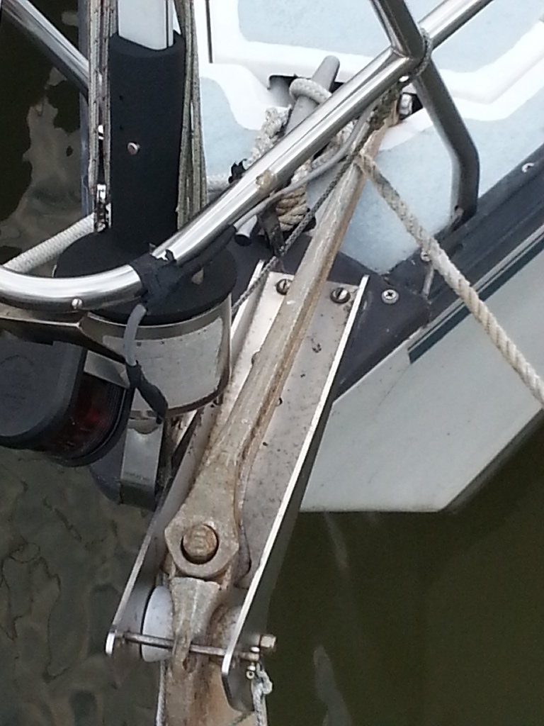

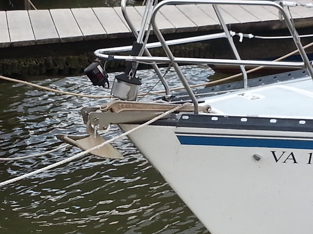

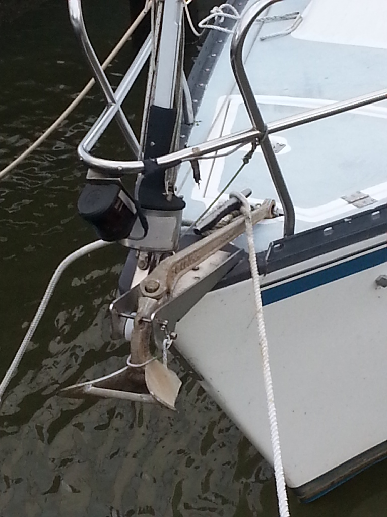

Jan 24, 2009
451

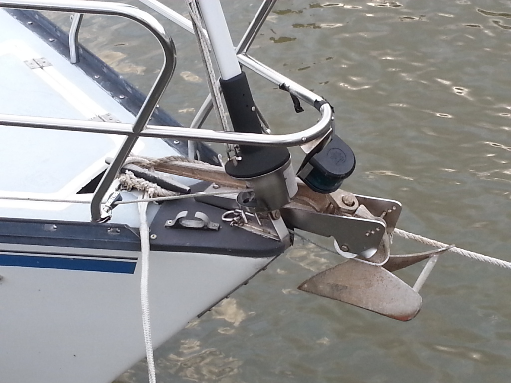

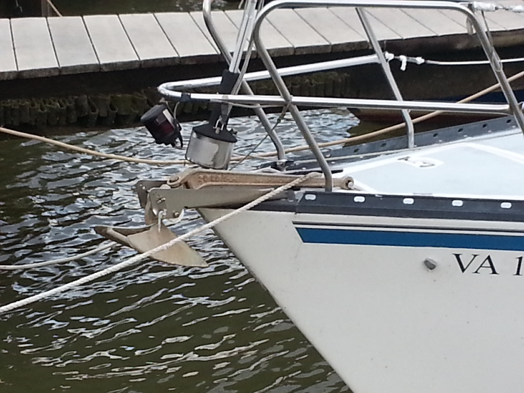

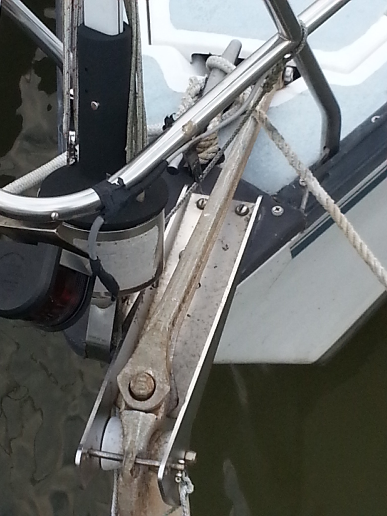

1981 Cherubini Hunter 27 Shipwright Harbor Marina, MD
OldTownH27 (1).jpg OldTownH27 (4).jpg OldTownH27 (7).jpg OldTownH27 (8).jpg Here are some that I took as reference for when I do mine. I think the roller is commercially available and I would assume it's bolted through underneath with either a plate or large fender washers (the owner wasn't there to ask). It's a squeeze to fit up under there, but doable.
