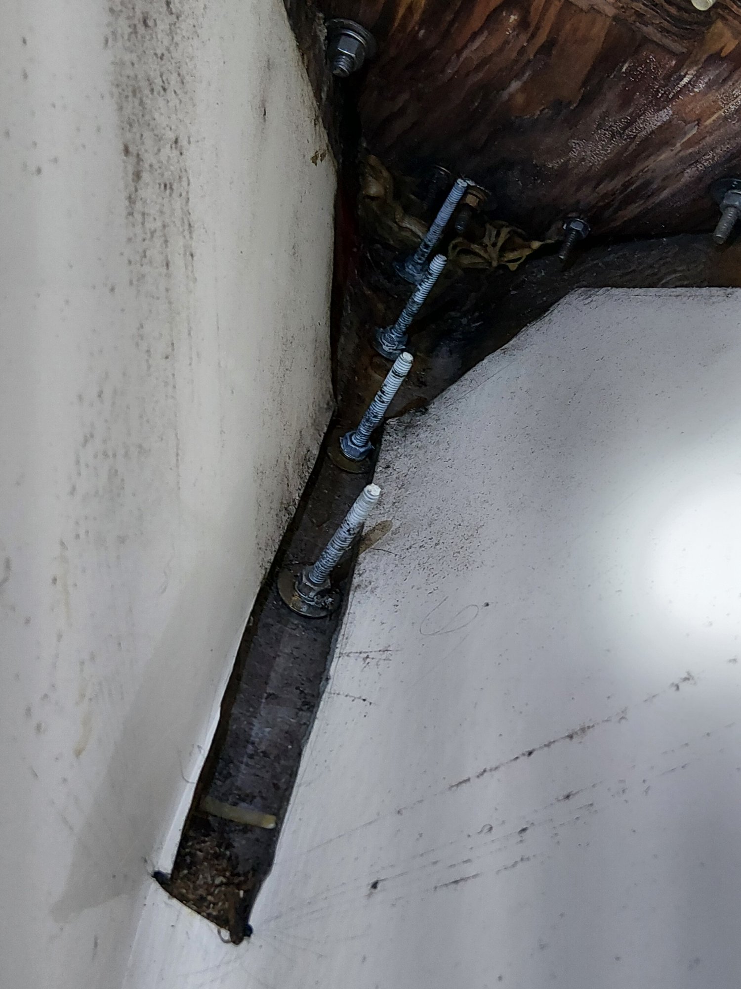

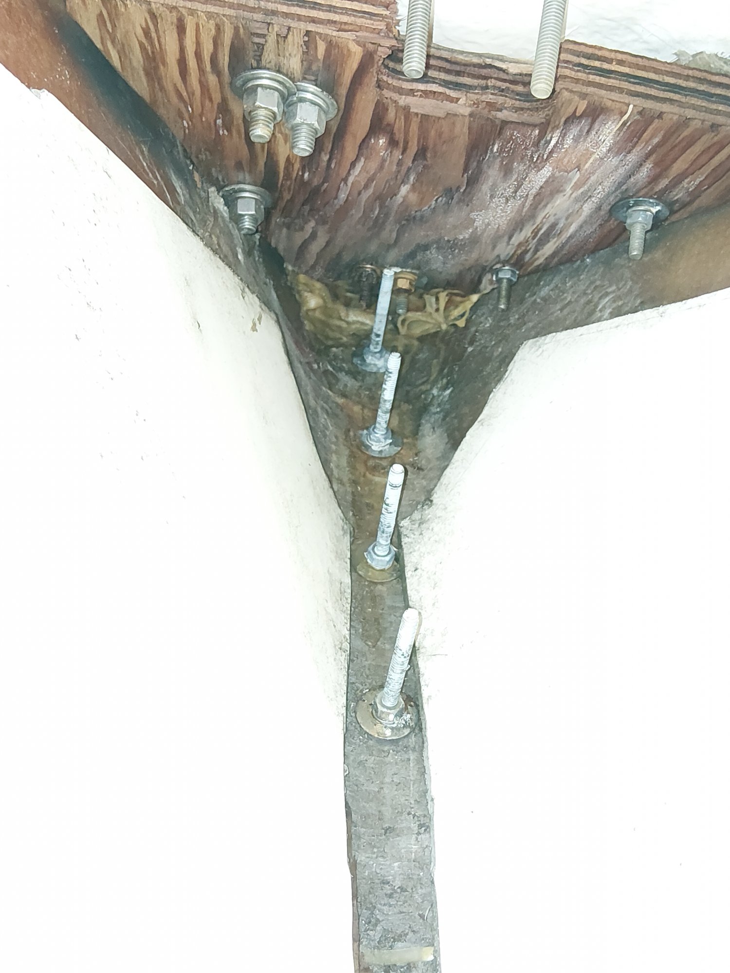

I've a 1984 Hunter 27 (pre-owned) and in preparation for a bit of fore-deck repair, I took a look "underneath" the fore-deck.
The bow-protection strip is held in place with four long bolts (with associated washers & nuts); there is NO backing plate between the washers and fiber-glass.
My question:
Does anyone know if this was Hunters standard approach to affixing a bow-protection strip (or am I missing a backing plate)?
I've attached pictures to assist in clarification (they're the best quality I could get at this time).
