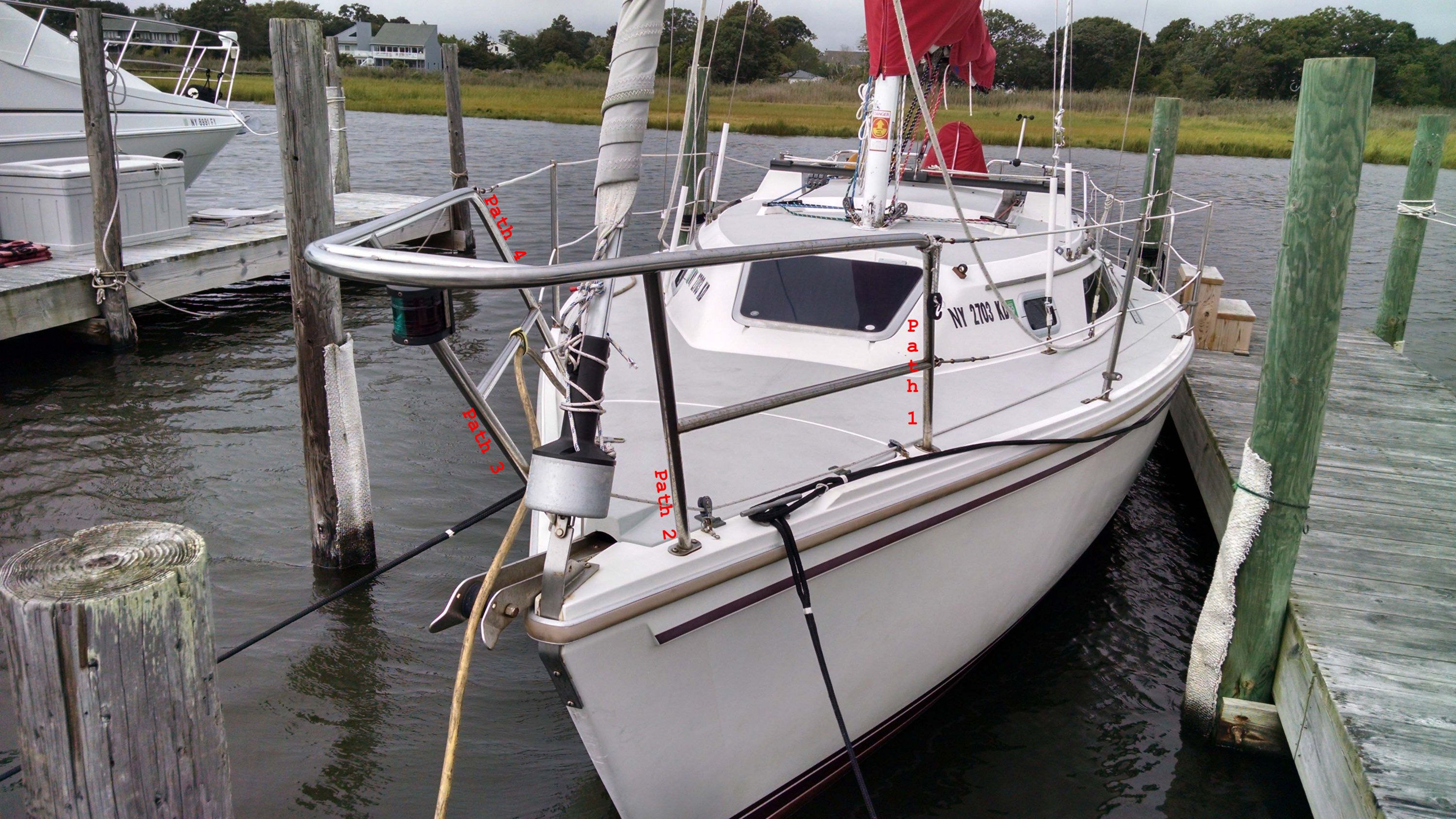

Finding the break is the hard part. I know the bow light wires enter the stanchion but after that it gets difficult.
I think the wiring path is what my picture lists as "PATH 1". After that, I believe it enters the interior of the boat.

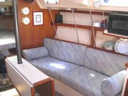

On my Capri 26 (pic 1, sister ship), which is not far removed from the 28 interior, the wiring was behind the teak trim piece running horizontal under the deck. Under the trim is a vinyl panel running the full length of the trim. You can see it under there in the pic. Remove the vinyl panel to reveal the wiring.

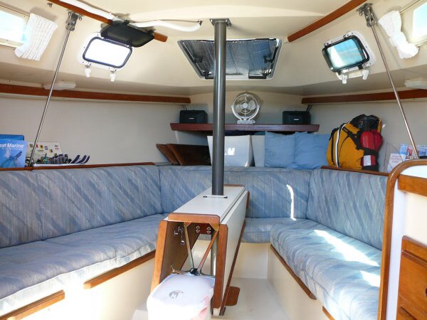

Yours might have 2 trim pieces, (pic 2) one mid-hullside and the other under the deck like the 26. Look under the top one for the removable vinyl.

Wow, the interior does look similar. The Cat 28 does have a little wall which creates a V berth room in the bow.
I did remove the teak trim at the top of the wall. I helped a little but the wiring is still tucked up higher and it seems to be kept there with a little wire clamp (not really sure since I can't see),

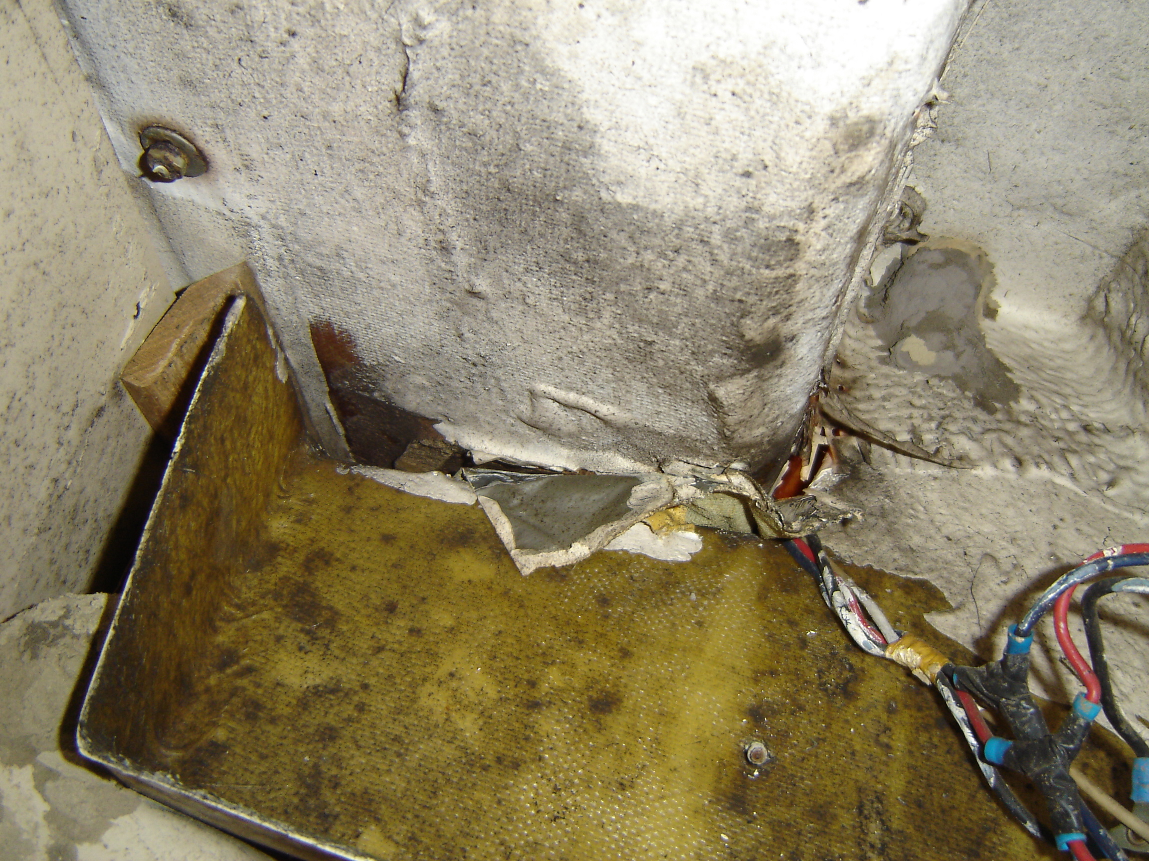

Yep and this is what one of the wire connectors junctions look like in a factory installed cat 22 junction
