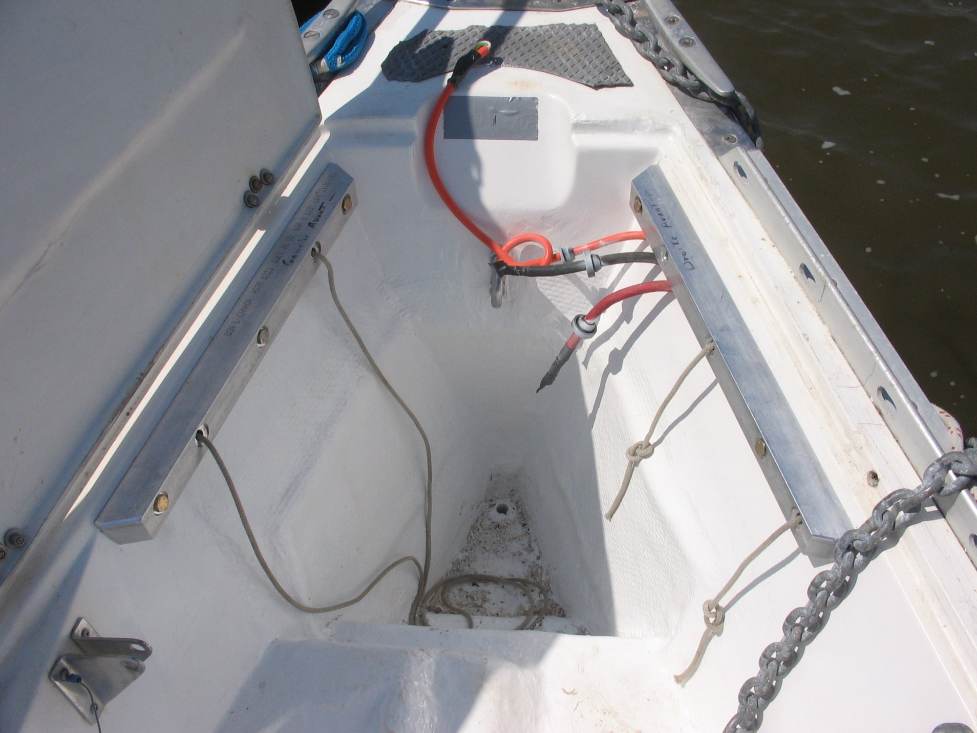

Did you check the anchor locker?

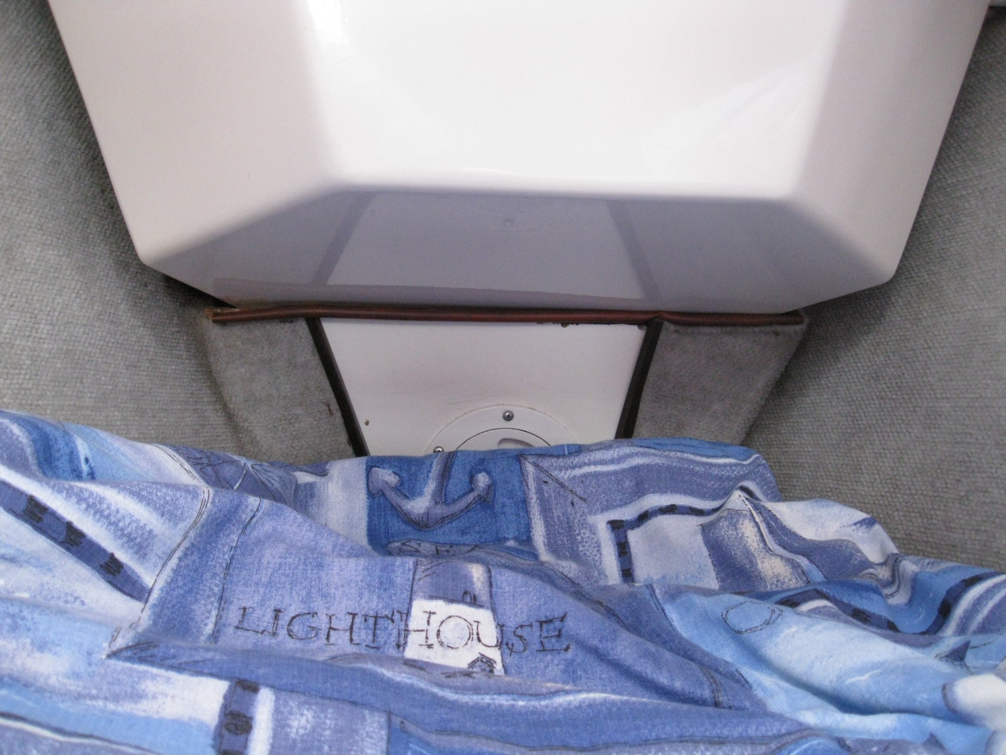

Ditto on Mikem. Check your anchor locker. If the drain got plugged up then you will have water accumulation. On the 34, the drain is in the bottom of the locker, connected to a rubber hose which goes to a through-hull. The area under the anchor locker is a dry section of the bilge, as well as the area under the V-berth. However if there is a problem with the rubber hose itself leaking, or a broken collar on that hose, then water will accumulate under the anchor locker. You need to remove the small bulkhead in the front area of the V-berth to access that section of the bilge and fix the problem if indeed it's that "

Second under the v-berth there are storage compartments that a lot of dealerships utilized to install knot meter transducers that the thru hull maybe leaking.
Third check anchor locker for excessive waigh, such as anchor chain.
There is an inspection plate in the v-berth that allows access to the anchor well hose drain, that thu hull fitting on both ends of the drain hose are common to fail from ice that cracks the connections. That rain water will then run down the hull and settle into the forward storage compartments.
