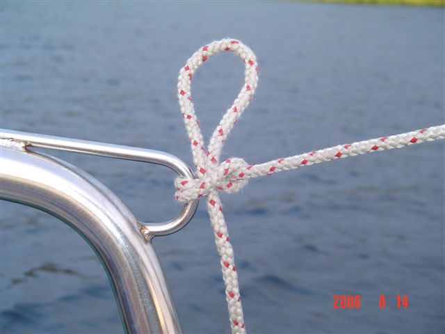

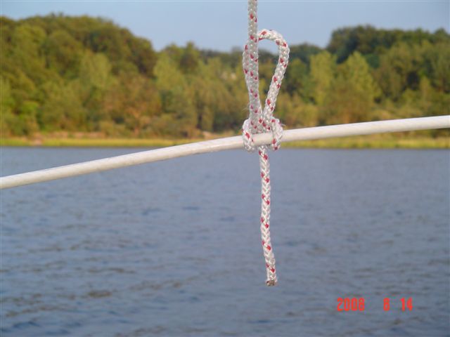

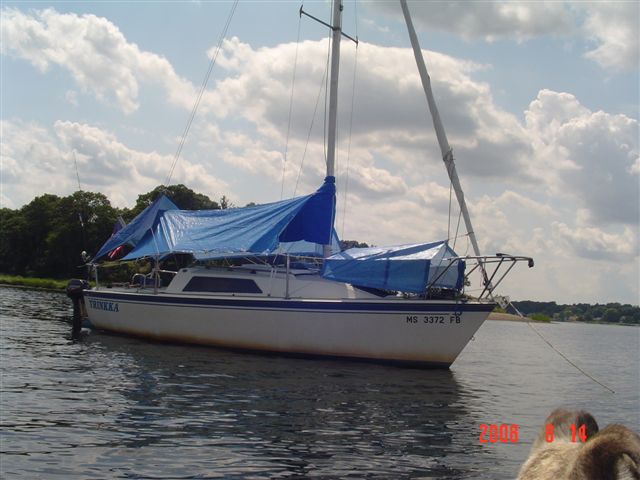

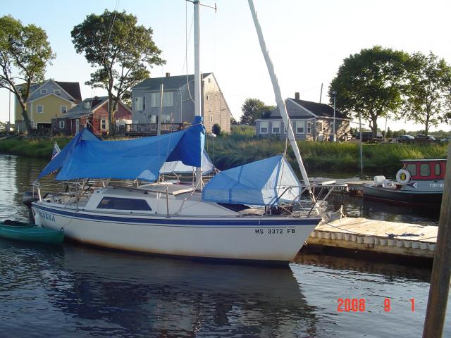

Even if you were able to cut an opening and install a hatch in the bow, it may interfere with your jib sheets when you tack. Most hatches sit in a pre molded indentation on the bow of sailboats that are designed for a forward hatch and I think that they are designed for this reason. You may be able to install some small opening ports on this boat but I don't think that you're going to get the ventilation needed for cool sleeping at night. What I would do is buy a small polytarp that will fit over your boom and tie it off somehow to act as a shelter and a wind scoop. If you anchor in a protected cove on the lake, put out enough anchor line from the bow, cleat it off, and then bring back enough of the anchor line to tie off to your stern cleat. This way, the wind will be coming directly from your stern and the boom tarp will act as a wind scoop. If the wind get too strong for this, you should let the line off the stern cleat and let the boat swing at anchor again from the bow. These are the only suggestions that I can come up with. I use tarps a lot in the hot summer. It's the only thing that makes hanging out on the hook bearable. Tie your tarps with quick hitches so that you can douse them in a hurry. I use clove slip hitches and round turn type hitches with slipped half hitches.
