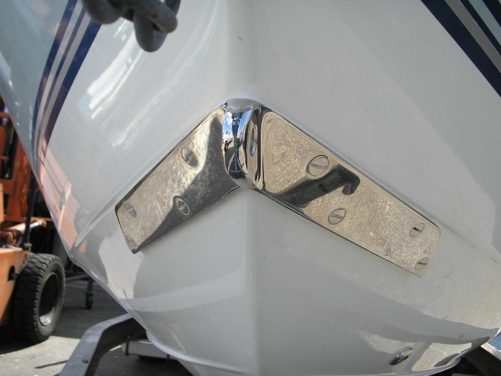

Or perhaps a Tow Eye is what is imagined...
but not sure why you want to tow a Catalina 30...

@Brian Dail take a look at the way the Tow Bow would attach. It has 4 bolts that you can place two backing plates in a strong place on your bow. This would give you a good place to attach a cable and apply a winch to pull the boat.
The typical U bolt would not be as strong.
Your Catalina is a heavy boat.
