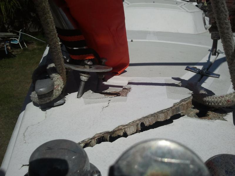

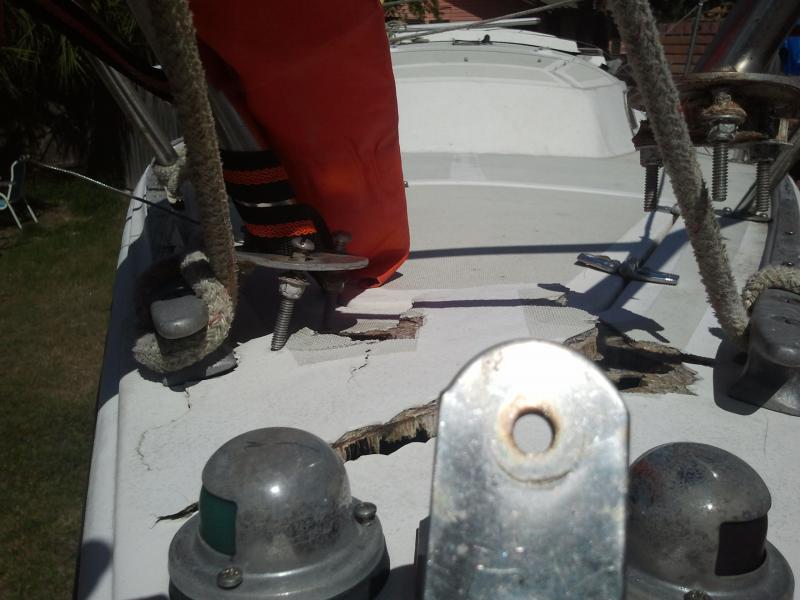

I just got my first sailboat and it is a little of a fixer upper. There are a few things that need some TLC. But the bow is the biggest issue. If anybody has seen this or has suggestions I am all ears.

Aye, caramba! That's some serious delamination and core damage right there. It'll buff right out...
From what I can see in the picture, the underside of the deck might be intact. If so, the repair would be to cut all that out of the top, lay in new coring with epoxy, and build up new glass layers on the top. I expect the repair would have to go further aft than the obvious delaminated sections, as water has likely flowed back into the core and saturated it.
If there is any other evidence of impact damage in the hull or the layer of glass underneath, more extensive repairs would be required.
It's not a trivial job to repair, but a determined person could do it themselves.

That makes sense I will give it a go. Any recommendations on what brands to use for the core, epoxy, and glass?

Thats not a delamination, thats a major structural crack cause by the bow pulpit being pushed back and upwards with huge force. You can see where the forward pulpit posts have been pulled clear after the deck cracked. Something hit that boat VERY hard.
Along with fixing the (very) damaged area, you will need to look at the hull/deck joint in that area to see if the stress damaged that as well.
West Systems epoxy will be your best friend.

I was thinking that it had to have been hit. I have inspected the hull and surrounding areas and they are untouched. It looks like the pulpit took the brunt of the collision. Thanks for the product recommendation jackdaw. I will also read through your thread 25years later. I will post pics as it comes along. Thanks
