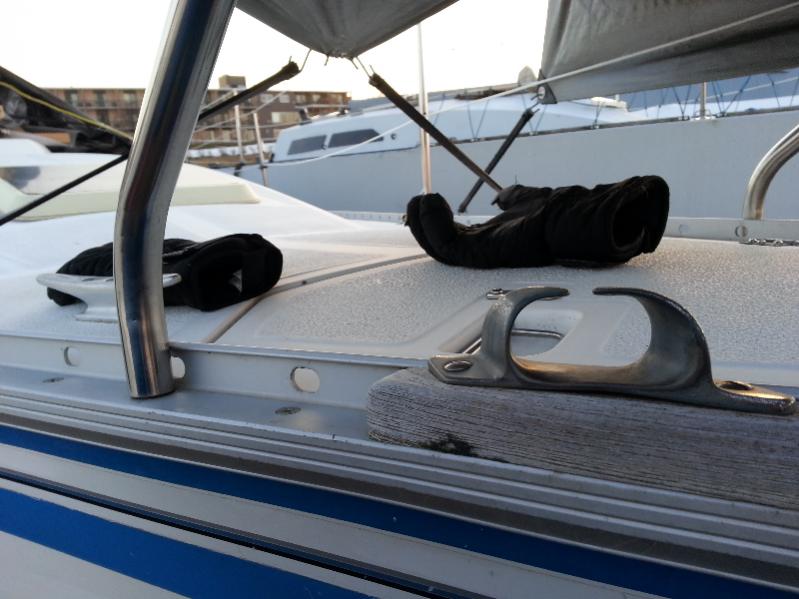

The cleats on the bow of my Hunter 28.5 are mounted to the deck about 6 inches inboard of the toe rail on either side. There are chocks on risers to help lead the lines over the toe rail.
This arrangement doesn't work well for spring lines. Has anyone moved the cleats outboard to the toe rail itself? Do you think the toe rail is strong enough to support this use even if you haven't? Are there any other downsides with doing so that I should consider?

Warren I'll have to search up some pics to see if the '86 cleats are of the same style as mine. I was thinking that I might have clearance issues (for the line between the cleat and toe rail) if I didn't also mount them on risers.

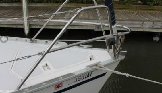

Yes, I see now that the newer models have the cleats moved to the toe rail. They must have started changing things around during the '86 model year, as the '86es on YW still have the same mounting as my '85.
I think I like the '89 the best - the '87 they just chop out the section by the cleat, whereas the '89 they cut it clean to the stem.

I think I'll add this mod (aka upgrade when it's time to list for sale) to the fall to-do list (or the lazy August no-wind day to-do list).
