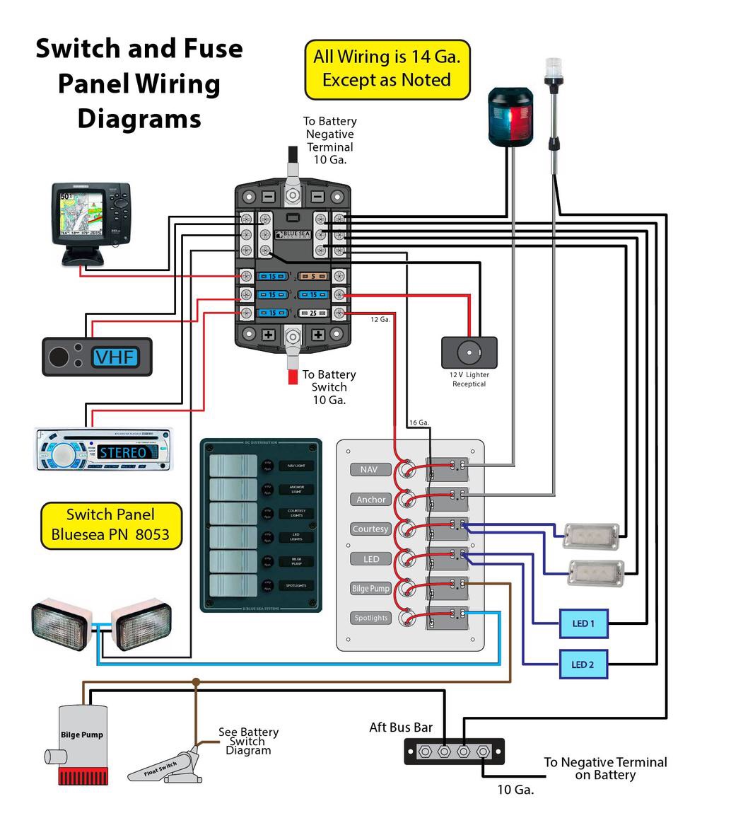

I stumbled across this diagram and electrical finally made sense to me, like a light bulb went off in my head (sorry for the bad pun lol). I think a fuse box with the positive and negative busses together is the ticket. My system I have in my head is pretty simple, bilge, nav lights, VHF, three cabin lights and maybe a wall plug with the nifty USB ports in between the plugs. Sounds like it don't much matter between breakers or fuses, it's a preference thing it seems like.

You may want to wait and check what you have first. My electrical on my O'Day was a rat nest of added wires and during the test sail sort of worked with one bow light, stern light and 2 cabin lights all on the 12v / DC side. After a weekend of messing around and cleaning out lose wires and trash under the cockpit nothing on the 12v DC side worked. This weekend with some help I managed to restore the power to the original O'day fuse / switch panel, verify all switches had power and functioned properly, restored power to all navigation lights (bow and stern) and cabin lights. The wires running to the circuits from the panel turned out to be in good shape, the issue was the bus bars that were added were hosed up. I was ready to rerun the entire boat, but instead removed all the half donkey stuff left behind and clean up the connections. I plan to add 2 bus bars, 1 positive and 1 negative, to set myself up for the rest of the electrical adds as I go.

John T, that is the current game plan, if I can salvage the old box that would be a plus for sure but the thing is need a full rewire I am sure of it. Most of the wire Ive actually handled on the boat is losing its coating. But if I can reuse that box that's a some savings for me for other things the ex owner lost, like the spreaders now.
