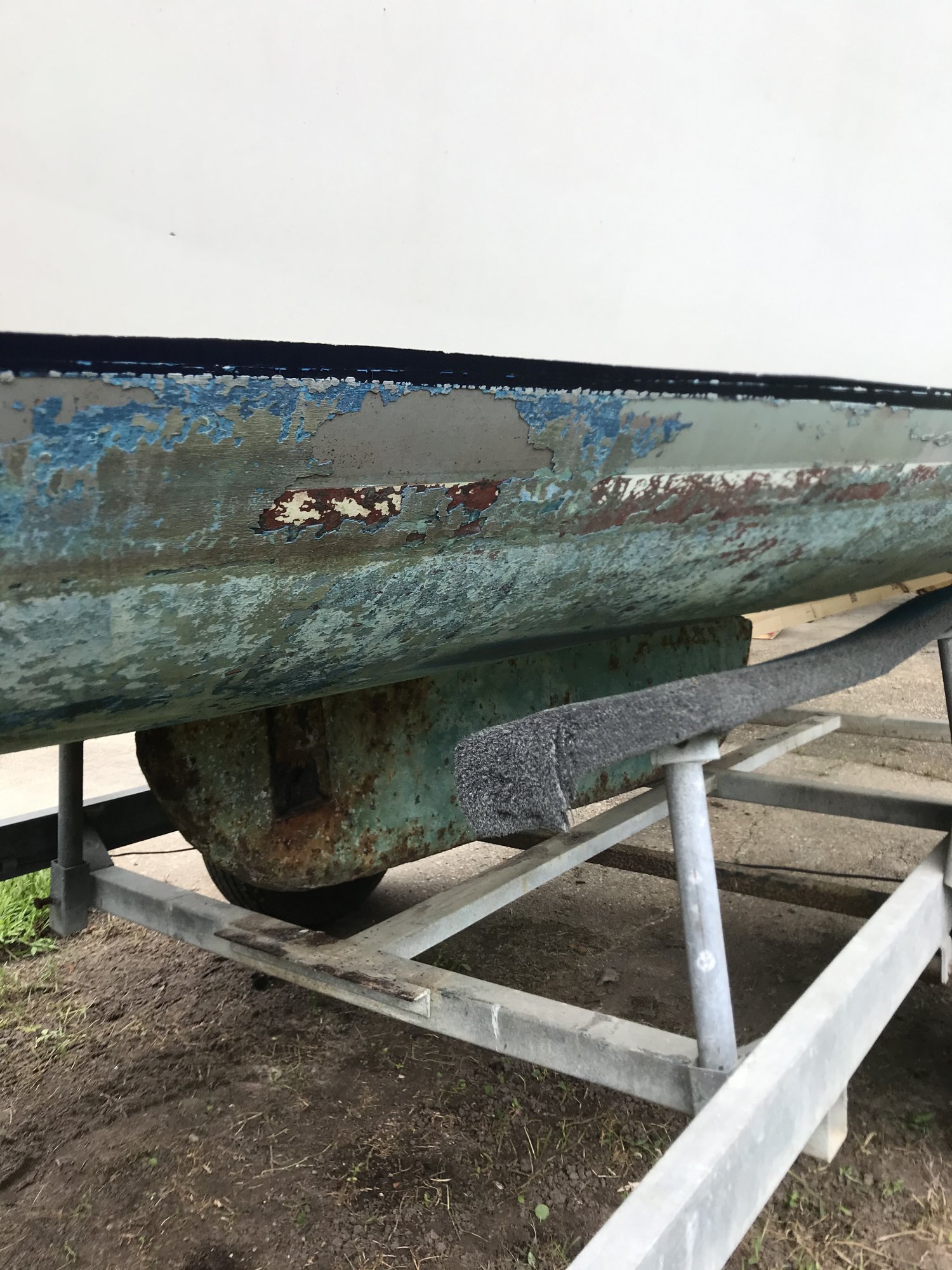

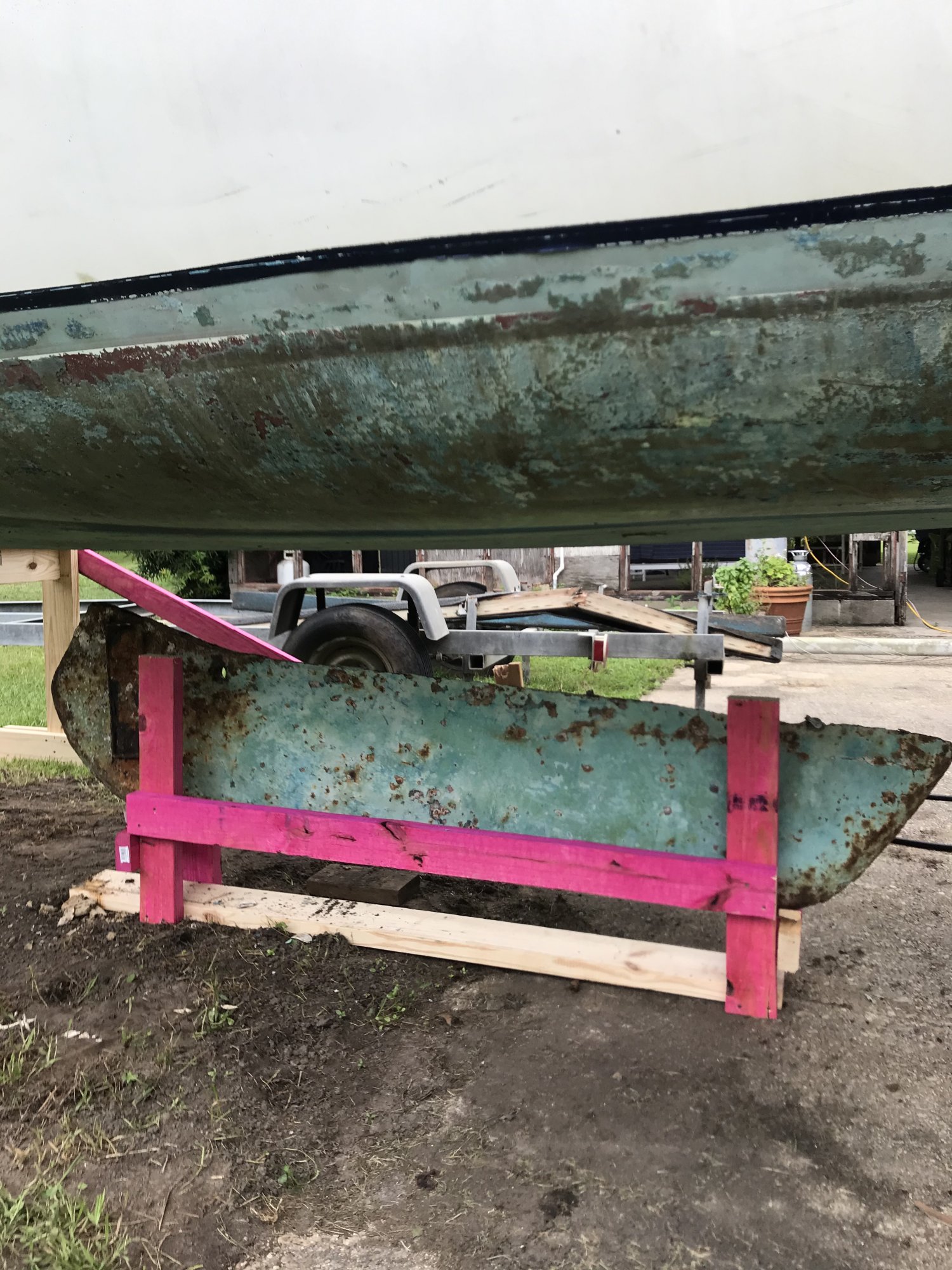

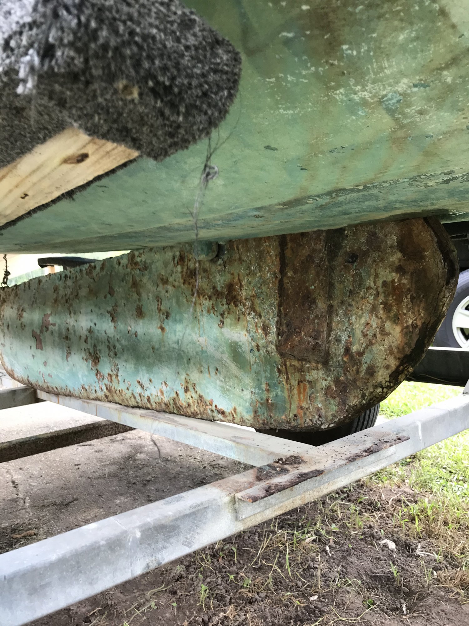

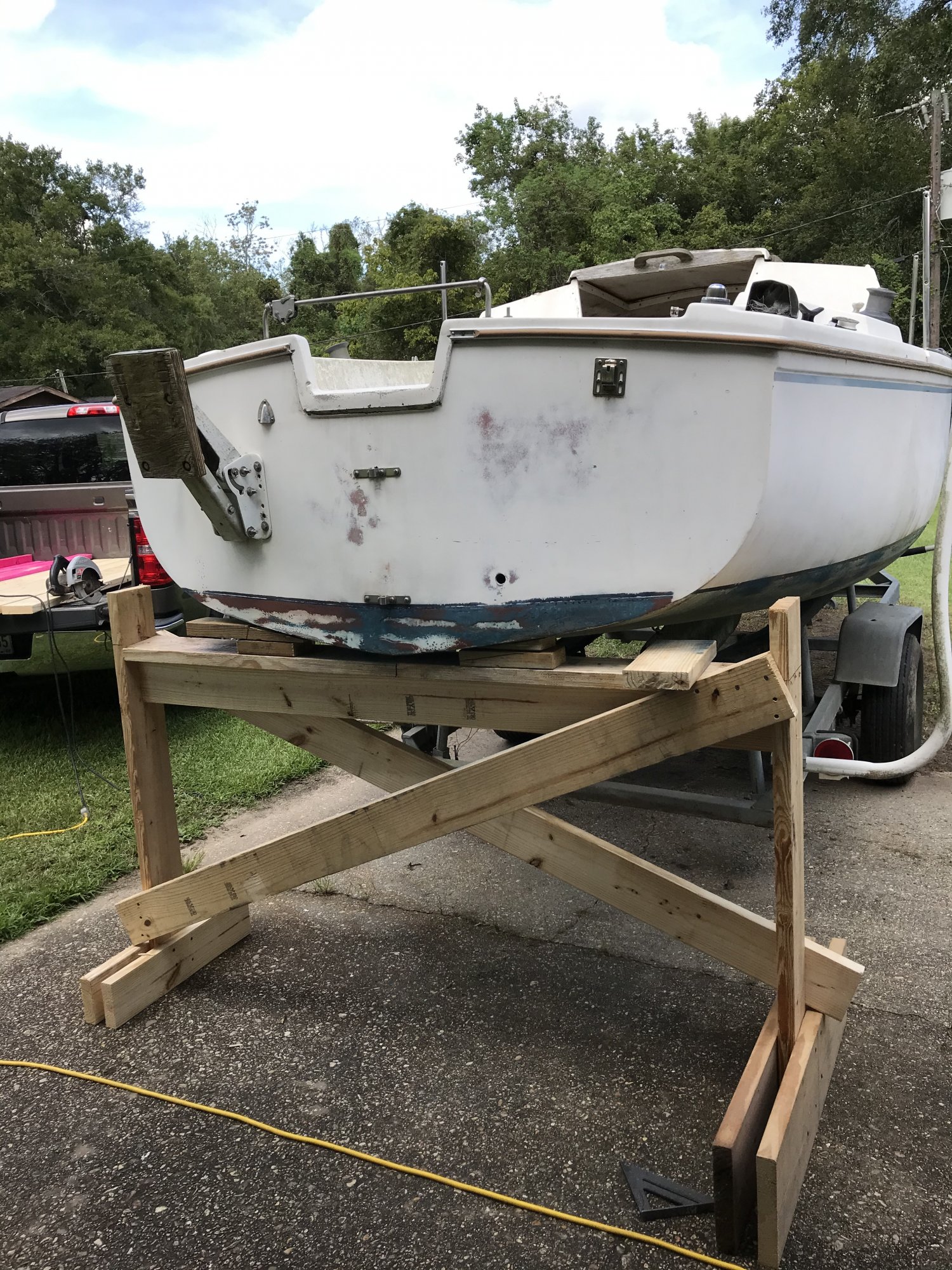

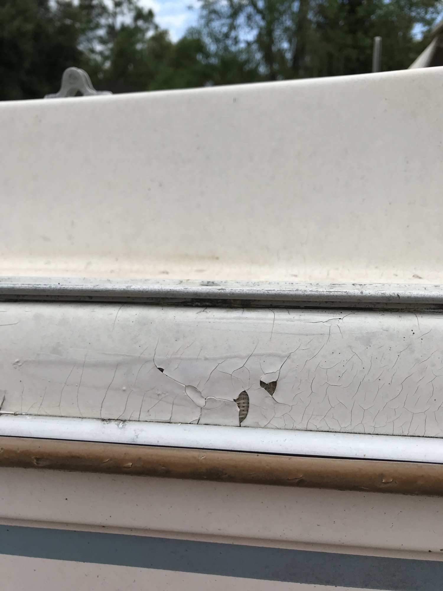

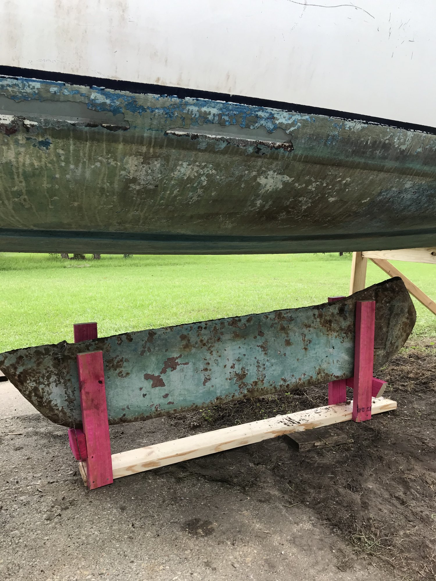

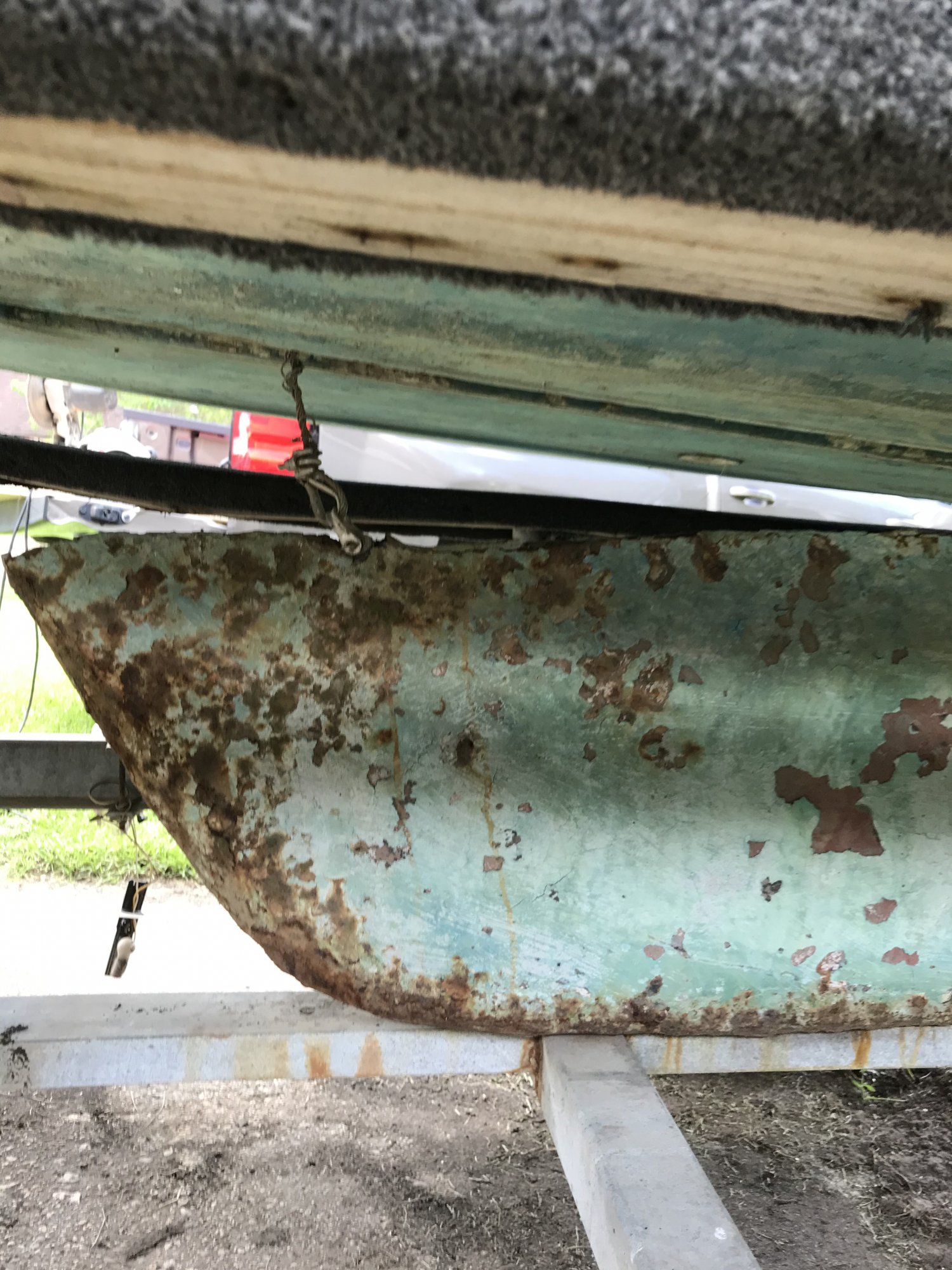

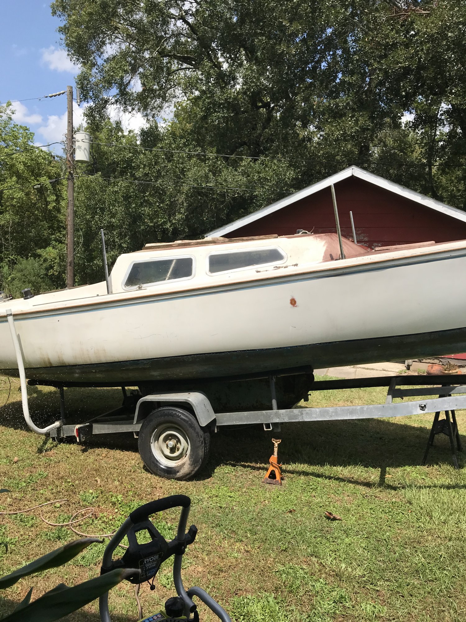

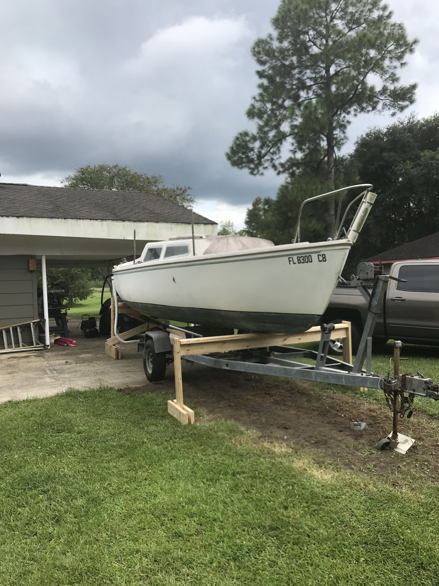

Never sailed before but been wanting to for a while finally found what I thought to be a good deal the other day. Did a quick pressure wash then moved on to getting her off the trailer and removing the keel. I'm kinda jack of most trades master of none. The keel is in pretty rough shape currently in search of a shop in my area that can sand blast it. I will use this forum to keep track of the refit and will have tons of questions. So far I am doing pretty good with my list of to do's. There is lots of cracking on the gel coat from what I've read here there is mixed answers about the way to go about repairing it but I will get to that once the bottom is finished and she is back on the trailer. After removing the keel I found one small leak where the hangars are any advice on the best way to sand inside of it to prep for fiberglass repair?

Welcome! You've come to the right place for all things C22....stick around, study older, longer threads, many here began where you've begun, and most would agree we've seen plenty worse keels....cheers!

I refinished the keel on my 1983 C22. It was much worse - knuckle size nodules of rust all over it.
Stingy Sailor has a detailed 5 part series of articles on refinishing the keel. Check out:
have fun
