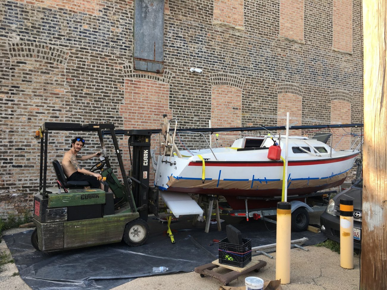

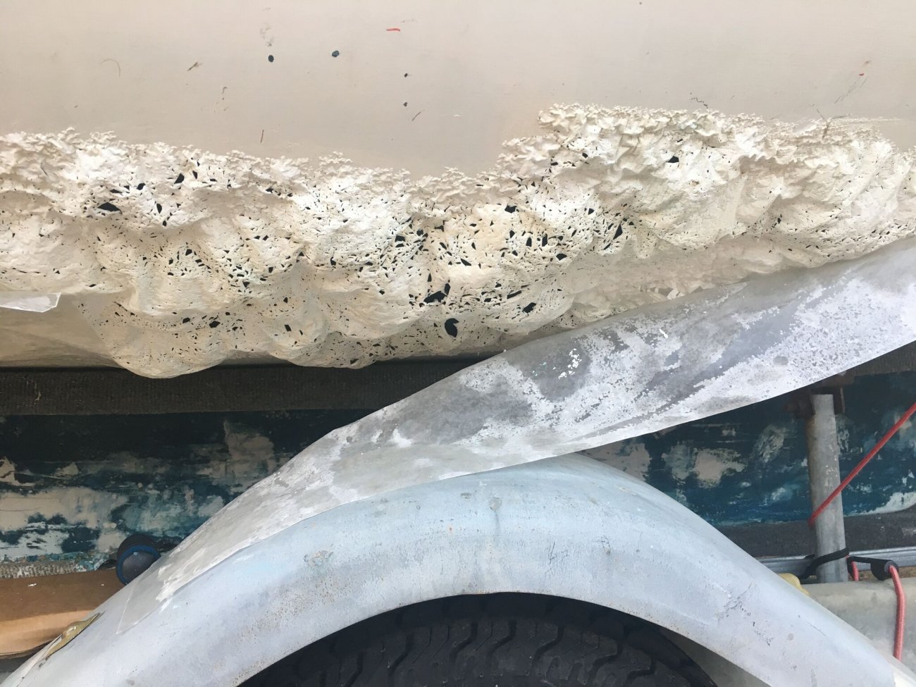

The PO of my little Starwind 19 put Brightside over the entire boat. TotalBoat's Total Strip did an amazing job. I'd roll it on the hull, cover it with wax paper and walk away for 20+ minutes and when I came back it was either soft enough to scrape away or if I waited long enough it would simply fall to the ground. Temperatures for this project ranged from 70-90 degrees. This stripper was low odor but did irritate my eyes sometimes. We also used an orbital sander with a 3M breathing mask for some areas
We used a forklift to get beneath the bunks and a laser to help mask the waterline.

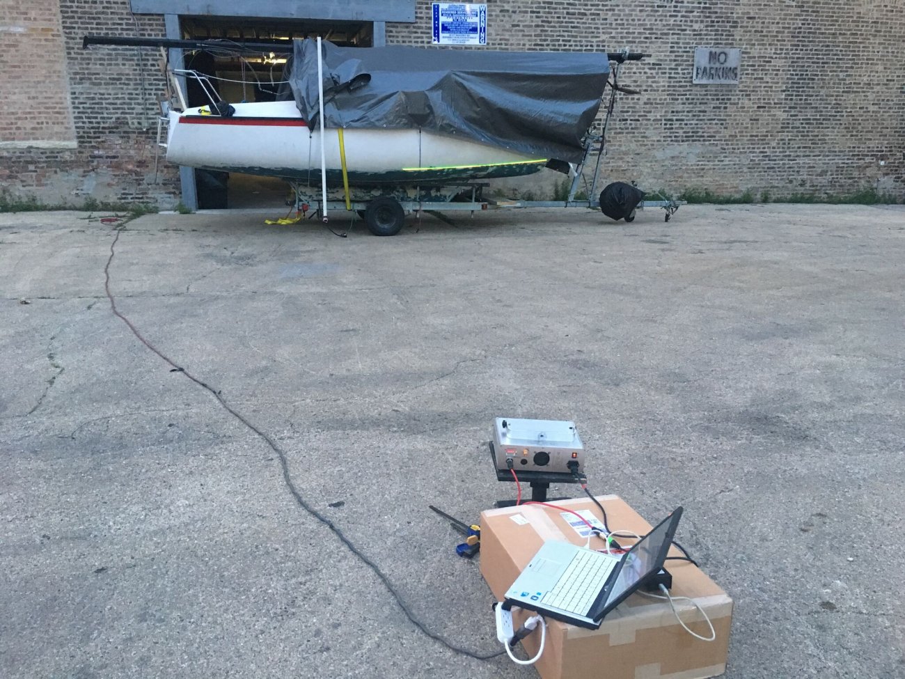

Thanks. The line actually went all the way across the hull but the camera can only catch part of it due to scanning. I own an event production company so we had lots of lights, lasers, projectors and rigging to play with. Since the PO painted over everything I had to take a semi-educated guess at the waterline. I thought long and hard about how to get the waterline straight. The ideas that ran through my head included a projector (curves of the boat wouldve distorted a straight line), string and string with a level. We discovered that the trailer jack was more precise than the cheap projector mount we had the laser on. Stretchable masking tape helped immensely

The PO of my boat put Brightside over the ENTIRE boat. Luckily I was able to see the waterline through the paint in some spots. Armed with a laser and sharpie I was able to mask what I believed to be the original waterline. Turns out I got it right or close enough to being right. The gadget did exactly what I wanted it to... Get a straight line regardless of distance
