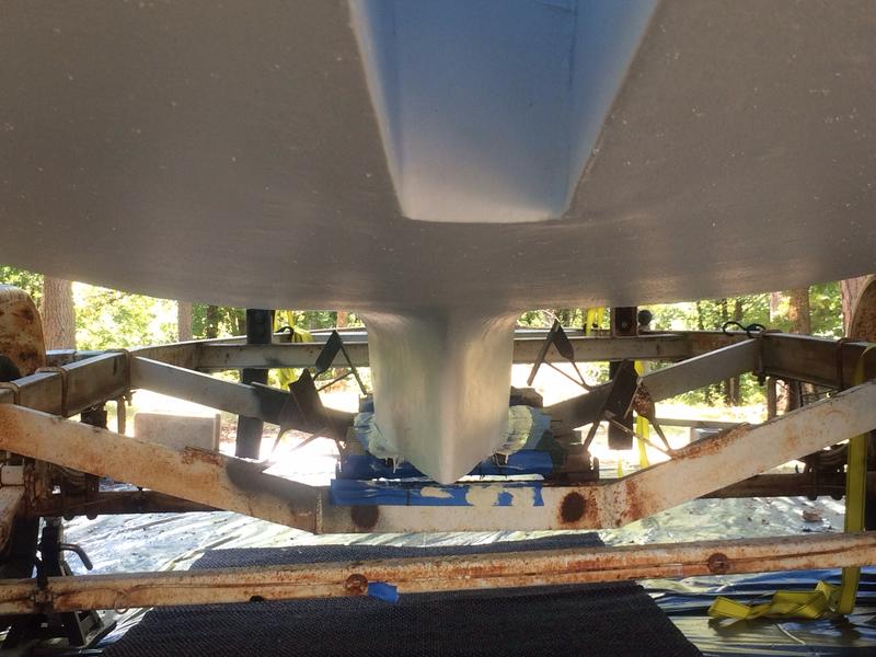

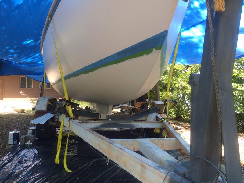

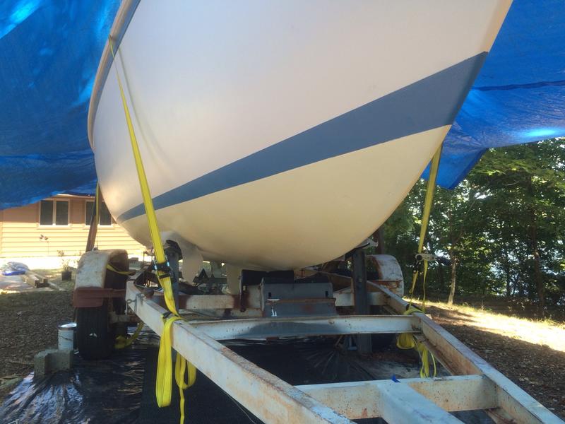

We discovered the stub keel could support the whole boat. We removed the twelve foot long bunks on both sides and strapped the boat down so so it could not roll. We placed boards on each side as well.
We made individual pads we could swing out of position one at a time, but we found we could leave all four swung out to the side and the boat would not move.
That stub keel is one strong keel. The stub keel weighs 650 pounds and the internal swing keel weighs 200 pounds for a total of 850 lbs. The boat displaces a total of 2900 pounds of water.
We're hoping this old Yankee Seahorse 24 rides the waves again in September.
