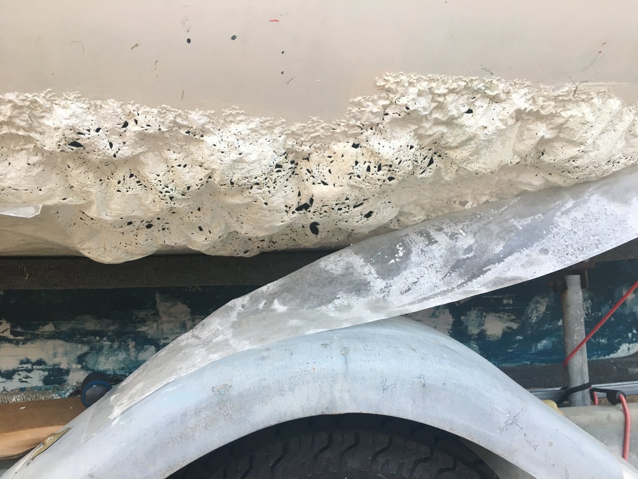

Sanding sucks. I'd highly recommend using TotalBoat's TotalStrip with a paint roller. Much faster and easier. My preferred method was to slap it on with a brush, spread it around with a roller, cover it with wax paper. After waiting it will look like this or completely fall off on its own
I have posted several times on how to make this peel away stuff for very little money. If you go to post #4 of this thread you will find the recipe.
