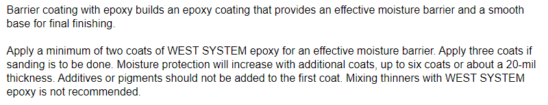

Photos.... Likely will get covered in subsequent passes. 3 applications? I thought 6 was the magic number... So you made me look up on West systems - what barrier coating system are you using?

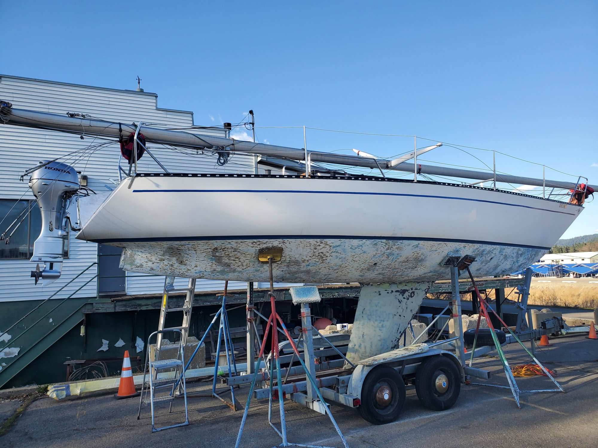

It's hard to know from photos exactly what you are dealing with. The white areas with the divots look like you have sanded down to gelcoat there. What are the whitish-blue blotchy areas in Bottom 5 that looks relatively smooth?

Bottom 5 was before I decided to bite the bullet and do a more complete sanding. This photo is after its been completely taken done to either the gel coat or glass.
I suspect the brownish color was a previous bottom paint since it seemed "soft". Don't know if it ever had a barrier coat. It's a 1980 boat. It only had one prior owner but he was not big on maintenance and then a bit on the "thrify" side.
