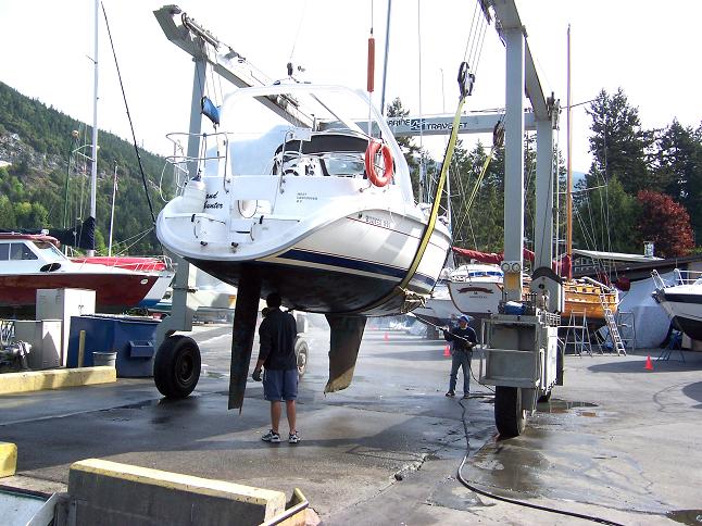

Don't know what service your yard offers but we always start with their pressure washing the boat while it's still in the slings. And this beast could blow a hole through the hull if held close enough.

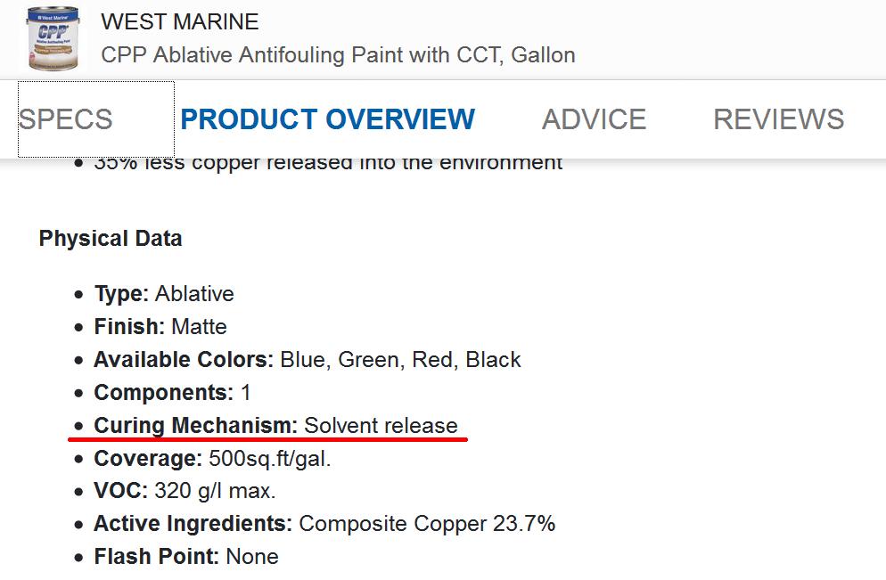

And well you should. After all, this is a forum and there is little I am willing to accept without some sort of proof.
My first clue comes in part from the West Marine product description:
I see the paint dries, it does not set by cross linking with oxygen (as do most paints) so its solvents are likely able to re-dissolve the paint after it dries. This is the case with this paint. Take some new paint and rub it onto some previous ablative paint. The surface of the old paint stays sticky until it dries. Take an organic solvent like acetone, benzene, or lacquer thinner to old ablative paint and watch it dissolve onto a solvent soaked rag. Does a good job of dissolving the old ablative.
Given that the old paint dissolves nicely in its own solvents, you are going to set up as good a bond as possible under the circumstances, sanded or not.
