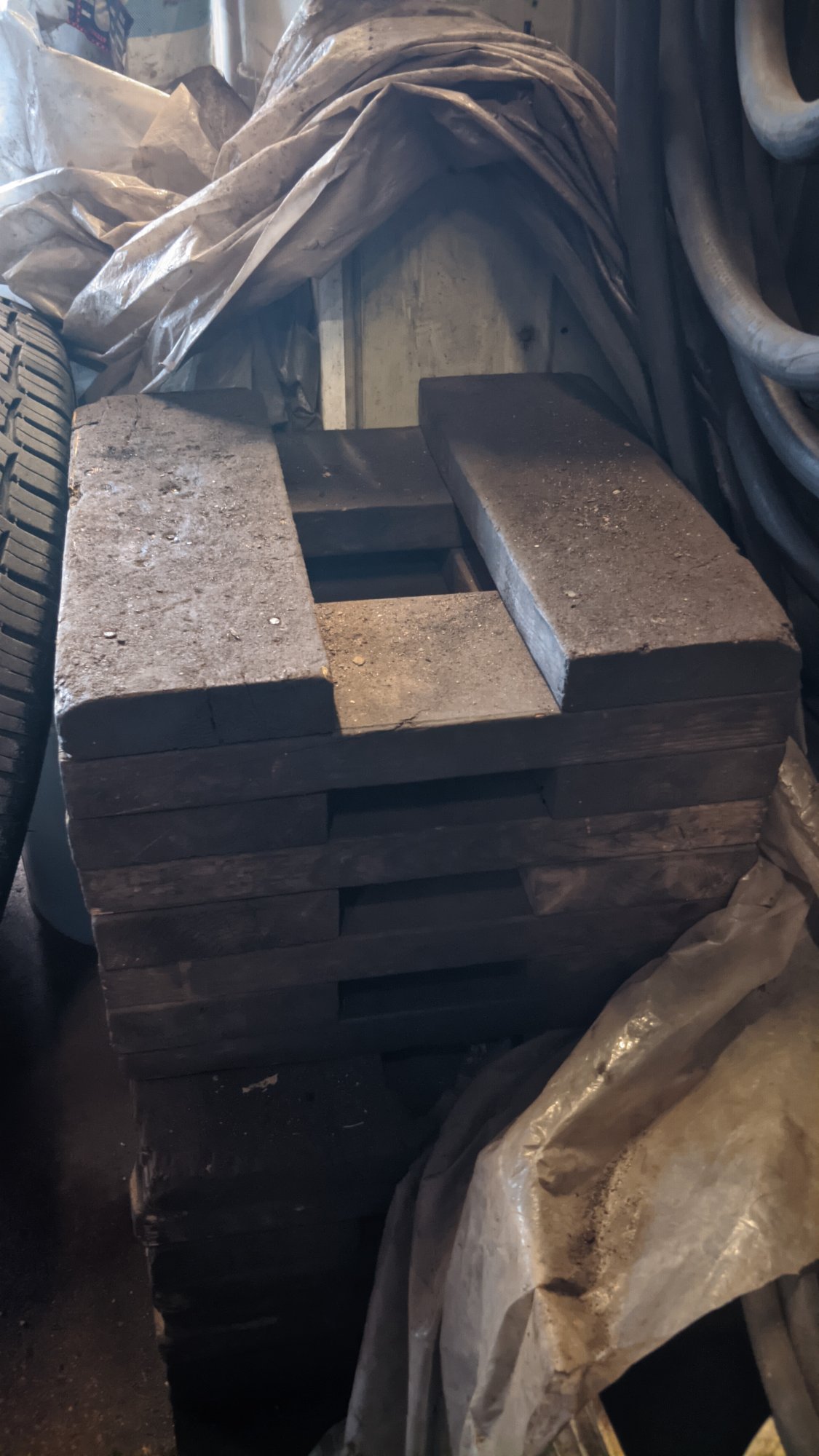

Easy peesy.
No Jack's needed. Just need a bunch of 2 x 6s and the trailer tongue jack.
Cut the 2x6 into 18 inch lengths and make a vertical column by stacking/screwing them, laying flat in a square shape. 2 pieces
per layer.
Lower the trailer tongue, stick the wood column under the transom, raise rhe trailer tongue.
Boat will lift off the rear portion of the bunks... Paint under the bunks at the back.
Repeat process for the front.
At no point is the whole boat off the trailer.
Dangerous? So is driving a car... Or sailing a boat... Ĉar is worse.
Using the right paint. It lasts multiple seasons.

Hi @Leeward Rail -- That does sound pretty easy peesy. Don't have to buy anything but 2x6's.... Can you elaborate on that a little bit? The 2x6 part?
So I think you're saying a layer is two 2x6 pieces... making each layer 12x18, and just make a stack of layers from the ground up to the transom once you've got the tongue of the trailer lowered. Sound right?
Mar 20, 2015
3,239
C&C 30 Mk1 Winnipeg
That is basically it. By doing one end at a time the boat is stable because half is on the trailer bunks.
Here is a shot of the basic wood design.
This is the one at a mechanical shop that I took the idea from. Easily adjust the height. Just keep screwing new layers on vertically into the layer below
In mine, I made it in 2 sections so I could also use them for other tasks.
This is the one at a mechanical shop that I took the idea from. Easily adjust the height. Just keep screwing new layers on.
In mine I made it in 2 sections so I could also use them for other tasks.
Nice... I like it. I think even I can handle that LOL I've never been much of a handyman... But I'm learning. I'm kind of limited on power tools, also.
It's all good. I think I'll give this method a try. I really want to get a coat of paint on the bottom.

One thing I liked about that setup is that the tower can be made into 2 smaller ones and reused for other things. Due to their large base, and resulting stability, they make perfect step stools when working on pickup trucks, reaching high shelving, etc.
Need to paint the boat again? Screw the 2 "steps tools" together again. Very handy.
I like them so much as step stools, I eventually bought some automotive lift safety stands with jackscrews and modified them for use with the boat.
