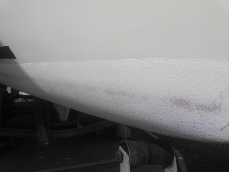

The bottom of the P23 I bought last spring is painted with a textured, heavy duty paint. P.O.
said it was on the when he bought it. Why in the world would someone paint a bottom with that? Has to be detrimental to performance.. Protection from trailer beating/bumping?:confused:

It's hard to see in the photo, but do you know where the boat was previously? If it's ablative, some folks lay that in with a 3/8-1/2" roller. Leaves a textured finish that smoothes with sailing.

...do what Warren suggested... and use a 3/8 nap roller.

Is that a color pic? If it's color I could almost see that as being an epoxy barrier coat with no anti-fouling pain on top of it.

I agree with Roadking
I would have to agree,I put on 6 coats( 3 coats of white and 3 coats of grey) of epoxy barrier piant on my 25.5 hunter. Then 2 coats of blue anti fouling.

It is a color picture, taken with my phone, not a good camera. The hull is kinda off white, the bottom paint is a little lighter in color.
I dry sale this boat, just launch when we go out, won`t be overboard full time.
The P.O. had it in this same marina, (6yrs) I`m gonna see what they might have in their records also. He wasn`t a "do it yourself" type.

how's it going? Are you thinking of repainting? I had good luck with Hydrocoat. Easy on, lasts several seasons, hard for trailering.
