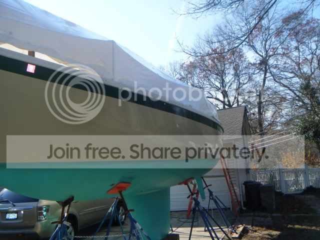

If the ablative paint is flaking there was most likely way to much on there
When I started fresh I have always ablated back to barrier coat on the seasons final powerwash
2010
2011
2012 final before recoating
I will need 6 to 8 hours of elbow grease and enough time to move the pads which is a time killer to recoat
