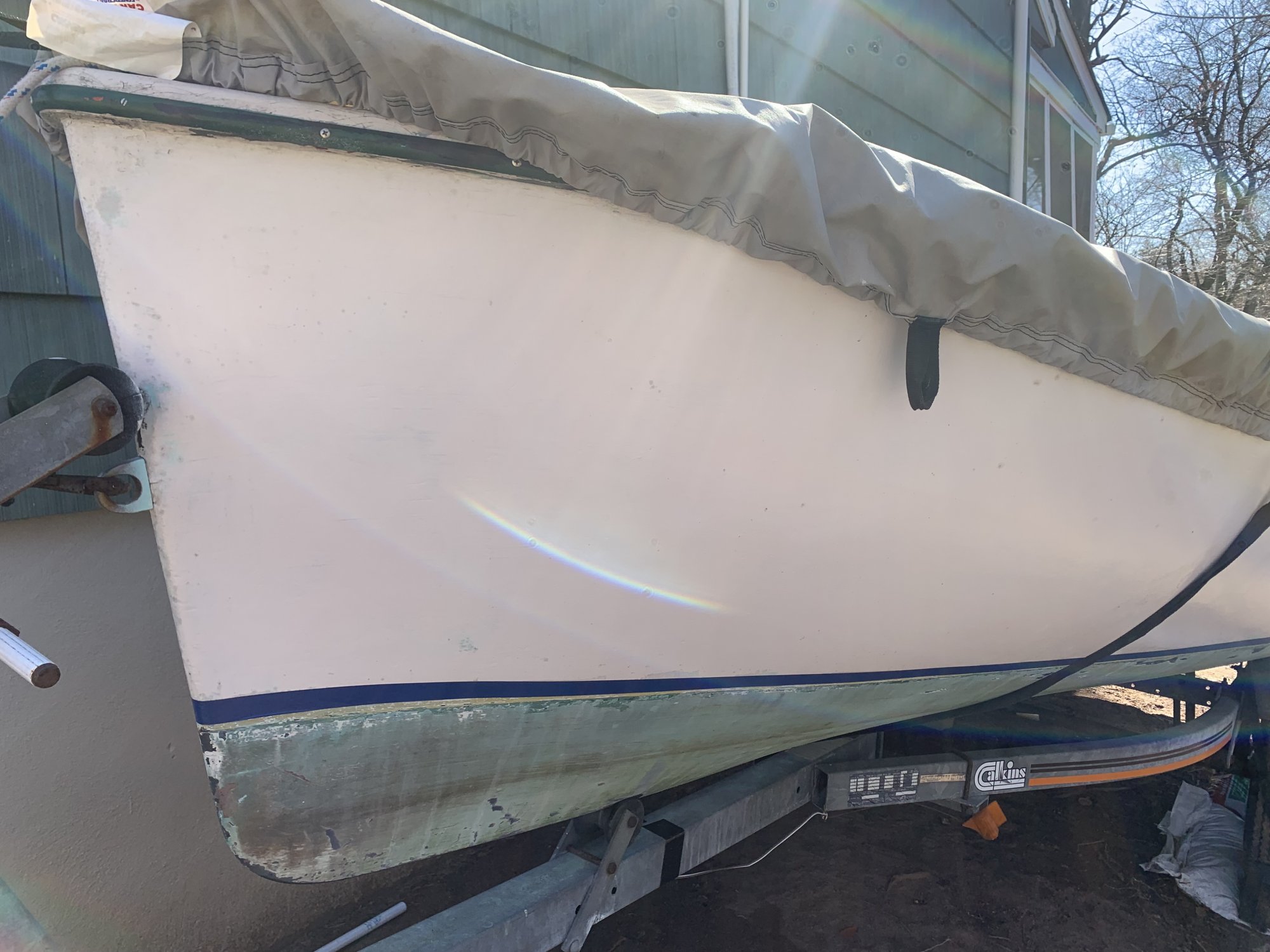

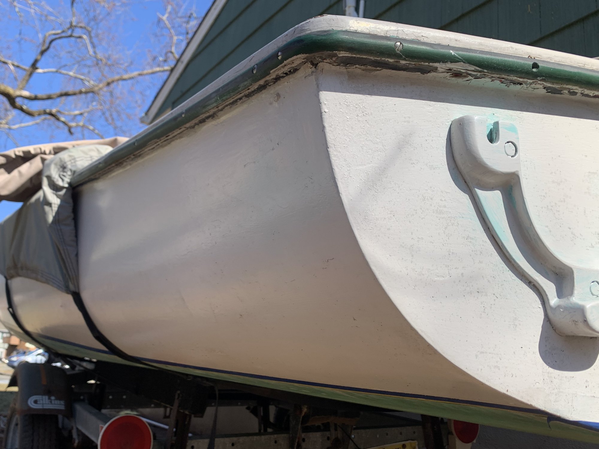

I have a 17' fiberglass sailboat from the 60s. I'd like to sand/primer/paint the bottom. I have 2 paint colors with a line of tape splitting them near the water line. But as you go to the stern, that tape boundary runs well underwater. My question is - should I just use bottom paint for the entire hull up to the gunwale? Or just for the bottom half, and use topside paint for the top half where it's currently white?
The image appears to show that when the boat is in the water, it floats high on the surface. Some boats do this, and others do not. If in doubt, splash the boat and check that the lines are where you want them. There should be no problem with putting the boat in the water. It will dry out in a day after you put it back on the trailer. You will be certain about the water line.

Definitely don’t use bottom paint for the topsides (above the waterline). Bottom paint is not designed to look good, especially out of the water. The boot stripe - the blue stripe above the waterline - may be gelcoat and not paint now. If it is gelcoat you could compound, polish, and wax everything from the boot stripe up to restore their color. This thread has everything you’d need to know for that process - Tips For A Great Buff & Wax. For below the waterline before painting check the adhesion of what’s already there. From the looks of one of your pictures there may already be quite a few layers of paint. Over times those layers become susceptible to flaking off, especially when you roll new paint on.

It is not unusual for the static waterline, i.e., the waterline when the boat is in still water and not moving, is below the curve of the hull in the aft quarter, mine is. If the boat is heavily laden then hard growth, barnacles and such, may grow above the water line, soft growth will almost always be at and slightly above the water line.
The only time to apply anti-fouling paint to a trailer sailer is if the boat will be left for months in the water. If the boat is trailered, every time the boat is launched and hauled a bunch of paint will end up on the trailer. When trailering just wash the hull with a high pressure wash and be done. A DIY carwash works.
