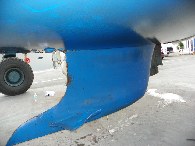

Picture below is the hull when it was hauled for the survey.

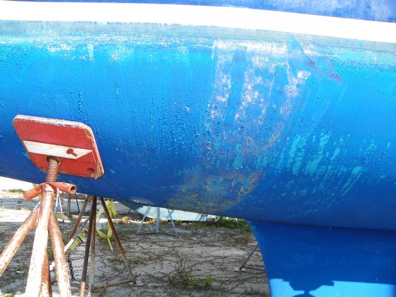

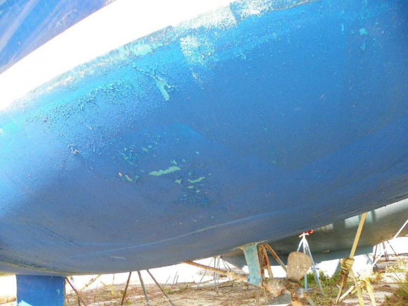

I had the bottom inspected and some pictures taken.
The advice I am getting from Florida is go ahead and launch in the boat in January as is. We will only have her in the water until May. We will then have her hauled for the summer in a yard where I will have the option to do the work myself. At that point I will call in a dealer or rep from Pettit for advice on what product to use and how the bottom should be prepared to receive it.
I'm told it is falling right off just sitting there. There appears to be a solid intact coat of bottom paint beneath the paint that is flaking off.

You should be fine. Have the diver that cleans your bottom keep a eye on it and the good news is, he will be scrubbing off the failing paint as he goes...
