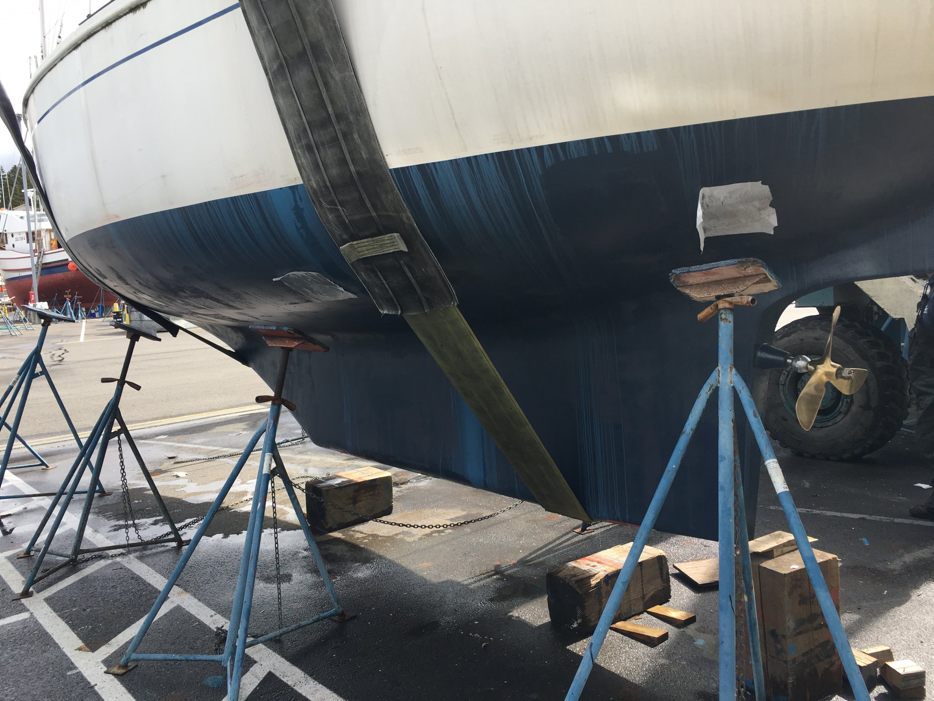

Chris only way to answer the question is to get in the water and look at the boat with a bright light or as most of us do haul the boat and while in the slings inspect the bottom.
My diver told me that the hull looked good only a few blisters.

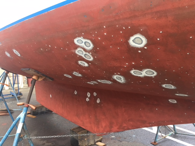

Once we started to sand them

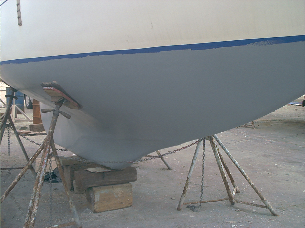

All in the gel coat layer. Faired the spots with epoxy. Covered faired spots with barrier coat paint. Then painted bottom with bottom paint
Ready to return to the water.

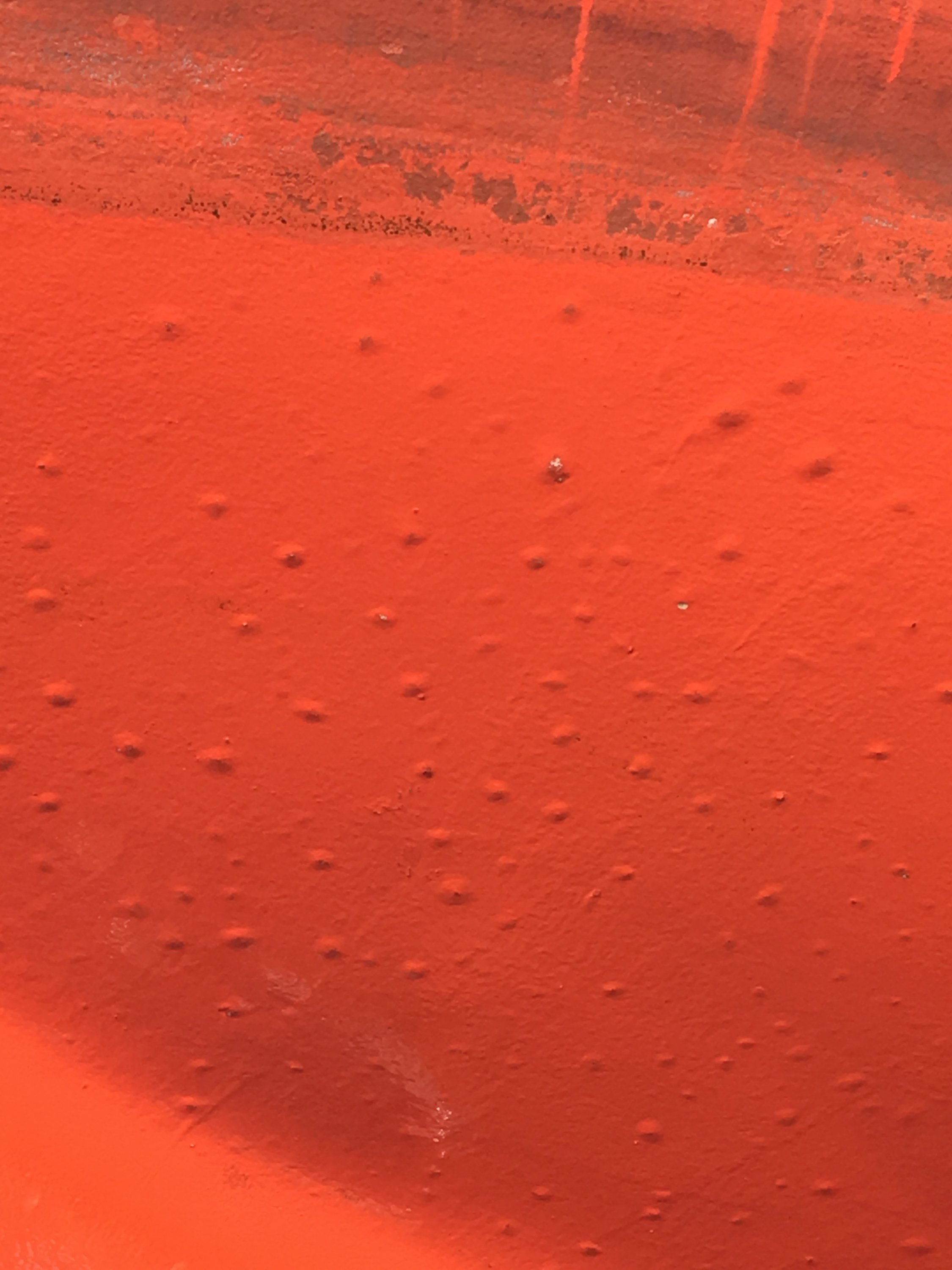

Even if you don't get the survey I'd for sure get the boat out of the water to see the bottom or do as Joe suggested and get a diver on it. When we bought the Endeavour I saw the receipts for the barrier pain and bottom paint and was told the boat was dived on and cleaned monthly and didn't have the boat hauled out.
We thought we would only be putting on new bottom paint. Wrong, the boat had lots of blisters as the previous repair only included barrier paint where they had repaired blisters. The end result was spending almost $5000 to get the bottom down to gel coat, blister repairs, and new barrier paint and bottom paint.
Find the money to get the bottom looked at,
