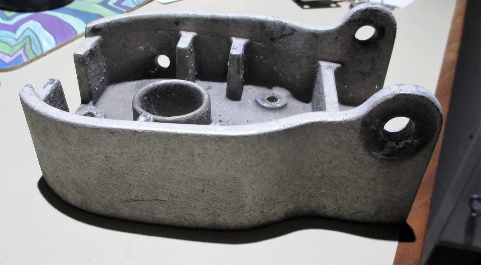

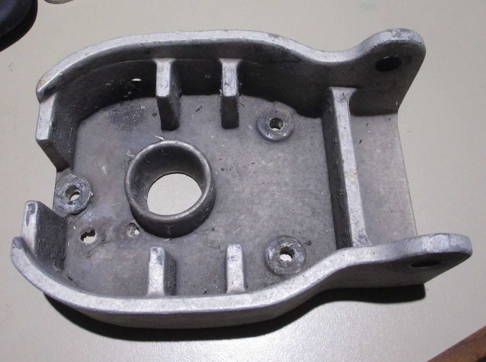

I have an Oday 272 with a broken Z Spar mast foot. My cast aluminum foot has a protrusion on the bottom that slips into a slot on the mast deck plate. I removed the cast aluminum deck plate and I am replacing the mast hinge with a Dwyer stainless steel hinge. At first I had planned to have the mast foot protrusion machined off but now I have decided to have a slot cut in the top hinge plate to accept the protrusion so that the mast foot will sit flat on the top plate and will drill bolt holes behind the sheeves in the mast foot in addition to a couple of bolt holes in front of the sheeves. I am adding a stainless steel halyard organizer plate beneath the Dwyer hinge. I haven't completed the project but it appears that it will work. The pre-drilled mounting holes in the Dwyer hinge and organizer plate do not line up with the deck holes from the Z spar deck plate so therefore the bottom hinge plate and organizer will have to be re-drilled

Is this the mast base/hinge for the 26? That is for the Z-Spar mast, I know it isn't the DWYER setup.
You have a Z Spar setup. My (272LE) Z Spar mast base parts are a different model than yours. I have internal halyards and sheeves in the Z Spar mast foot which are about 2" tall. My model Z Spar foot is shown in the RigRite online catalog but it is no longer manufactured. I had to keep the same basic height on my mast foot so that my stays and furling would remain the same so therefore I removed the Z Spar deck plate and I am mounting a Dwyer stainless steel hinge plate to the boat deck and mounting the Z Spar mast foot to the top plate of the Dwyer hinge.
You may be able to find a similar mast foot and base in the Rig Rite online catalog that will work. I have seen parts similar to yours. I have also seen parts similar to yours on Ebay if you do a search on "Z Spar mast parts". I'll post a picture of what I modified on my mast parts when I get them back from the machine shop in a few days. Best of luck in your repair.
