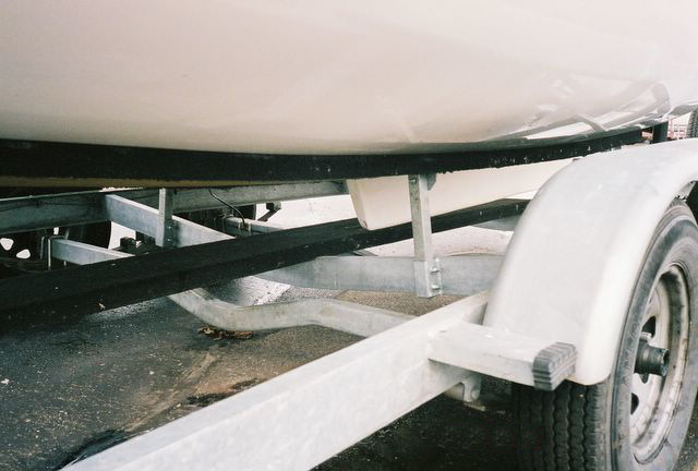

For what it's worth:
My view is boats that sail primarily in fresh water for only part of the year don't need bottom paint.
I've never painted the bottom of my 2003 H260 and after a powerwash and application of Slimy Grimy it looks factory fresh when I put it away for the winter. I do apply a coat of wax on the parts of the bottom I can easily reach in the Spring when I wax the rest of the boat. That helps a great deal in preventing the slime to really take hold.
We have a serious problem with mussles here in Lake Michigan, but they don't get a chance to take hold during the 5 or 6 months the boat is in the water. You'll see a few dots where the mussles are trying to grow but they are easily removed.
If I thought the time and cost was worth it, I'd paint the bottom but after 6 seasons it still looks factory fresh after an end of season clean up. The only reason I'd paint is if I start getting blisters -- then I'd apply a barrier coat.
