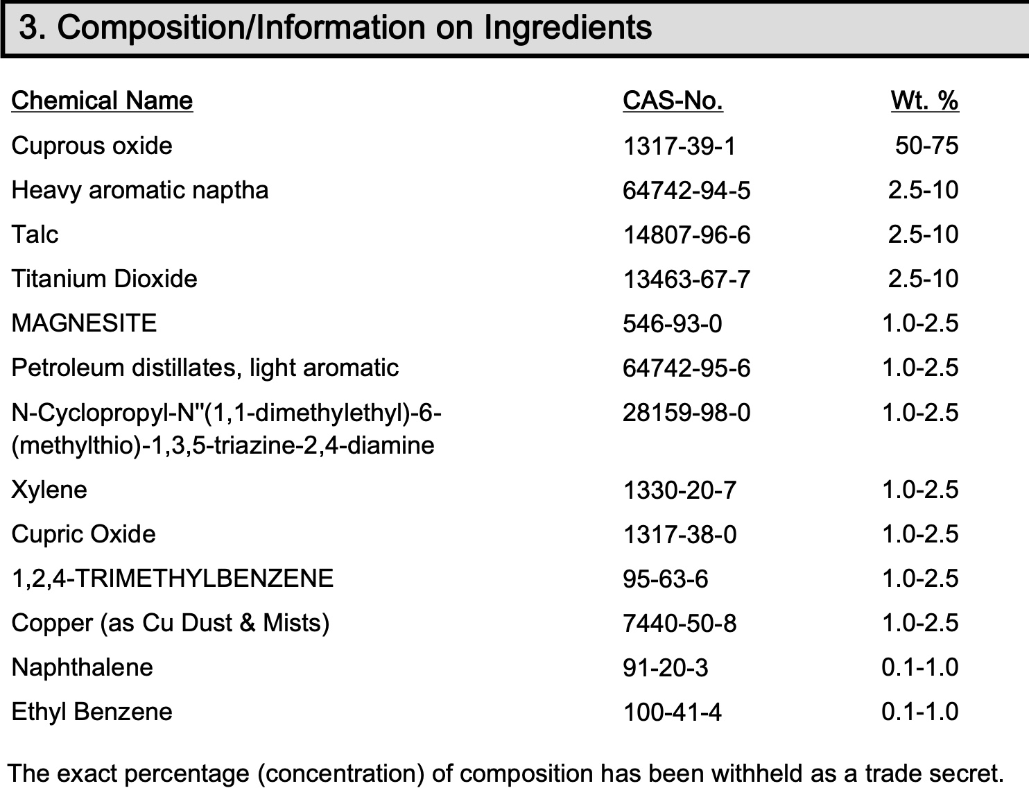

Glad to hear it works. I wonder though if what’s on there now has Irgarol and if new Trinidad Pro still does. I did a search for Trinidad Pro, and I could find some on clearance that says it contains Irgarol. What I find on Defender as a regular non-clearance item only lists copper as the active ingredient, no specific biocide. If that’s the case you might have more slime buildup in the future.
24,509
I am going to say NO.
Here is the product MSD Sheet data about the product.

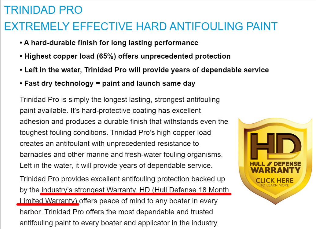

Next spring I'll have the bottom painted again as I see no reason to push it past that.
One good reason to push it past that is cost.
Trinidad is offering an 18 mo. warranty so it's got to be good for at least that and quite possibly much longer.
My current coat is a double coat of West Marine CPP Plus ablative. Its predecessor coat was seven years old. @Terry Cox brags that he got eight years out of his previous ablative coat.
Trinidad is the right paint for your area. Take advantage of that and leave it to do its job and when it finally starts to wear out, renew it.
