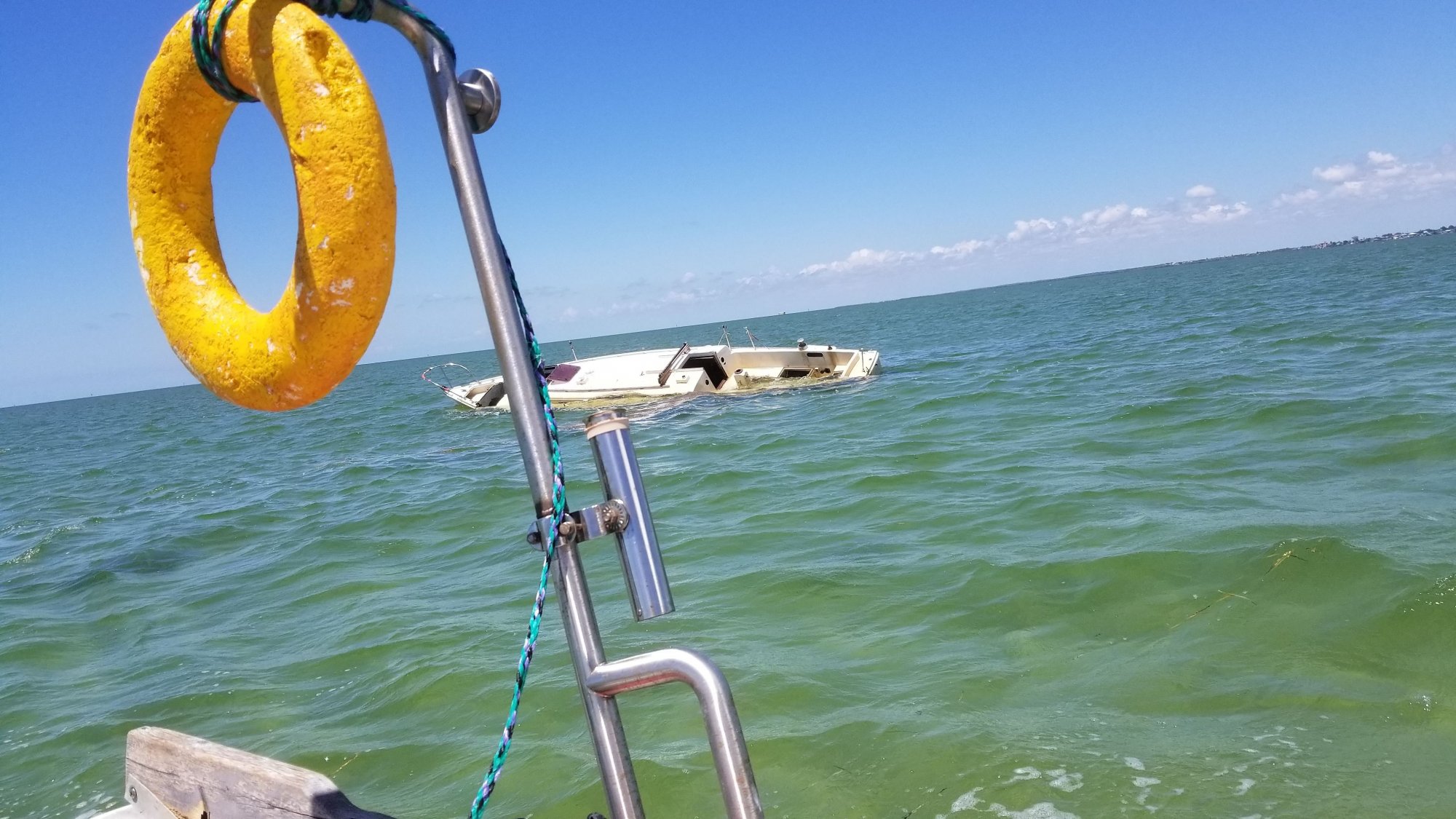

I am thinking of sailing boomless. With the foot conected with a cunningham to the tack and the clew sheet and block attached the rocket launcher on the stern above the tiller. In the picture the yellow life ring attache to the rocket launcher, think big U that is the mast holder when the mast is down for travel. The main sheet and blocks then would be out of everybodys way.

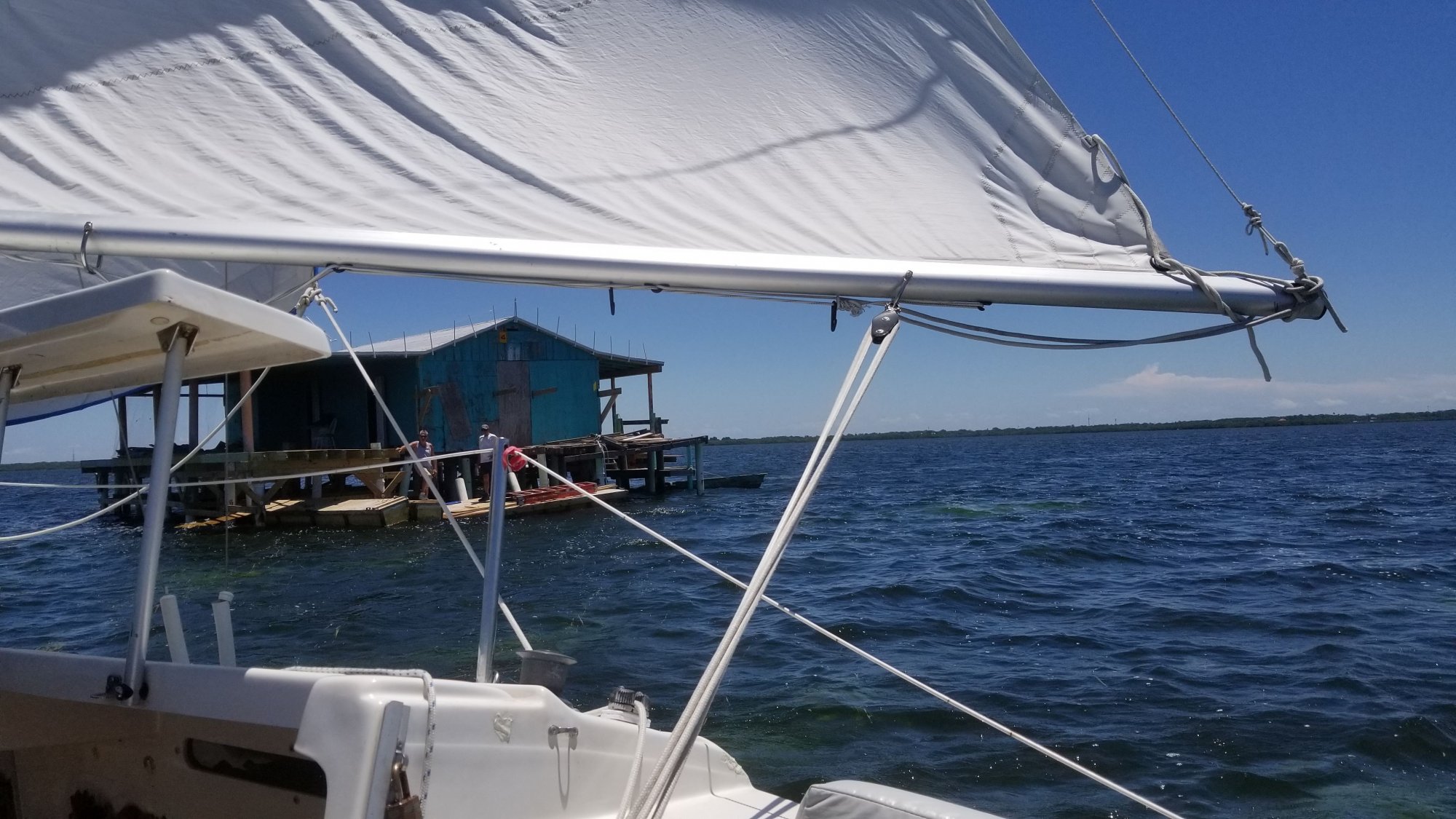

If the idea is to get the mainsheet clear of the cockpit area, I wonder if it would work to rig the mainsheet at the stern, like in this photo.
