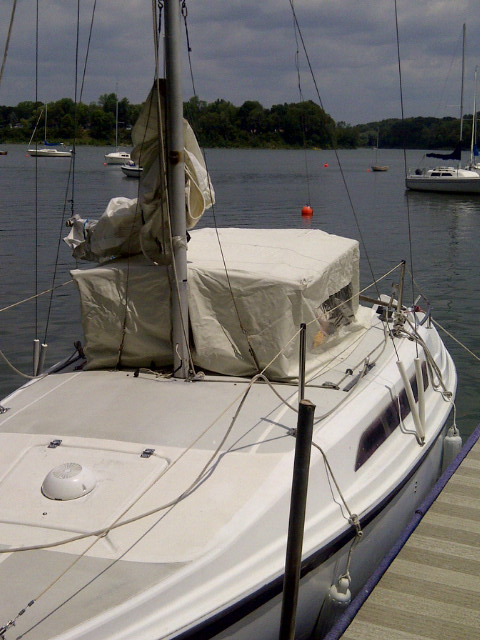

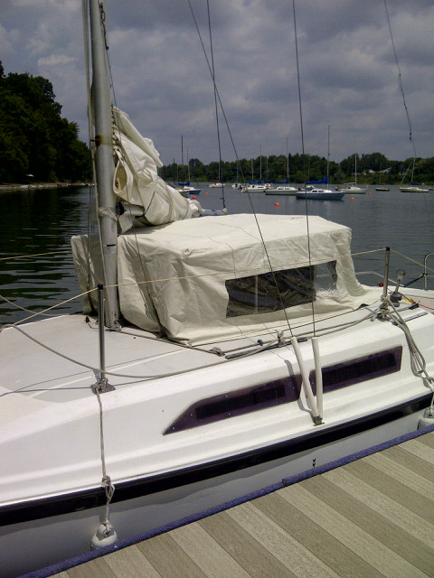

Jason you need a topping lift. Just put another turning block in the chicken head on top the mast and run a line. Its all I use and my pop top goes up all the way.
See in the first picture there is a line going to the end of my boom. Well I can adjust the line and raise or lower my boom with it. I usually just shove the boom to one side and don't worry about it.

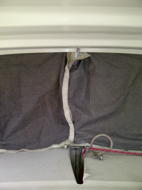

In the last picture you see the attachment that holds the pop top to the mast.
