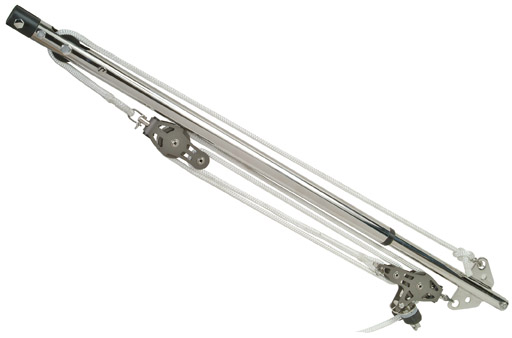

I have a Capri 22 Tall Rig with a boomkicker. Because the boomkicker forces the boom up, I have to use the vang to help manage sail shape 100% of the time. Looking at the racers, I see their booms pulled down and fairly flat sails all the way to the top, even when the wind is honking. I have a racing main.
So here's my quandary - it seems like I can induce more twist at the top by letting the boom rise, which means easing the vang. But it also seems to me that raising the boom makes the sail fuller down low, so maybe it defeats the purpose when I'm trying to depower? Either way, all 4 telltales fly (3 when reefed). Am I defeating the point by letting the boom rise or is that what I need to do to depower it? Maybe I'm letting to go too high?

Ok, that makes sense hard on the wind, And the kicker doesn't really have any effect when the boom is hauled in tight, but as I ease the sheet to foot off the kicker forces the boom up. In light wind the kicker will totally mess with the shape anywhere but close hauled. I'm talking 15-20° up angle and a huge bag in the sail. Exactly the shape a vang fights downwind I think.
I'm not familiar with how the solid vang works. Does your solid vang apply upward pressure to the boom all the time or only when you set it on a downwind run? By design the Boomkicker is like an archery bow and always under tension, forcing the boom up regardless of point of sail until close hauled. So as I ease the sheet the boom rises more than it would with no kicker. I manage that with the vang.
I think what I was trying to get to is at what point is the back end of the boom too high and does the fuller, baggier shape low offset the benefit of the twist at the top?
Btw I got a "you were fast" after tonight's beer can, but the wind was light and I wasn't trying to twist off the topto de-power :)
Joe
Jun 1, 2004
8,346
AHA!!!! you have exposed the fundamental flaw of the boomkicker when compared to a rigid vang.... The boomkicker's design requires that it constantly be restrained because the rods are always bent... and they want to be straight.... so it is always pushing up on the boom, rather than simply supporting it.
The rigid vang is designed to support the boom in a neutrall position... but still allow movement above that position.
There is no neutral position with the boomkicker. Yes you could tie a stopper knot in the control line... but then you would restrict any further upward movement if lots of twist is desired. Or.. you could attach a restraining line between boom and mast with a quick release feature...but..that's a hassle...
Don't get mad at me for suggesting this... but if the boomkicker is inconvenient... take it off and sail without for a while.
Now, here is the frustrating fact.... you can purchase a Garhauer rigid vang for your boat for not too much more that the price of the boomkicker system.... $275 for the RV12-1
http://garhauermarine.com/catalog_process.cfm?cid=40
The advantage is obvious... the rigid vang does not keep constantly pushing up on the boom... you release the control line...it doesn't interfere with your trim... Your quandry is no more.
I think that's what the tell tales are for. trust them. If the bottom telltales disappear... you're overtwisted.

The way the rigid vang works does seem like a better approach to me and the price for the garhauer one you posted isn't obscene. I might see if I can get a closer look at one of the boats in the marina that has one. Just need to decide if that's the route I want to take and where it fits in the upgrade list.
I have a Z-Spar rigid vang and it operates effectivly identical to a boom kicker, I always control the vang's lift with the vang sheet, and I've found that (particularly in light air) it improves performance as the boom is never weighing down the main affecting the shape of the main.
I view the fact that on any point of sail it allows you to either lift the boom, or pull it down, with a single control line, to be the single biggest reason to install my rigid vang (although eliminating the topping lift to be a close second!).
Joe
Jun 1, 2004
8,346
The point of the rigid vang is to support the boom..... not to lift it beyond a useful level. The vang tackle pulls the boom down... the springs, or pneumatic piston, return the boom to its neutral postion... thus eliminating the need for a topping lift. The limited lift of the rigid boom's design allows it to support the boom without needing to adjust the control line.
If the rigid vang pushes the boom up higher, past the neutral position, and thus needs restraining like the boomkicker system, then it has been improperly installed.

That was quick, chris... but I can guess what happened. You know I was thinking that a weaker set of rods could solve the problem... is that something boomkicker offers. Or... maybe one rod instead of two.. I don't know..just looking for a reasonable solution

Joe,
The height that a boom kicker will raise the boom is dependent on the installed geometry. If the attachement point is moved aft on the boom, the boom will be lowered. Some models have adjustable slides for this purpose. You might also be able to shorted the length of the rods.
Todd
Joe
Jun 1, 2004
8,346
Joe,
Todd
Aha! An informed voice... thanks for the explanation, Todd.
You know I thought about that a lot last night... and it makes sense that moving the boom bracket aft would reduce the recoil on the rods... similar to the way a rigid vang is installed. So perhaps Chris' dilemma is caused by an improper installation..... in oither words the "bow" is arched too tightly..
Anyhow, thanks for clarifying my thinking.... Once I started comparing the two systems I realized that the boomkicker design should be adjustable, same as the rigid vang... just didn't see it right away.
So it looks like my major issue with the boomkicker has been resolved...... I'm especially pleased that Chris may be able to solve his problem easily and inexpensively by simply relocating the boom's bracket.

PO already shortened the rods. Longer or weaker would definitely help with the problem. Placement of the in-boom reefing lines dictates where the boom mount goes as the perfect spot would be right where the reefing lines come out of the boom. Solid vang one of these days will sovle the issue.

On my Boomkicker, the attachment point at the mast base is variable, which will also change the geometry. Is yours all the way at the end of your sail slot? If not, try lowering it. On mine it's just a matter of unscrewing it, sliding it down and reinstalling the screws.

Your boomkicker problem sounds like trying to sail without loosening the topping lift. It works against your primary sail trim controls. I also don't understand why the boomkicker failure caused the boom to drop into the cockpit. Once the mainsail is raised it should support the weight of the boom with no trouble.
I agree with everybody else; try sailing without the boomkicker for a while. It's only purpose is to support the boom when the mainsail is lowered and there are simpler, less-obtrusive ways to do that. Worse comes to worst, you can always reinstall the topping lift.
Yeah, it's as low as I can get it and still attach the vang to the tabernacle padeye.
