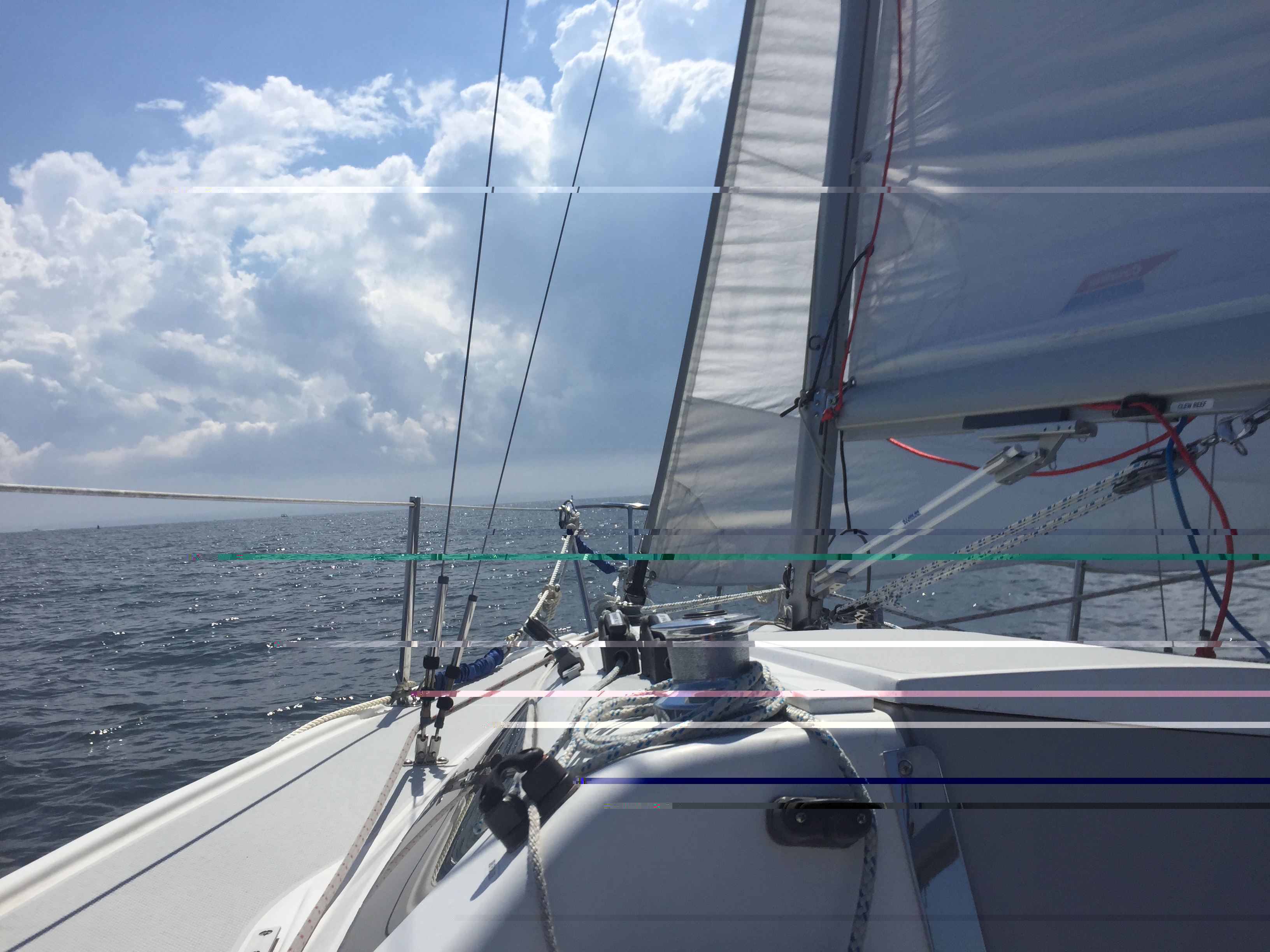

I recently replaced my old boomkicker with the adjustable one from Catalina Direct which also includes a part to stop the rotation. I have not installed this part yet but have not really noticed any problems/binding.
I shortened the Boomkicker rods by a few inch but was able to move the boomkicker boom attachment point further towards the end to get more leverage.
I like the fact the boom attachment points rests in a slide with 3 adjustable stops to define resting height.
I had trouble to raise the main sail with the fixed one.

You should give it a try.... I only shortened the rods as I wanted to use one of the already drilled holes from the old boomkicker using the furthest old hole as the farthest for the new slide....
Btw since I took the picture I switched around the boom vang again so the line to tighten leaves the block at the mast as you have better leverage to pull towards you instead of down when the exit block is at the boom.
