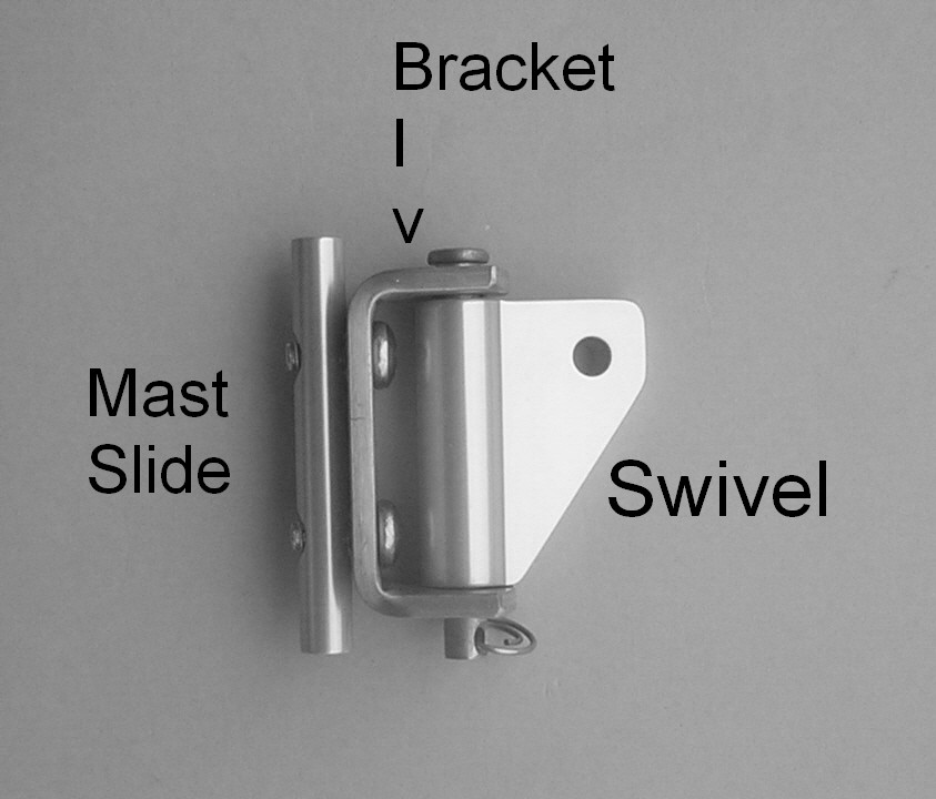

Boomkicker has a mount near the base of the mast. Mine goes in the track and swivels along with the boom.

Thanks for the responses, folks. Appreciate the photo of the lower mount too. I did find that.
It's the boom mount I'm curious about. Since my boom does rotate through about 60 degrees I don't know if the BoomKicker boom side mount will be destroyed by the rotation of the boom. Would hate to have it all installed and then see the thing mangled.
