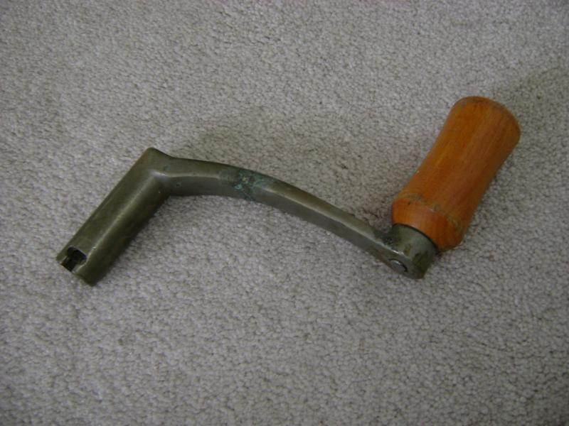

I own a 1970 Morgan 33, the fitting at the forward end of the boom at the mast does accept a special handle. The early Morgan models had main reefing by furling it around the boom. The handle is brass and notched to fit on the stainless extensions.
I can send you a picture of the handle if interested.

Morgan main sail furl handle
I will send you a picture as soon as I get my gear out for this season.
garyg
Oct 14, 2005
22
Morgan 33 annapolis, md
photo of handle attached ( I hope )

hello all
thanks for the picture of your boom handle... that will not work with my boom... you have a T notch in the end of the handle where it attaches to your boom... I need something like a large allen wrench to fit into the opening on my boom and gooseneck...
still looking for the boom handle ...
