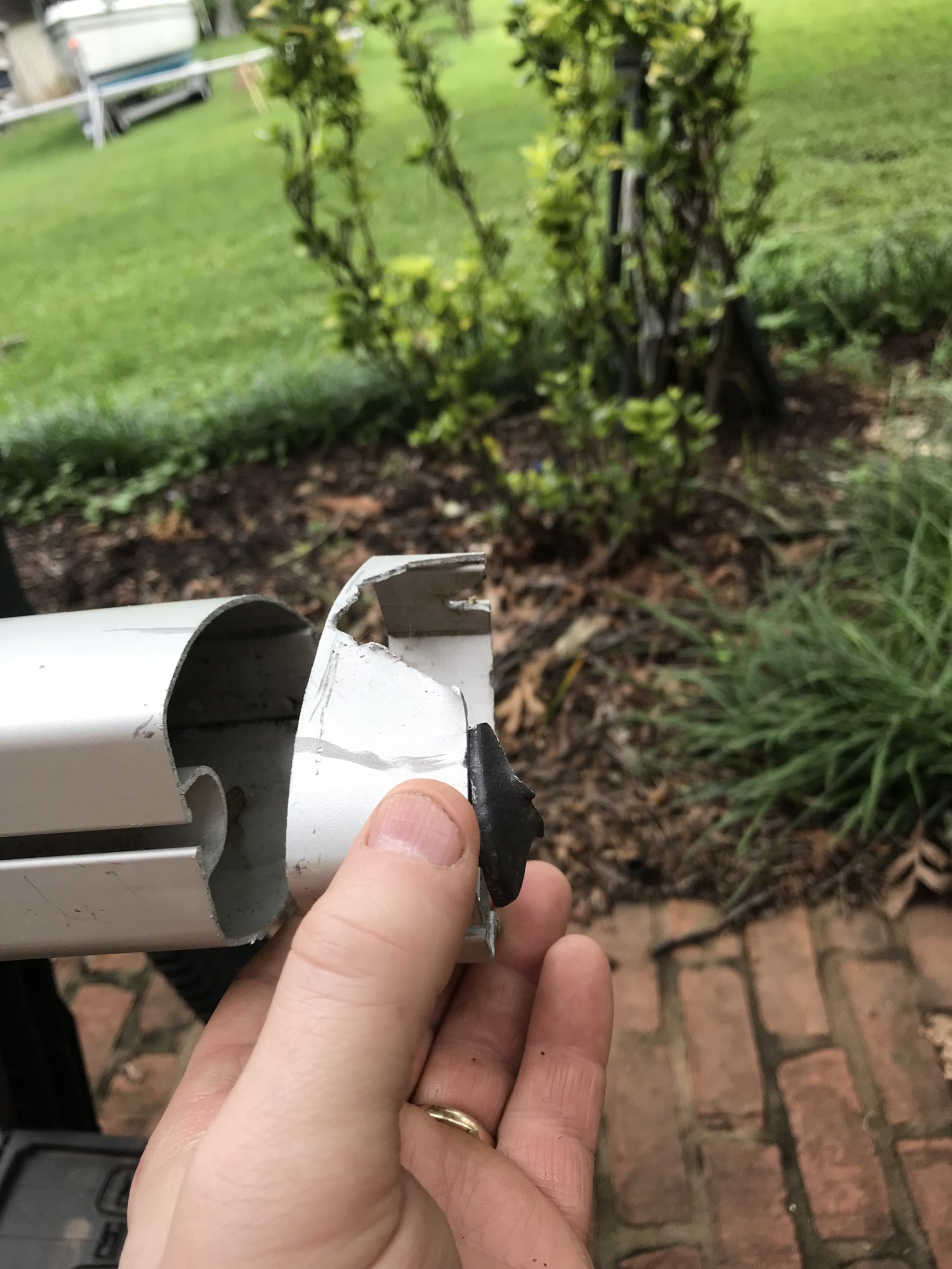

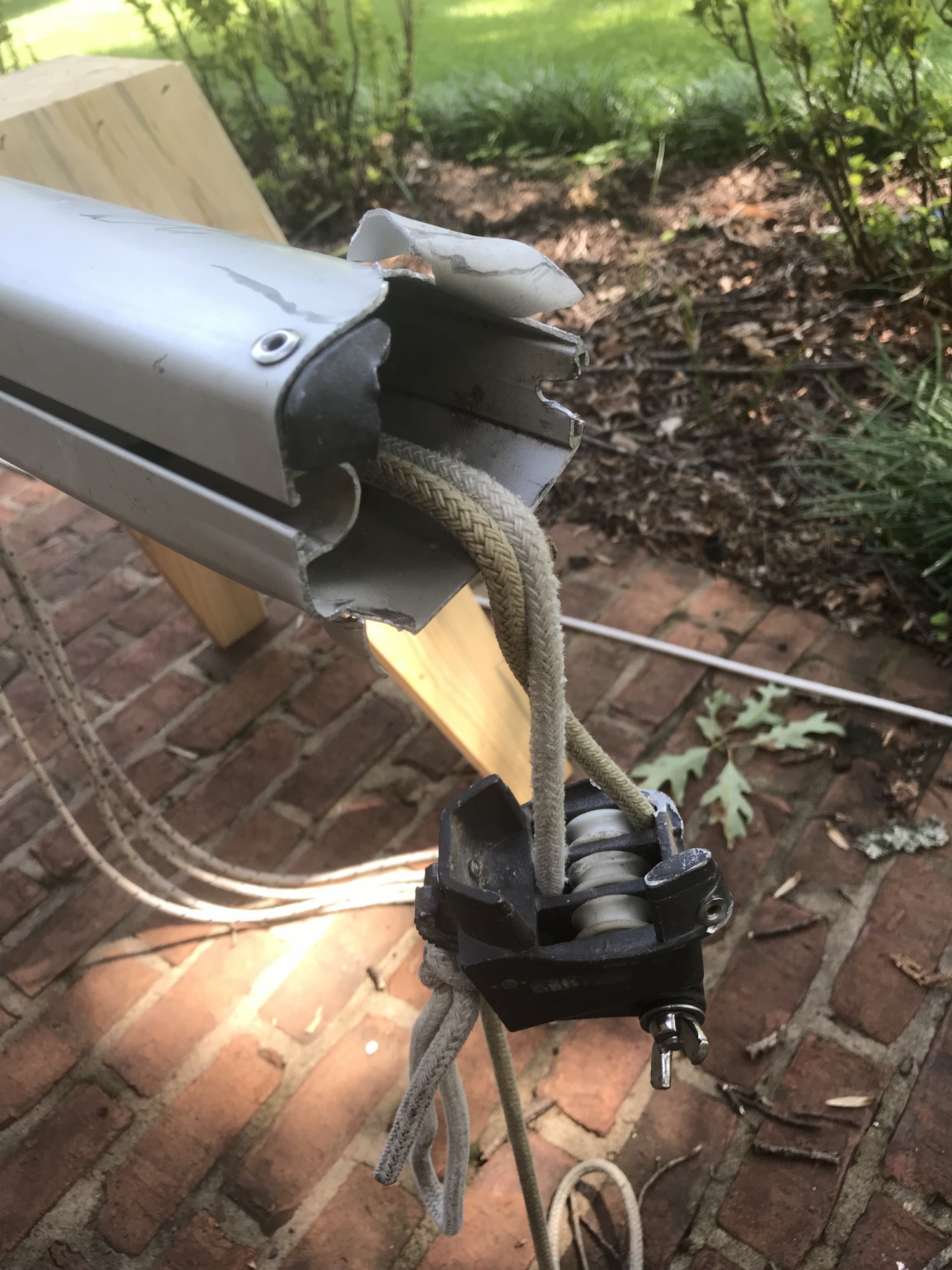

A longer boom can be cut back with a hacksaw and the end cap reattached with a rivet gun. Salvage yard is still a good choice.
I feel kind of lame quoting myself but here is me doing a repair on a boom with a hacksaw. I did not have to buy a new boom. Mine was about 6" longer than it needed to be so I just cut off 1.5". I also broke my end cap so I needed to buy a new one. Drilled some holes in the new boom end -- and through the ears on the endcap and poket riveted the new end cap into place. Easy peasy.
I prefer to use rivets for two reasons.
1) They don't ever back out
2) You can match the metal. In this case I used aluminum rivets in an aluminum mast.
I have had older boats where the machine screws were used to hold bails and tangs etc. on a boom. And I always found corrosion where the screw went into the aluminum.
