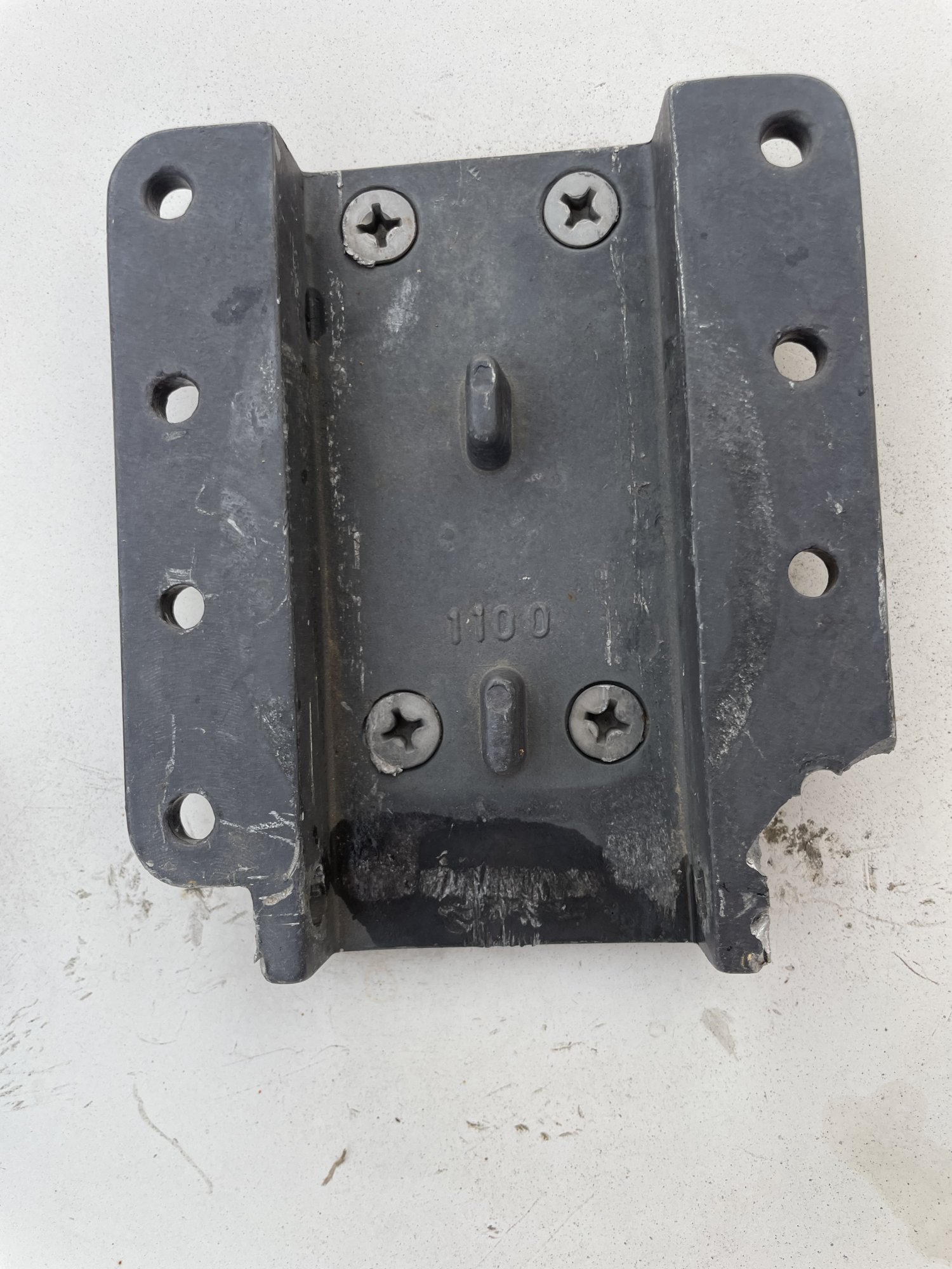

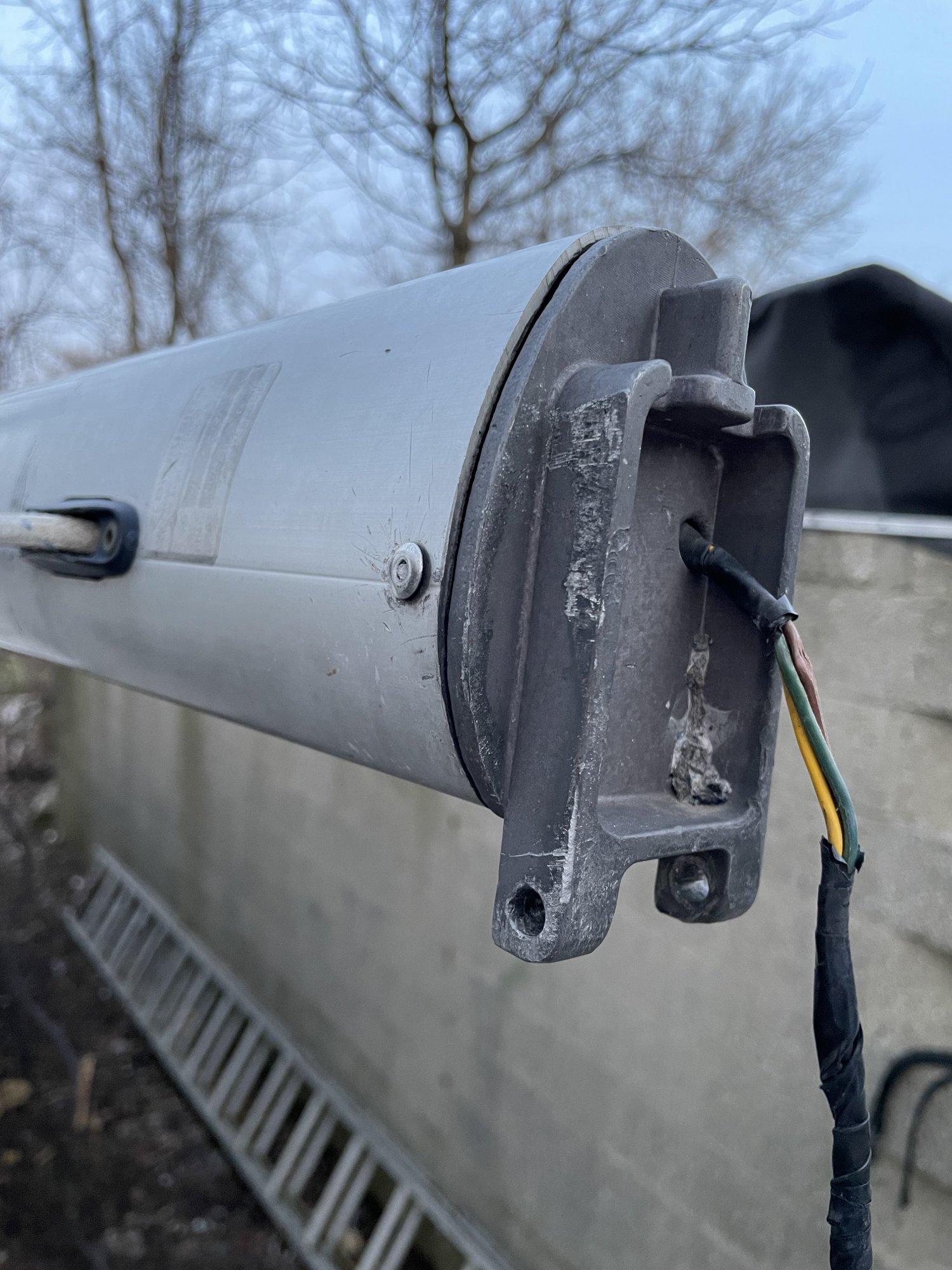

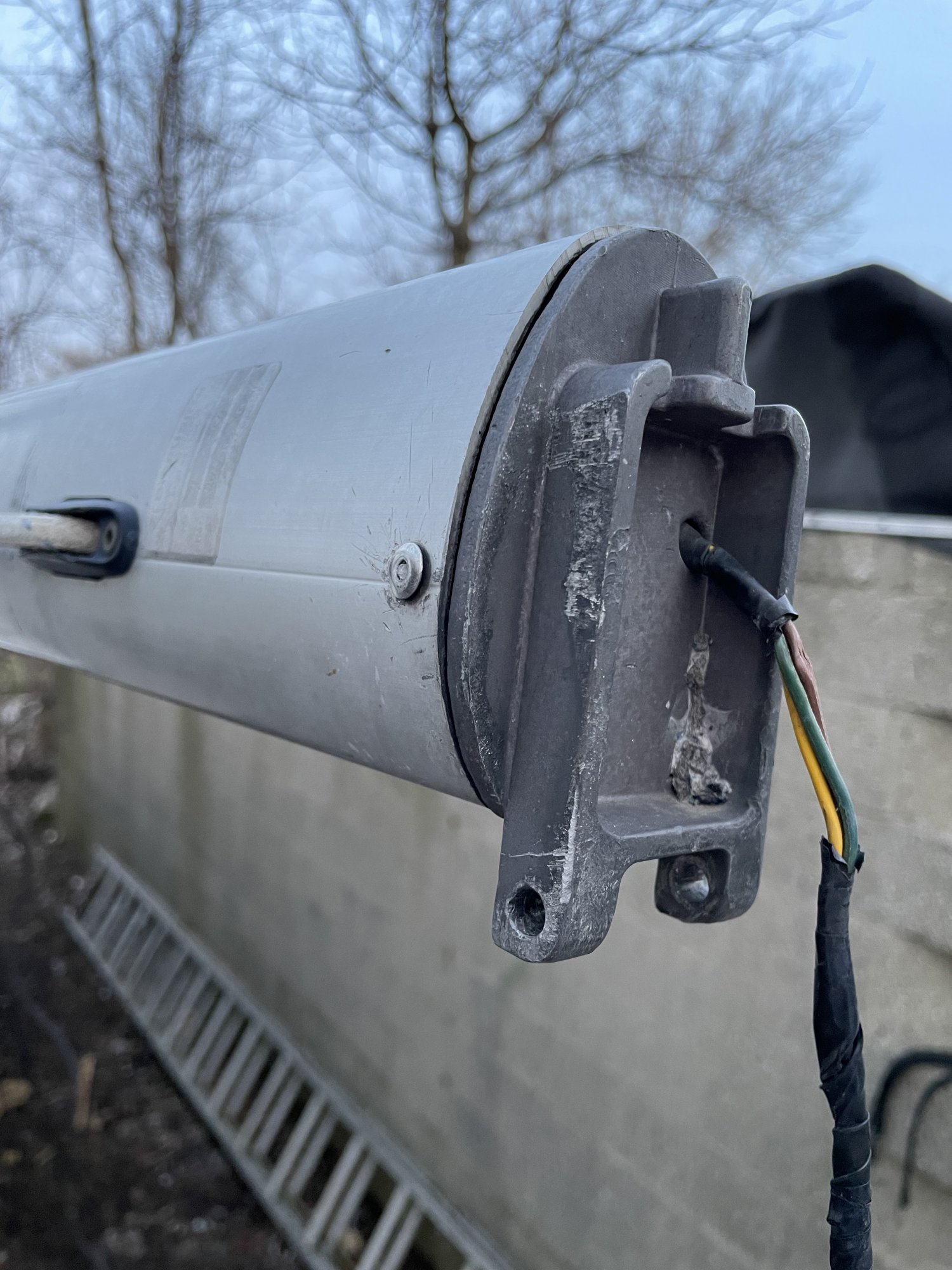

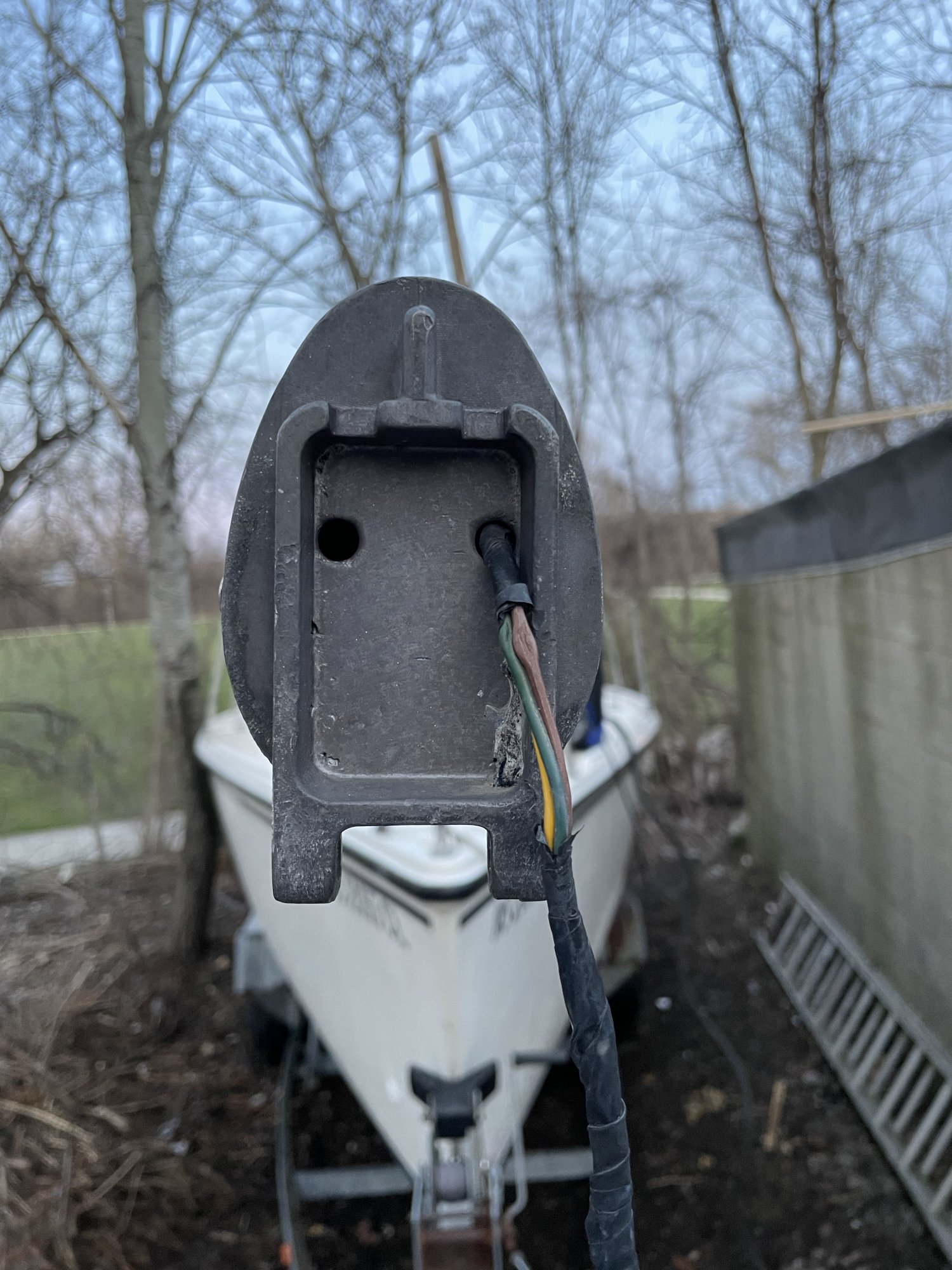

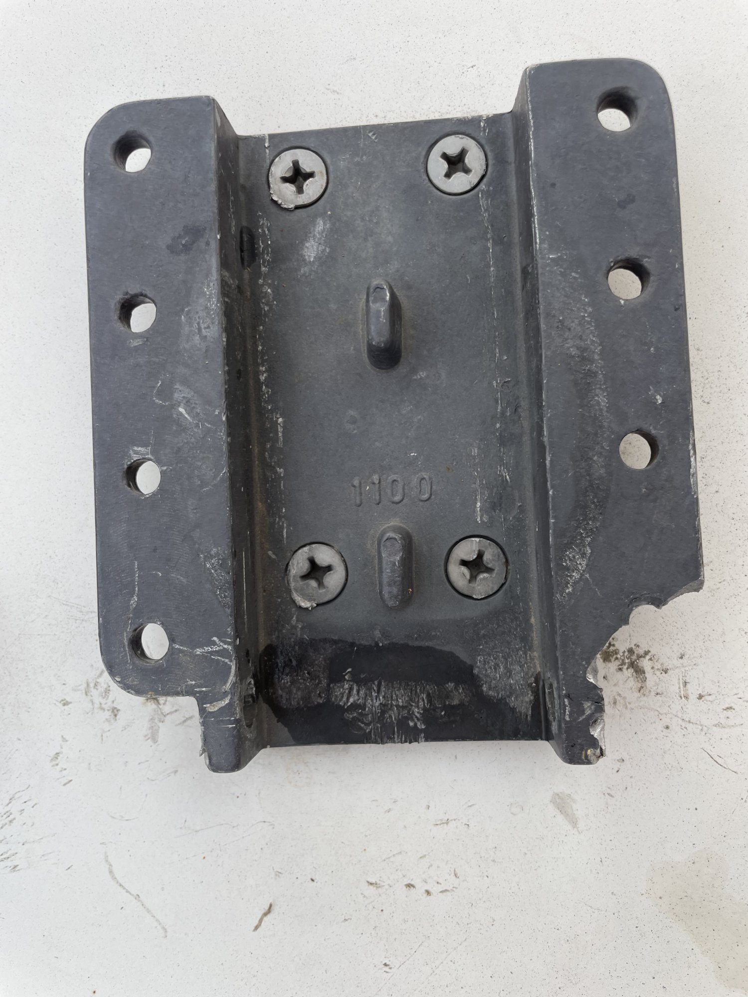

I am having this exact issue with my Hunter 23.. wondering if I should install a mast step plate with attachment points centered for the vang, or should I install a mast bail with a thru-bolt?
I stupidly attached the vang to the existing aluminum mase base plate that only has holes on the side off-centered ... didn't loosen it enough before a jibe and it snapped off.
I dont want to put a point of failure into the bottom of my mast with a bail, but I also don't want to have to manufacture a part if I can avoid it.
I appreciate any insight!
10,536
-na -NA Anywhere USA
@lakesurfsailor
can you take a photo of the existing mast foot and mast plate/step at the rear. Do you see any identification mfg. sticker on the boom or mast
The hunter 23 new came with a boom vang
Apr 11, 2023
18
Hunter 23 Lake Michigan
@lakesurfsailor
The Hunter 23 new came with a boom vang

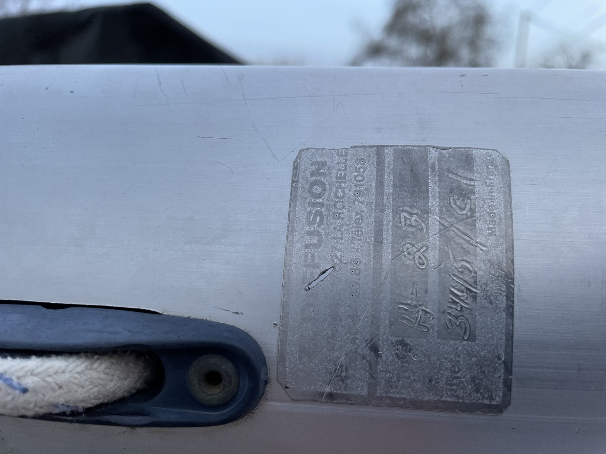

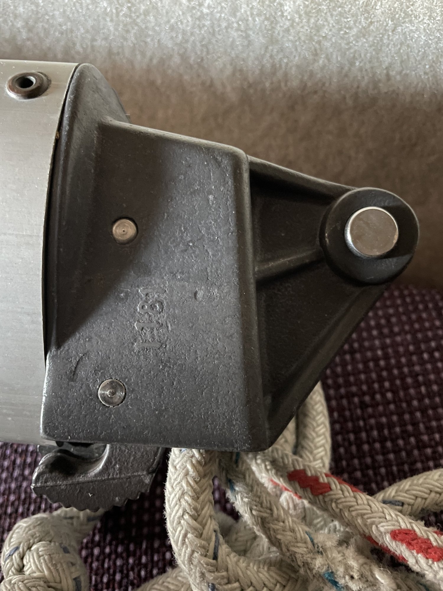

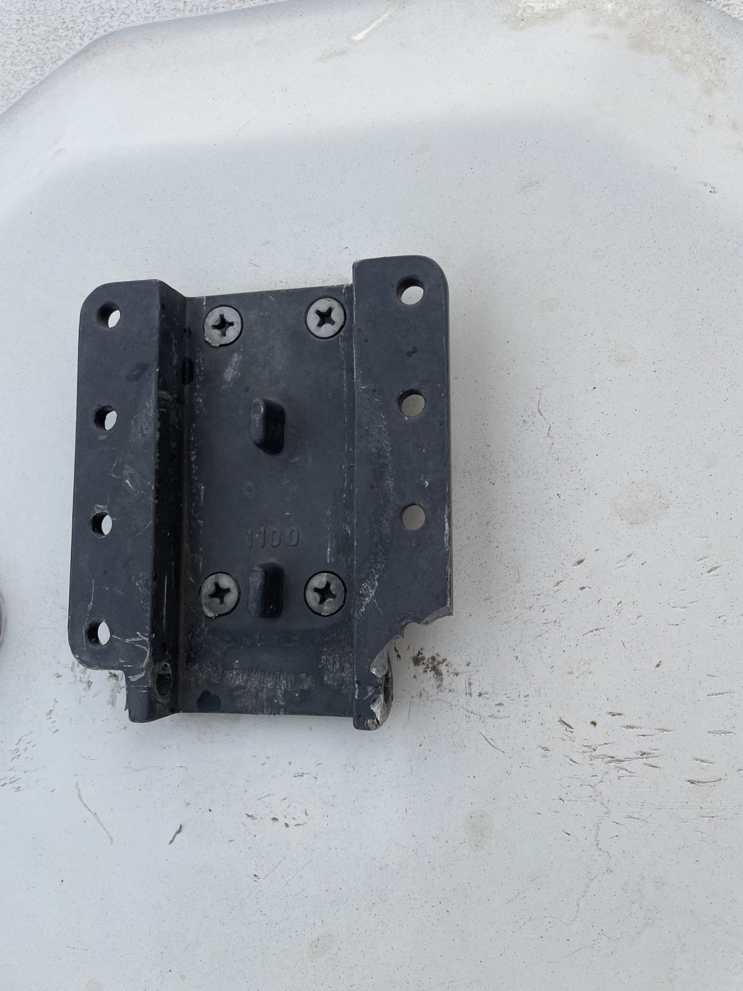

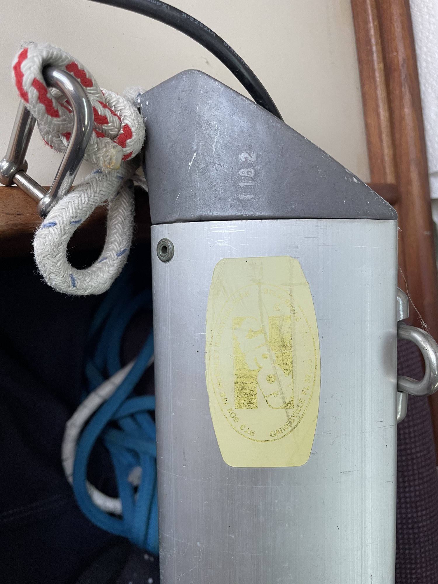

Thanks for the reply Dave, my vang is seemingly aftermarket and looks like a schafer or west marine cheapo mini Vang. I have attached some photos of the mast which appears to be la rochelle and the boom which appears to be a Kenyon.
p.s. I plan to replace the in-mast wiring to the mast light which looks janky in the photos.
I sincerely appreciate the advice!
-Adam
10,536

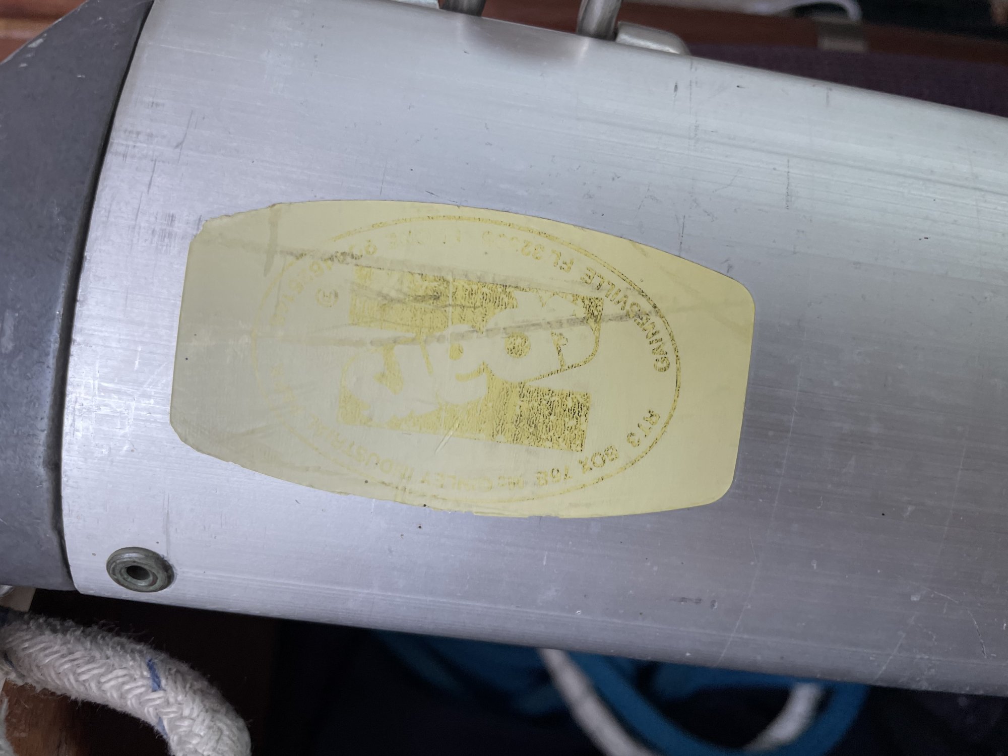

The mast is a Z Spar mast based on two photos, the mast step attached to the deck and the manufacture ID plate attached to the mast as Z Diffusion. I would suggest talking to the forum store and say Crazy Dave as advised a new mast step, retaining pin and bottom strap that is held by that retaining pin designed to attach the bottom of the Vang. On the bottom of the mast step you will find a model number
I need to know which boom you have. There should be a mfg. sticker on it. Photos of the sticker and boom. Make sure you post a photo of the lower part of the boom so I can see if there’s an attachment for the boom vang on the bottom of the boom.
Do nothing until you respond back.
ZSpar is now represented by U S Spars and contact there is Dave in Sales. Located near Gainesville FL.
  • Helpful

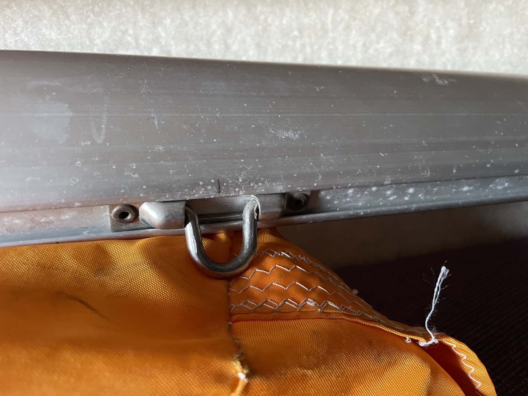

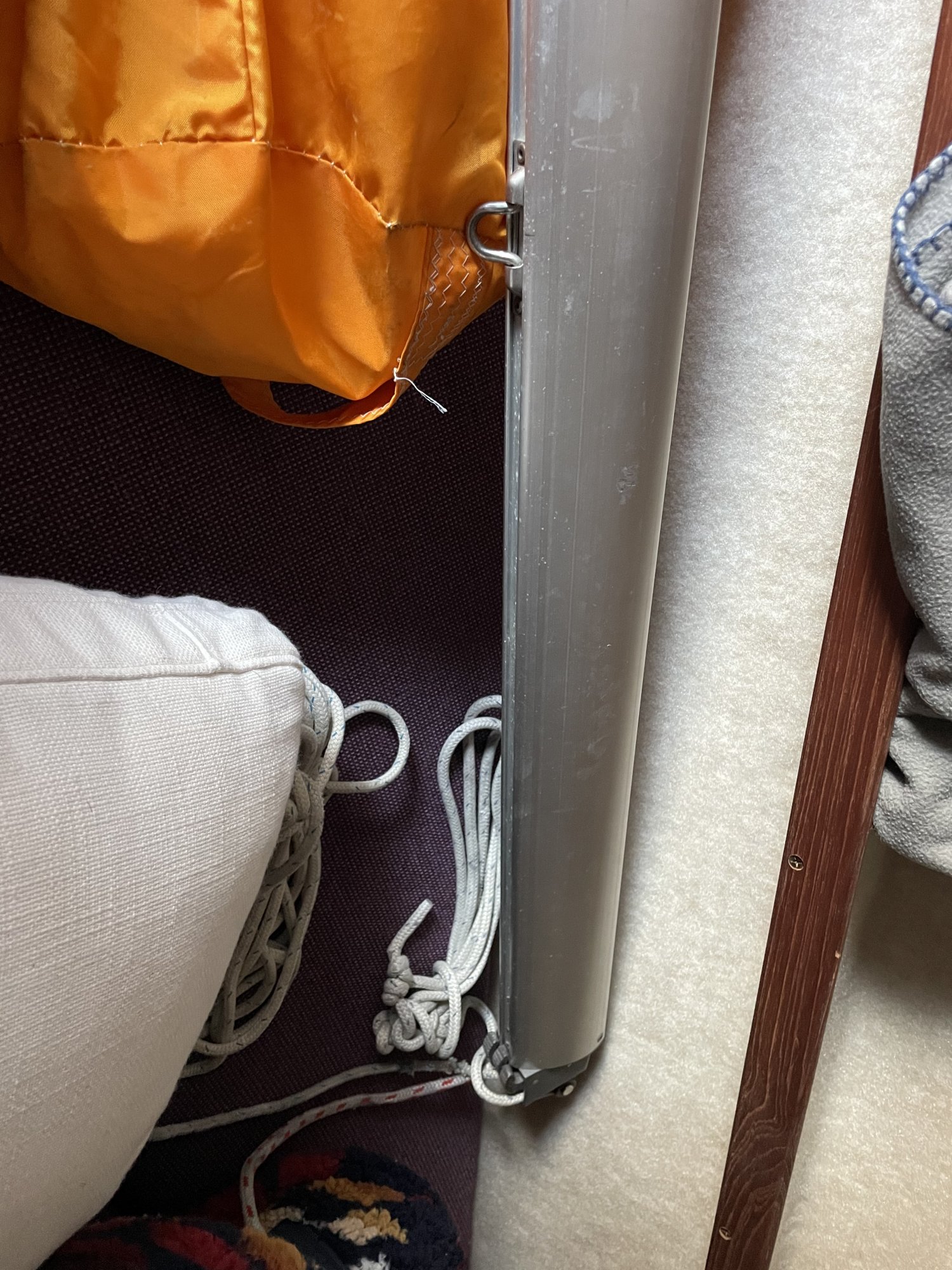

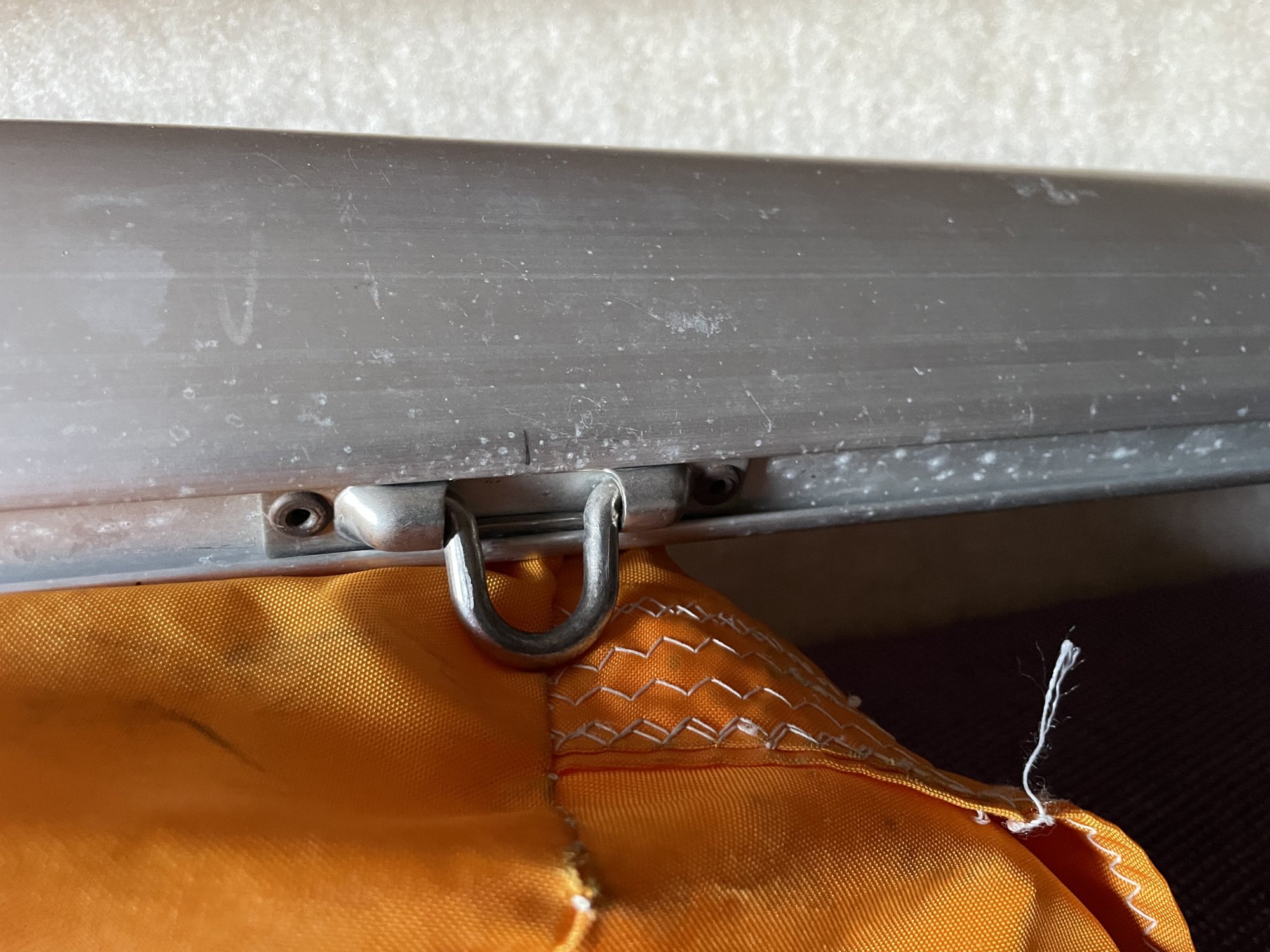

Thanks for that info Dave! Here are some photos of the boom. It does look to be a Zspar boom.
Are you saying there is a strap that can attach to the pin and that will take the load of the vang?
10,536
Picture show the boom is Z spar. View 4 shows an eye for attachmentl Are there two of them one for the boom vang and the other for the mainsheet
