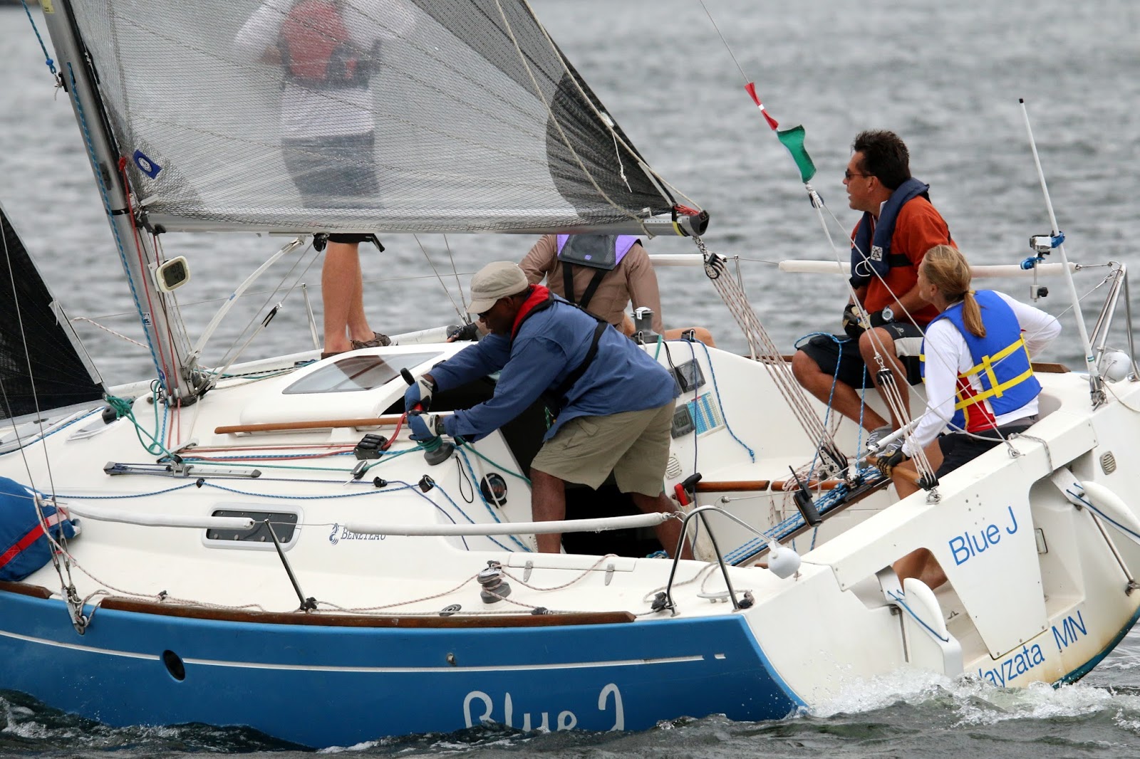

Here's what I mean about the 2x vang.
A standard 4:1 vang is detached from the boom and attached to a length of dyneema and starts at the mast base and runs through a good sized block on the boom where the vang was attached and down to the vang. That doubles the power of the vang to 8:1. Like in this picture. With boomkicker. Vang control terminates in an extreme angle fair lead on a harken camcleat.

Thanks again Jackdaw. Cool picture btw!

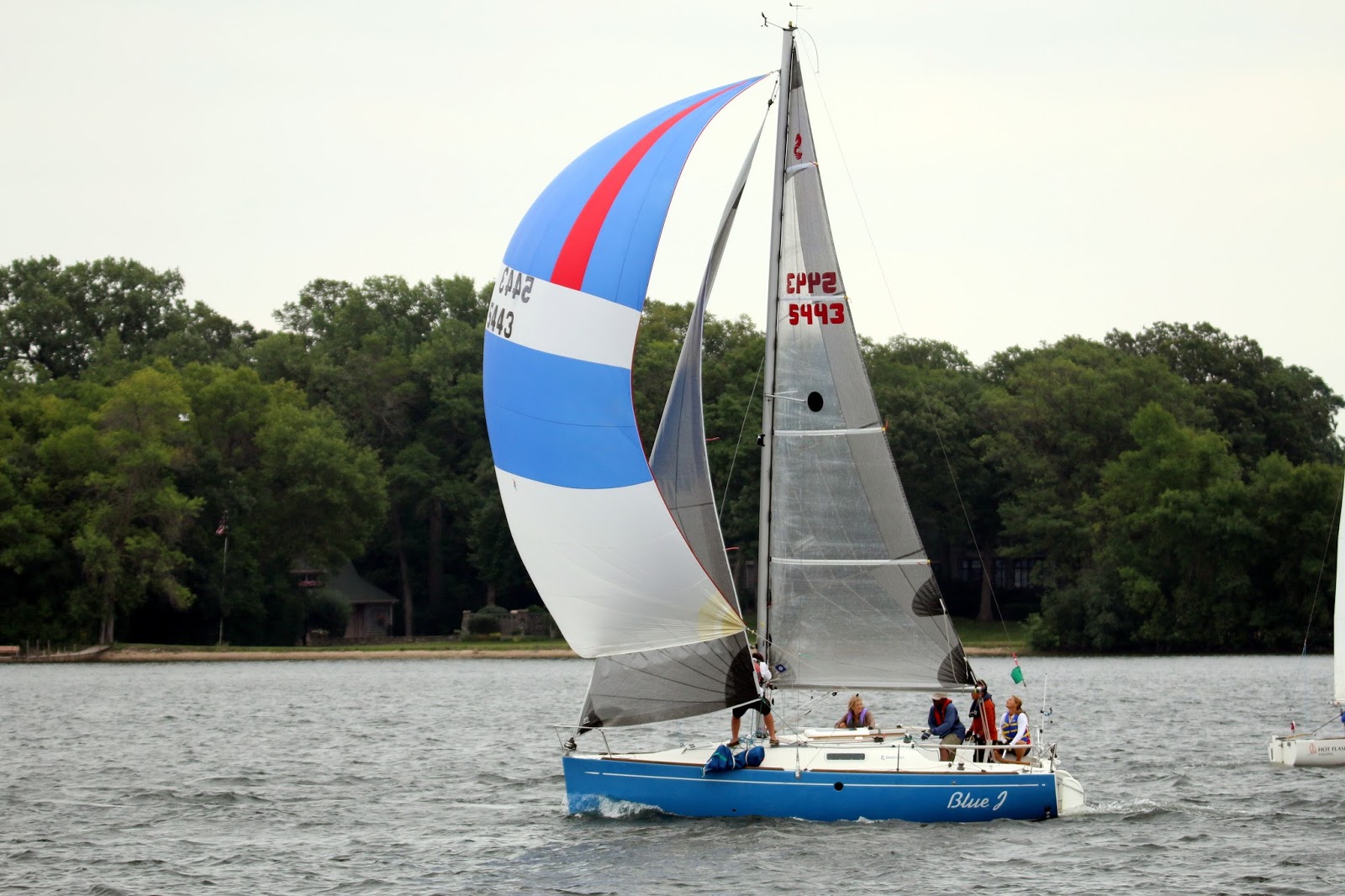

Thanks. Here's what I mean about vang control downwind.
In this picture we're going downwind in 20 knots, the main is out and for max performance the boom is level with the waterline. Like this the main is VERY POWERFUL, and a good puff can overload the main and force the boat to round up; a very nasty thing in particular with a kite up. Blowing the vang adds huge twist to the main and lets the excess pressure spill over the top of the sail. In this mode our pit-person (3rd from the transom) has the vang control in his hands at all times. With the extreme angle fairlead on the camcleat he can do this while sitting on the windward rail!

Plus, dumping the vang gets the boom out of the water when broached.
Just blowing the mainsheet does nothing as the water pushes the end of the boom aft.

Have you had failures using rope clutches or do you like cam cleats for faster cleating/uncleating? I was going to ask you why not a rope clutch but I understand now from your last picture.

To be clear, clutches in general will have much more holding power than a camcleat, and last longer without service. But the huge disadvantage them in this application is that you have to touch it to let line out, and that particular action takes quite a bit of time. A camcleat however can be released very quickly and while sitting quite away from it. That's why I recommend them for vangs. On our boats that vang can be blown from anywhere in the cockpit.
