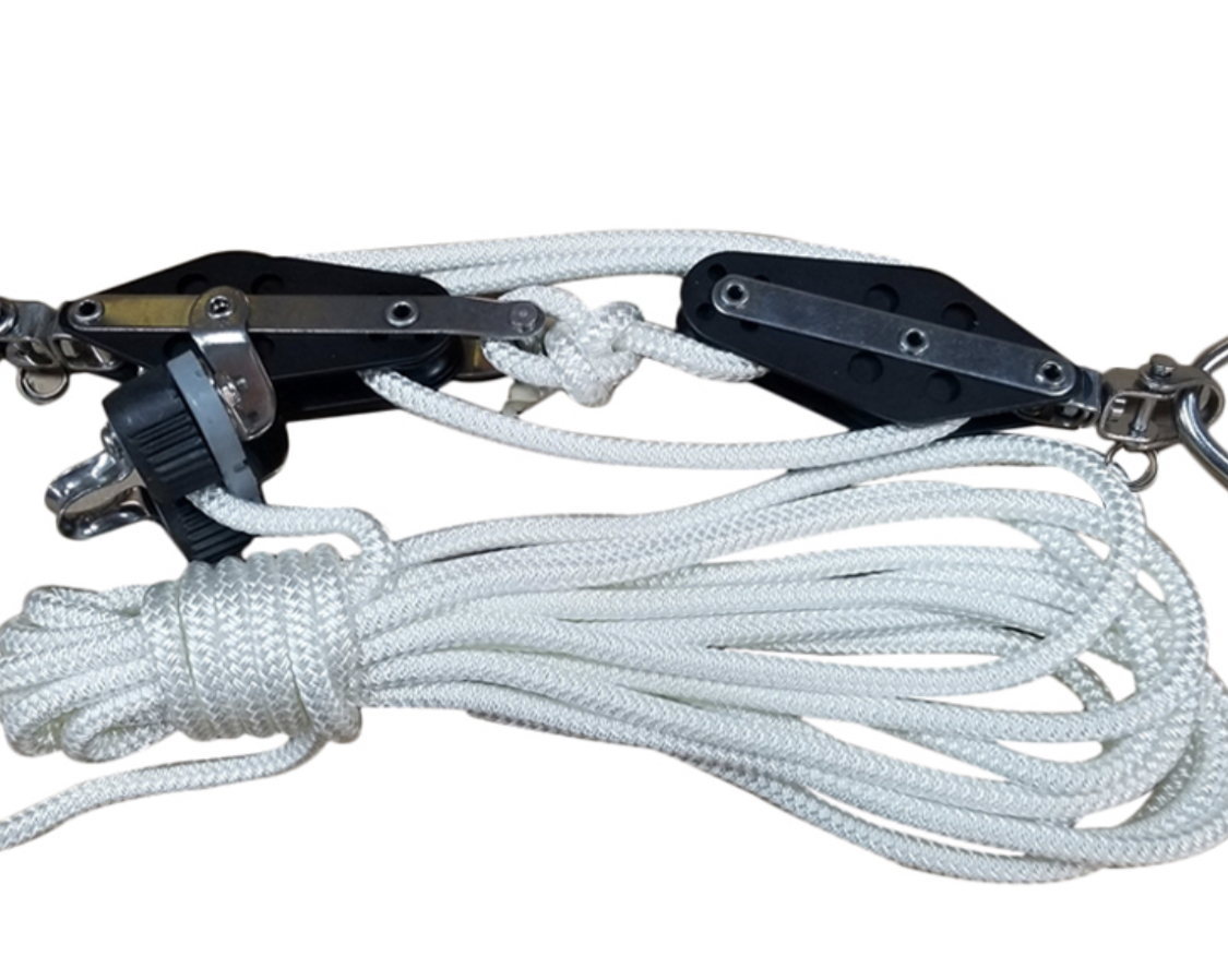

My question is which block do you put nearest to the boom?
I have the controlling block (someone feel free to help me with the nautical terms) at the boom. The problem with this setup is that you have to go forward of the attachment point in order to adjust the Vang.
I originally thought it went the other way, but then, I couldn’t get the line to catch with the hatch closed. I’m shopping for a new Vang that would be similar to the main sheet controls, but thought, maybe I just don’t know how to use this one correctly or have it installed wrong.

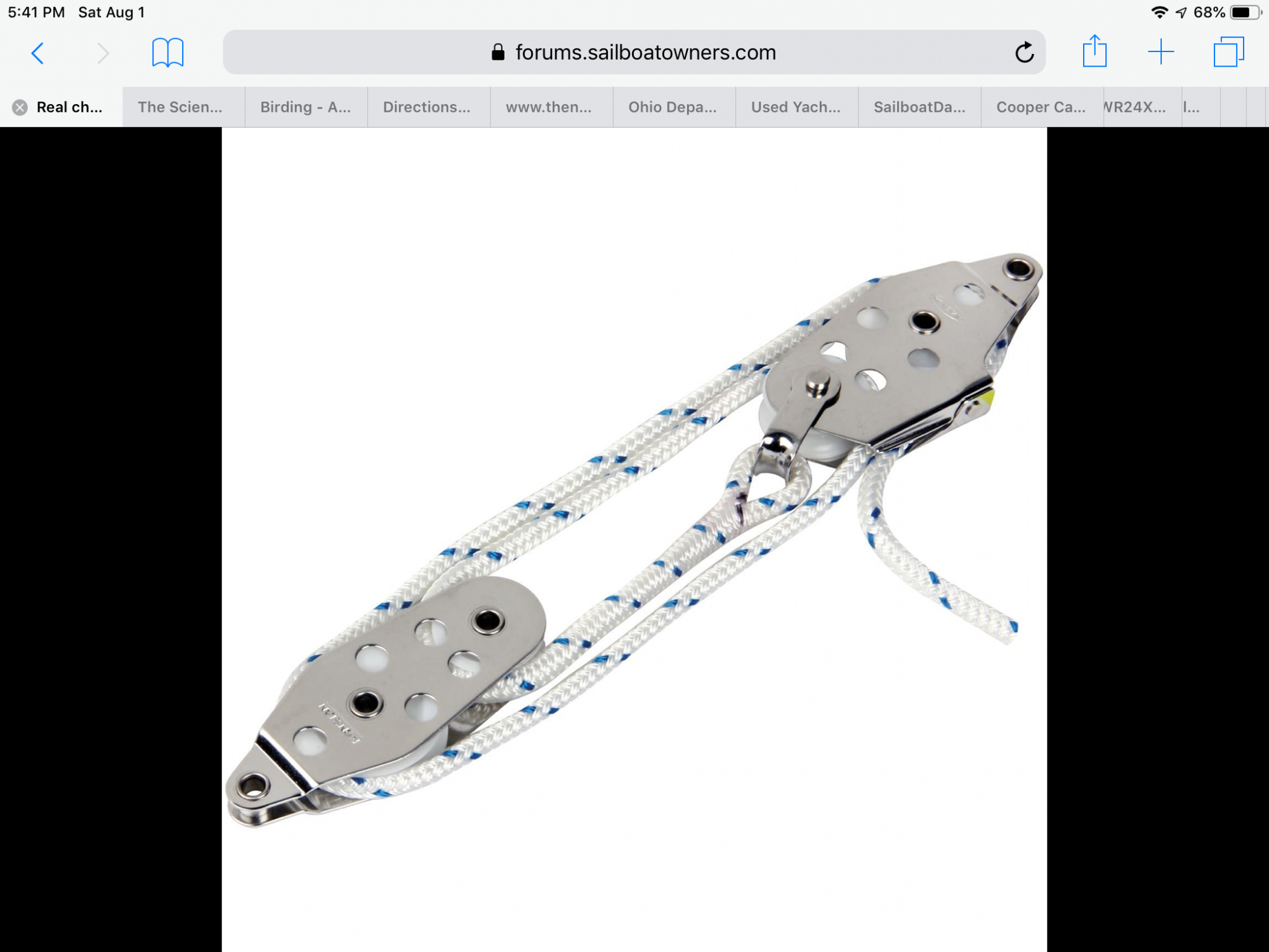

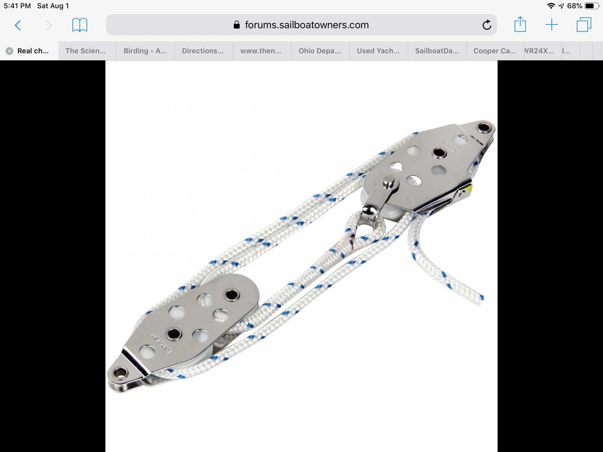

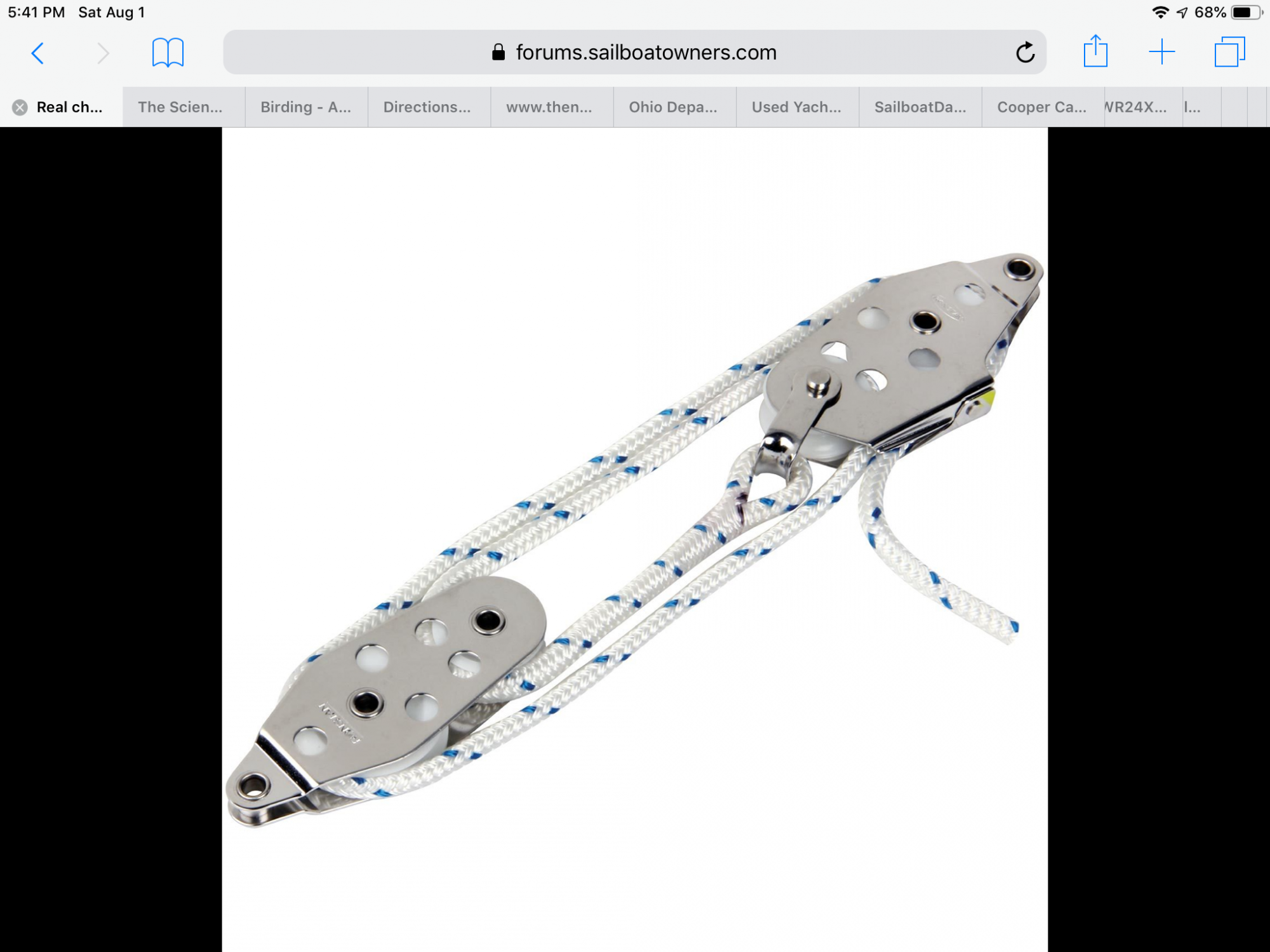

Maybe something like this with a different type of cleating mechanism.
Joe
Jun 1, 2004
8,342
You don't need to spend any money. That vang with the cam cleat pictured above is expensive and will probably have the same problem I'm going to mention in this thread....
Just turn the vang around and install it with the vee cleat on the forward lower side. You should be able to control the vang from the cockpit that way.... but hold on...here's the problem I hinted at earlier... sometimes there's not enough room to set the line in the cleat because it's too close to the deck... You try to snap the line down and you can't get enough angle for the cleat to bite. Simple solution for that..... attach a foot long pendant between the mast connection and the vang. That'll pull the control end up off the deck so you'll have plenty of operating room. You can make the pendant out of some spare line... or go over to west marine and use their workbench in the hardware department to make a wire pendant with nicro pressed loops on each end.
